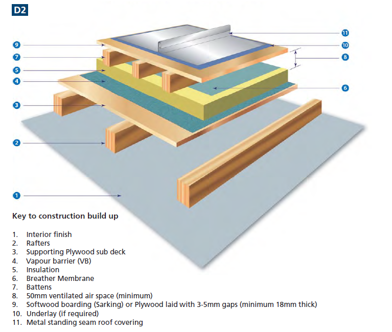

Mulberry View Posted June 17 Share Posted June 17 My Architect specified 120mm PIR insulation for our Warm Roof (Standing Seam VM Zinc). I want to beef the insulation levels up to 200mm. I cannot rely on my Architect for support here. I have a small (10sqm roughly) section of flat roof as part of the scheme where I cannot accommodate 200mm so I need a way to achieve an acceptable u-value compared to the 200mm on the rest of the scheme, but in a thinner build-up (the thinner the better). Any suggestions of ways I can do this would be greatly appreciated. Someone suggested 'Superquilt' as the VCL? I'm poor at understanding u-values, so would appreciate some guidance on this. Link to comment Share on other sites More sharing options...

Mr Blobby Posted June 17 Share Posted June 17 You need to talk to your zinc roof installers to agree the roof buildup. The federation of traditional metal roofing contractors has a guide, so warm roof is like this: As others have said, you can put some rockwool between the rafters to increase insulation. That's what I would do beacuse it would reduce noise but as others have said this becomes a hybrid roof and then you need to be sure of your condensation analysis. We were in your position last year and we decided to scrap the warm roof and then go cold ventilated roof (with warm loft space) so we could put more insulation between the rafters and then pir under that. We changed the ply for sarking board, and that was a good idea. No need to worry about it getting wet during construction and cost is not too much more. Link to comment Share on other sites More sharing options...
Mulberry View Posted June 17 Author Share Posted June 17 9 hours ago, Mr Blobby said: You need to talk to your zinc roof installers to agree the roof buildup. The federation of traditional metal roofing contractors has a guide, so warm roof is like this: As others have said, you can put some rockwool between the rafters to increase insulation. That's what I would do beacuse it would reduce noise but as others have said this becomes a hybrid roof and then you need to be sure of your condensation analysis. We were in your position last year and we decided to scrap the warm roof and then go cold ventilated roof (with warm loft space) so we could put more insulation between the rafters and then pir under that. We changed the ply for sarking board, and that was a good idea. No need to worry about it getting wet during construction and cost is not too much more. The Zinc contractor has agreed a build up for the 2 roof areas that he is applying Zinc to. This is a third 'flat roof' section that will not be Zinc'd, but is partly implicated in the main roof, so it's hard to tell if its even his problem. I don't think we can do anything but a warm roof with our design, but the rain noise is a bit of a worry. Is there a better material that could be used perhaps under or over the PIR layer to dampen the noise? Link to comment Share on other sites More sharing options...
