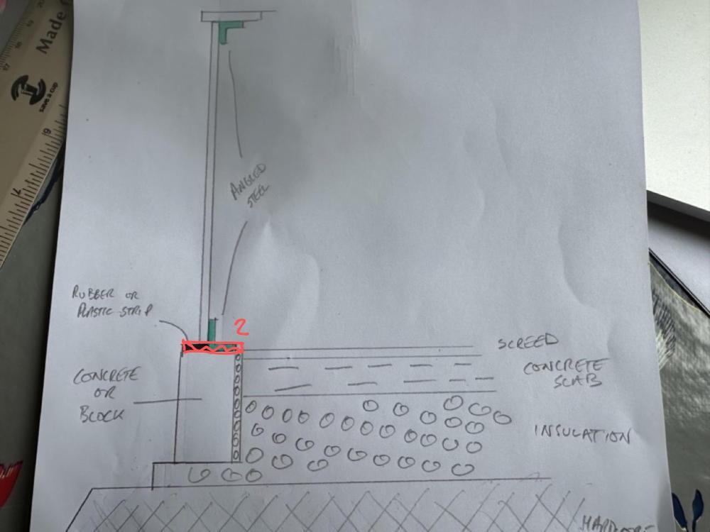

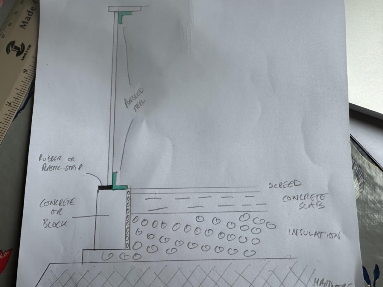

Nooie Posted June 14, 2024 Author Posted June 14, 2024 JohnMo, thanks for the reply. Any chance you could scribble a sketch of what you mean? I'm not a builder so having a bit of a struggle with the windows. I'm happy enough to do all the wood working and concrete, but thermal bridging and all that is new to me. "Your area at the bottom of the window is a big cold bridge. You need to look at a continuous insulation line. So at the bottom I would add a layer of Compacfoam and bring in the meet the floor upstand (would make this at least 50mm thick). This will have enough strength to take the loads and remove the cold bridge. Position in the wall depth will depend on how your walls are insulated the window needs to straddle the insulation."
JohnMo Posted June 14, 2024 Posted June 14, 2024 32 minutes ago, Nooie said: JohnMo, thanks for the reply. Any chance you could scribble a sketch of what you mean? I'm not a builder so having a bit of a struggle with the windows. I'm happy enough to do all the wood working and concrete, but thermal bridging and all that is new to me. "Your area at the bottom of the window is a big cold bridge. You need to look at a continuous insulation line. So at the bottom I would add a layer of Compacfoam and bring in the meet the floor upstand (would make this at least 50mm thick). This will have enough strength to take the loads and remove the cold bridge. Position in the wall depth will depend on how your walls are insulated the window needs to straddle the insulation." Couple of markups 1 this is a cold bridge, basically heat can find a way to cold as there is missing insulation. 2 adding Compacfoam will remove cold bridge. As there is now not a uninsulated pathway from warm to cold. Compacfoam is also able to hold structurally. 3. Your upstand unless quite thick is now a weak area heat will go down to the ground and outwards to atmosphere also. Upstand I'd around 50mm or more.

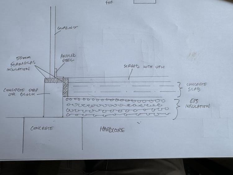

Nooie Posted June 17, 2024 Author Posted June 17, 2024 (edited) Hello again, does this look more like it? I’ve looked at Foamglas Perinsul HL, which according to their site says it can withstand the load of a 3 story house on top of it. Hopefully fine for a large sheet of glass. Edited June 17, 2024 by Nooie Rotating photo
JohnMo Posted June 17, 2024 Posted June 17, 2024 2 hours ago, Nooie said: Hello again, does this look more like it? I’ve looked at Foamglas Perinsul HL, which according to their site says it can withstand the load of a 3 story house on top of it. Hopefully fine for a large sheet of glass. Thermal bridge wide looks good. Upstand, can be PIR to save money and get as good or better performance. Don't like the angle steel on glass 1

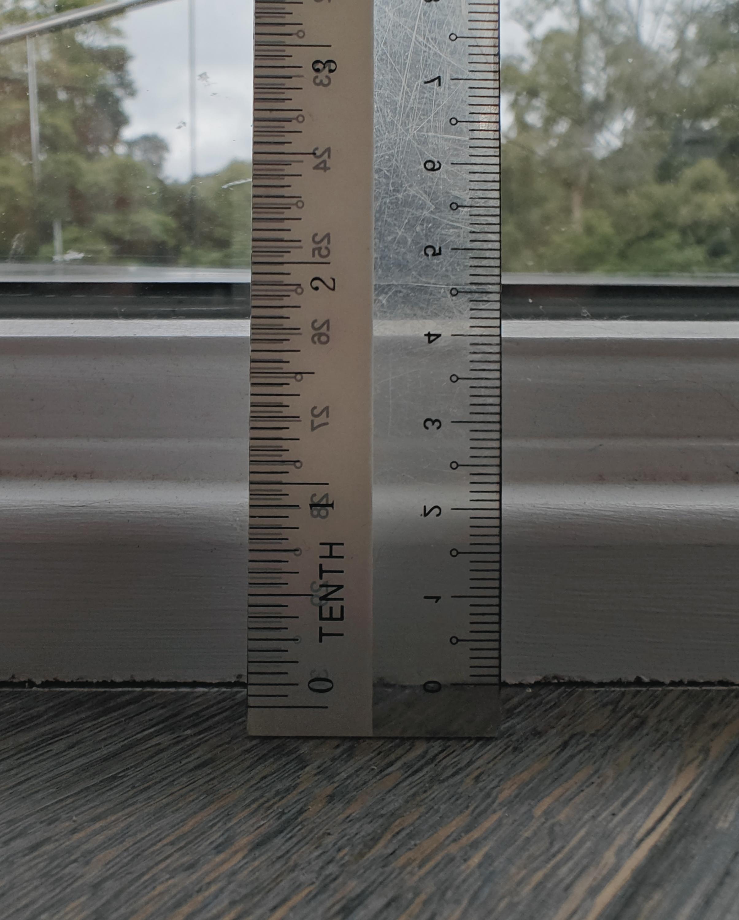

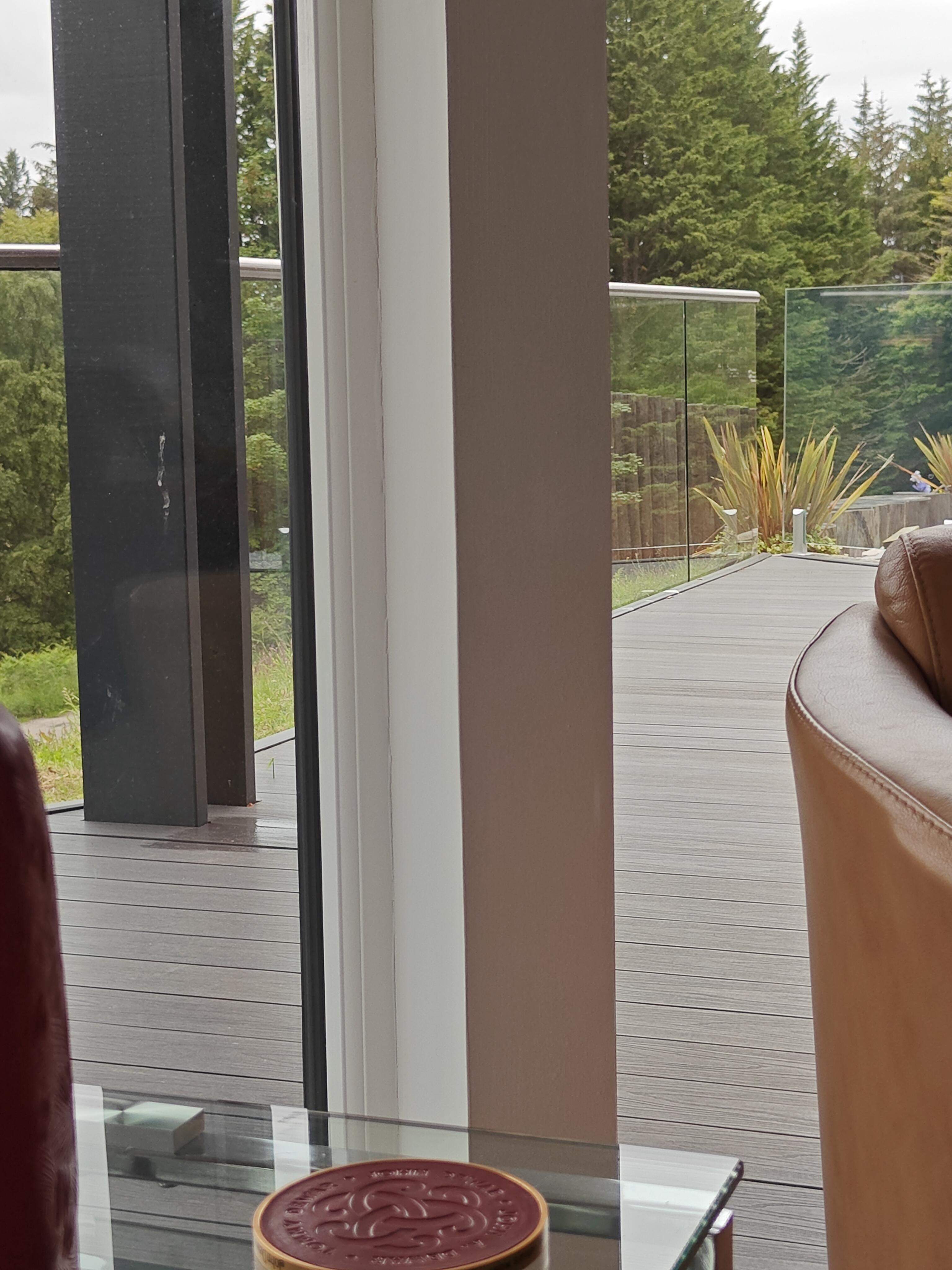

JohnMo Posted June 17, 2024 Posted June 17, 2024 43 minutes ago, Nooie said: Thanks John, we will probably put a timber cover over the angled steel to hide it. 🤙🏽 More to the point do you need or is it a good idea at all. It provides zero movement tolerance, which isn't good. For context My frame is sat at indoor ground level, we have oak flooring glued to screed, there is only 45mm of frame showing at the bottom. 2
