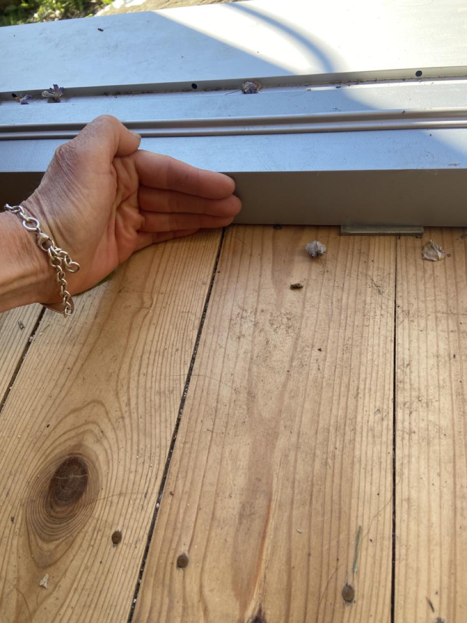

ClairedM Posted June 2, 2024 Share Posted June 2, 2024 Should the threshold of the doors be up this much? (Please see other thread and photos for context.) 1 Link to comment Share on other sites More sharing options...
nod Posted June 2, 2024 Share Posted June 2, 2024 It depends what you asked for Level threshold Or didn’t specify Link to comment Share on other sites More sharing options...
craig Posted June 2, 2024 Share Posted June 2, 2024 No and it should have been discussed with you prior to supplying the door, especially if they weren’t able to sit it further below the ffl, as better options exist. This is a conversation they should have had with you, it is their responsibility as the supplier. Link to comment Share on other sites More sharing options...
JamesP Posted June 2, 2024 Share Posted June 2, 2024 (edited) Did they supply you with drawings after they had measured up? I had vertical and horizontal section drawings. Edited June 2, 2024 by JamesP OK Link to comment Share on other sites More sharing options...
ClairedM Posted June 4, 2024 Author Share Posted June 4, 2024 On 02/06/2024 at 21:07, JamesP said: Did they supply you with drawings after they had measured up? I had vertical and horizontal section drawings. No thtey didn't./t Link to comment Share on other sites More sharing options...
