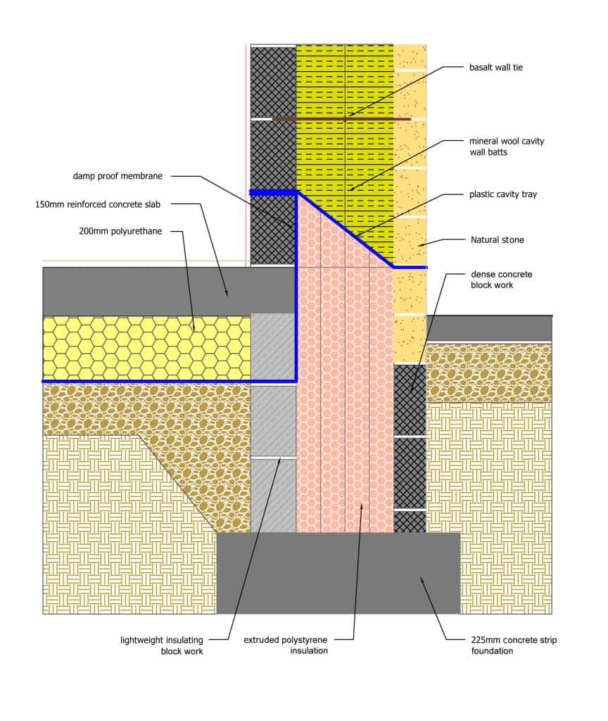

JohnMo Posted May 29 Share Posted May 29 7 hours ago, darren moran said: with a passive foundation or a passive raft foundation. You can just as easily design a standard strip foundation to be just efficient and can be completed by your local ground workers Link to comment Share on other sites More sharing options...
joe90 Posted May 30 Share Posted May 30 13 hours ago, JohnMo said: You can just as easily design a standard strip foundation to be just efficient and can be completed by your local ground workers Yes I did this, SE did design (completely over the top IMO,but my builder did strip for far less money and like this. Link to comment Share on other sites More sharing options...
JohnMo Posted May 30 Share Posted May 30 This was mine for ICF build (external insulation), I added a 70mm up-stand to the the screed edge also, not shown on the drawing Link to comment Share on other sites More sharing options...
