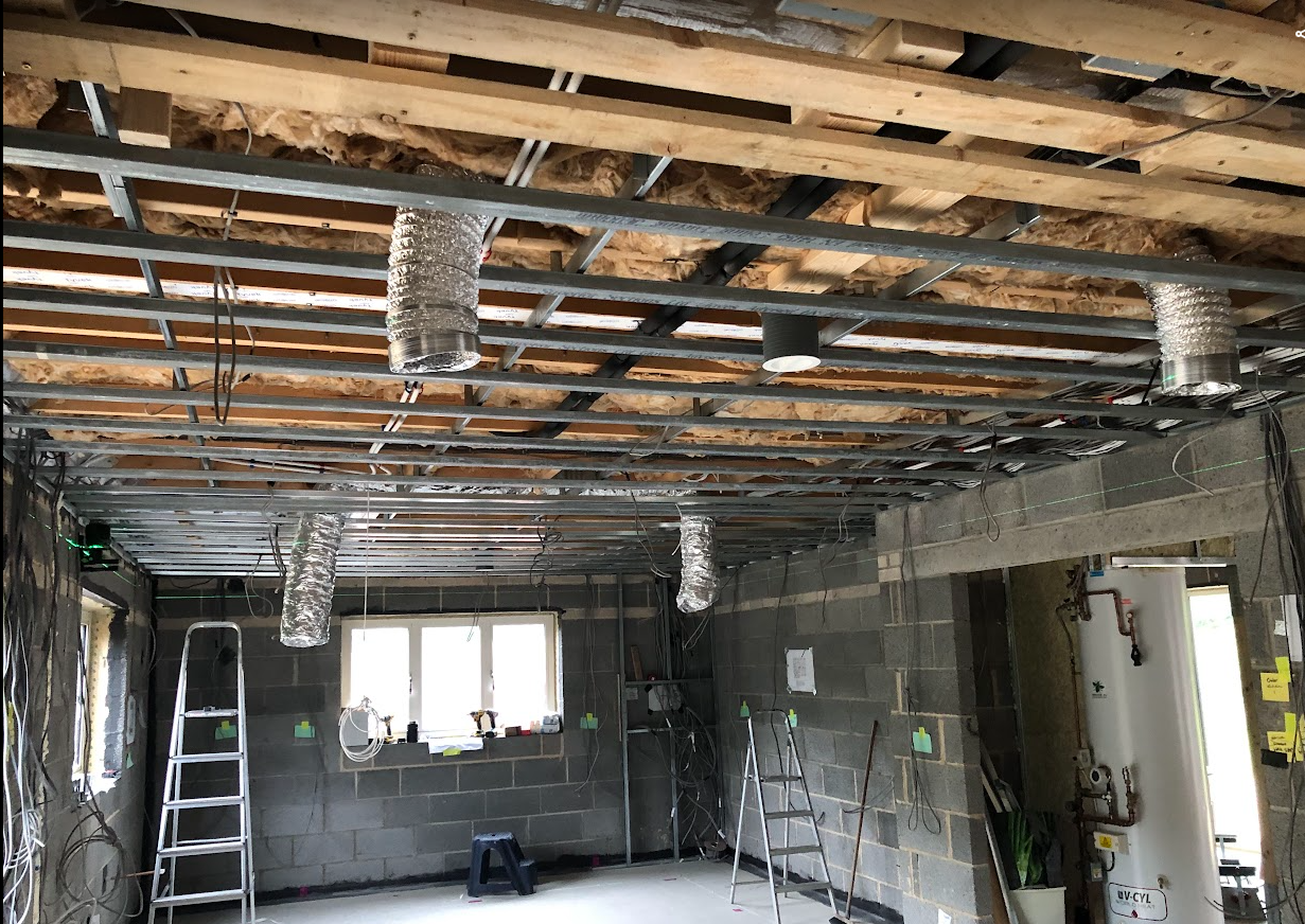

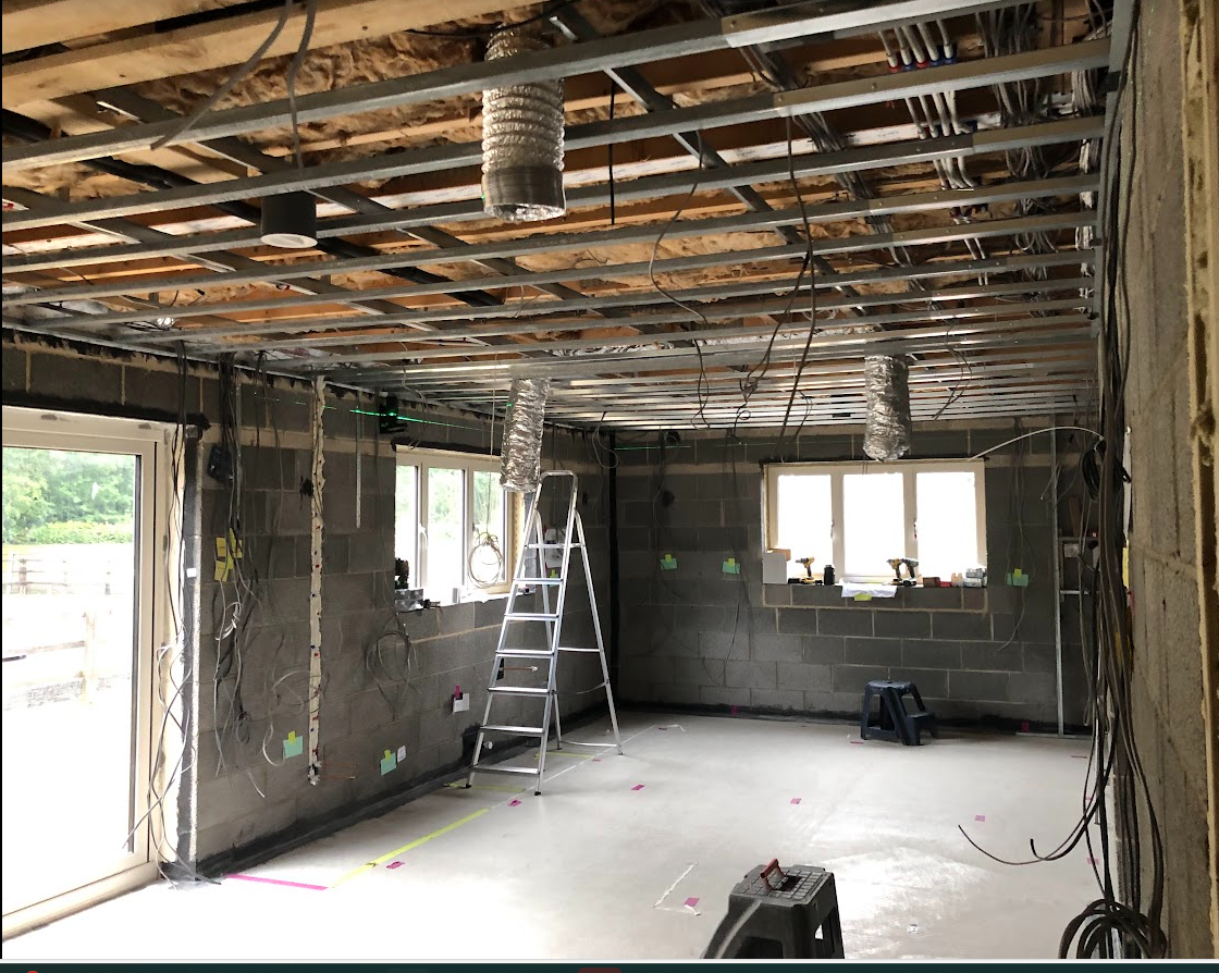

crispy_wafer Posted May 29, 2024 Posted May 29, 2024 Simple question I hope, What's the preferred onsite methods for cable drops when using mf ceiling? Cut the mf6 short and leave a gap?, Cut the top/bottom and just fold out the way? I can't really chase behind as the timber wall plate is just above the mf6. Then protect the cable in conduit as it passes over/between the metal, protect from the sharp edges?
nod Posted May 29, 2024 Posted May 29, 2024 Clip the top edge and bottom edged and fold in No sharp edged 1

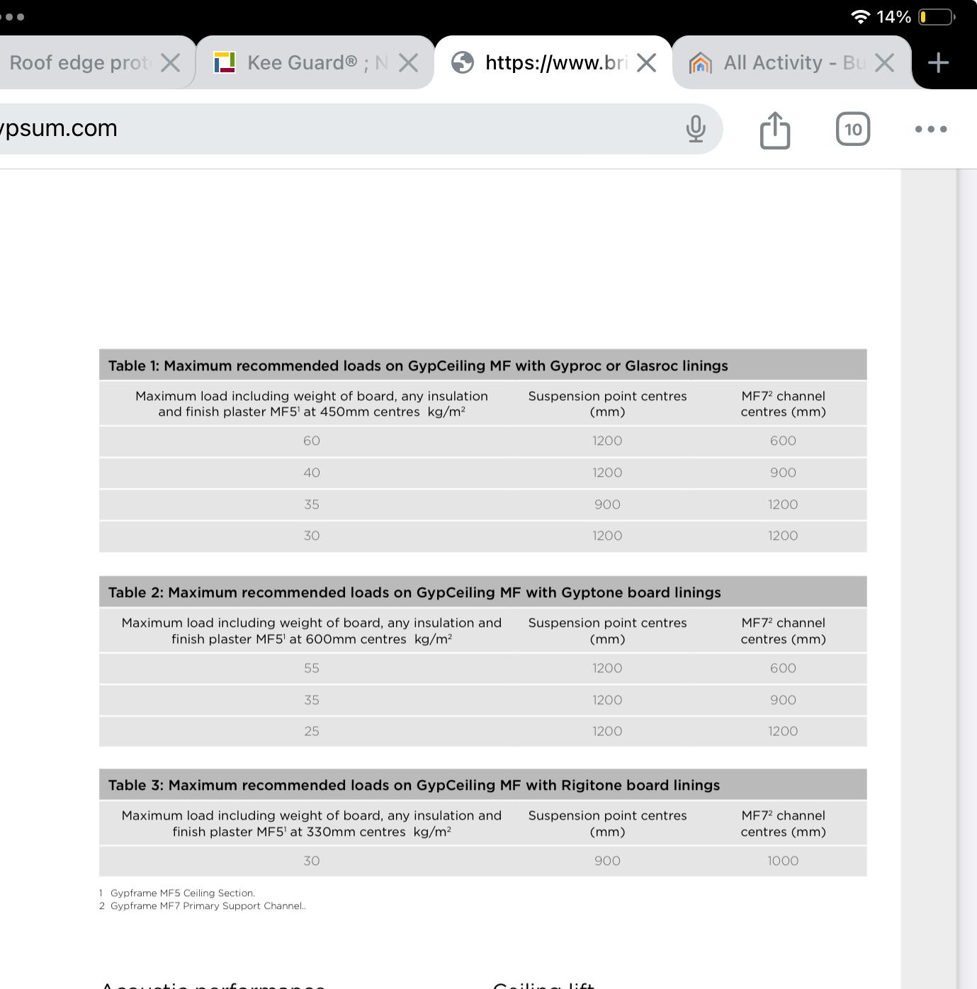

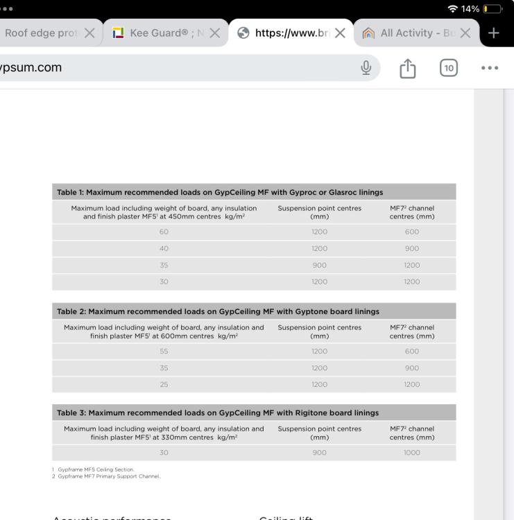

crispy_wafer Posted June 3, 2024 Author Posted June 3, 2024 @nod pretty please! Looking at a single layer of 15mm acoustic boards followed by skim, is 1200*1200 hangers/mf7 ok, or should i decrease the spacing. I’ll be fixing the boards @ 400’s as per.
nod Posted June 3, 2024 Posted June 3, 2024 Top hat always at 400 centres Double board or Sounblock over 12.5 Decrease hangers to 800s 1
nod Posted June 3, 2024 Posted June 3, 2024 26 minutes ago, nod said: Top hat always at 400 centres Double board or Sounblock over 12.5 Decrease hangers to 800s 👍
