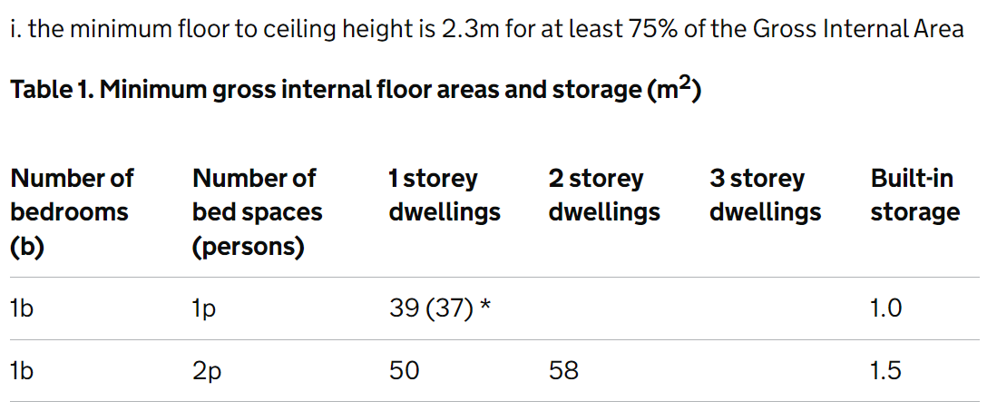

IanR Posted May 25 Share Posted May 25 14 hours ago, Leroy said: Does a property in “open countryside” have the same PD rights as a normal residential house on a street. Yes, no distinction is made between rural housing and urban housing within the PD rules for an occupied dwelling house. 14 hours ago, Leroy said: I’m thinking I would have to increase size slightly on the full app to make it liveable with a family then look to maximise PD rights retrospectively. But, for all housing, the LPA can restrict PD rights when approving a permission. ie. If they feel any further development would be over-development, they can place a condition that removes any further PD Rights. For info, Class Q does this automatically, if you convert under Class Q, all PD Rights (other than green PD) are removed from the completed building. That doesn't mean you can never extend, just that you are required to put in a planning app to do so. 14 hours ago, Leroy said: How far do you think you could push it could you put in 2 full apps getting slightly bigger each time with the previous one to fall back on or could they withdraw the previous granted permission? I don't believe that would achieve anything larger than a single application that sets out what you want and tries its best to justify your request. When you put in the second planning app the judgement will be based on the original building and will consider the development that has already occurred. 1 Link to comment Share on other sites More sharing options...
Leroy Posted May 25 Author Share Posted May 25 1 hour ago, IanR said: Yes, no distinction is made between rural housing and urban housing within the PD rules for an occupied dwelling house. Perfect good news. 1 hour ago, IanR said: But, for all housing, the LPA can restrict PD rights when approving a permission. ie. If they feel any further development would be over-development, they can place a condition that removes any further PD Rights. For info, Class Q does this automatically, if you convert under Class Q, all PD Rights (other than green PD) are removed from the completed building. That doesn't mean you can never extend, just that you are required to put in a planning app to do so. What’s Green PD? Is this quite likely do you think? All depends on the LPA I suppose I mean the houses that are either side of the field are fairly big and the one opposite is massive with a separate pool house and everything so I would be a bit put out if that was the case. 1 hour ago, IanR said: I don't believe that would achieve anything larger than a single application that sets out what you want and tries its best to justify your request. When you put in the second planning app the judgement will be based on the original building and will consider the development that has already occurred. Yeah that makes sense so they would compare any application to the original structure rather than a previous application. I suppose the thing to do would be to just build it as per the original full app and then if PD rights didn’t make it big enough to then put in another full app and hope for the best. In your experience if this was the case are you better of waiting say 5 years for another full app or if I was to go for it straight away would it make much difference? Just been looking through PD rights they seem way over complicated as well! Have you had much experience with them? I’m just wondering if they’re is anything that I should be considering on the full app with regards to the curtailage of the property, I suppose it would just be make it big enough for future potential extensions? Link to comment Share on other sites More sharing options...
