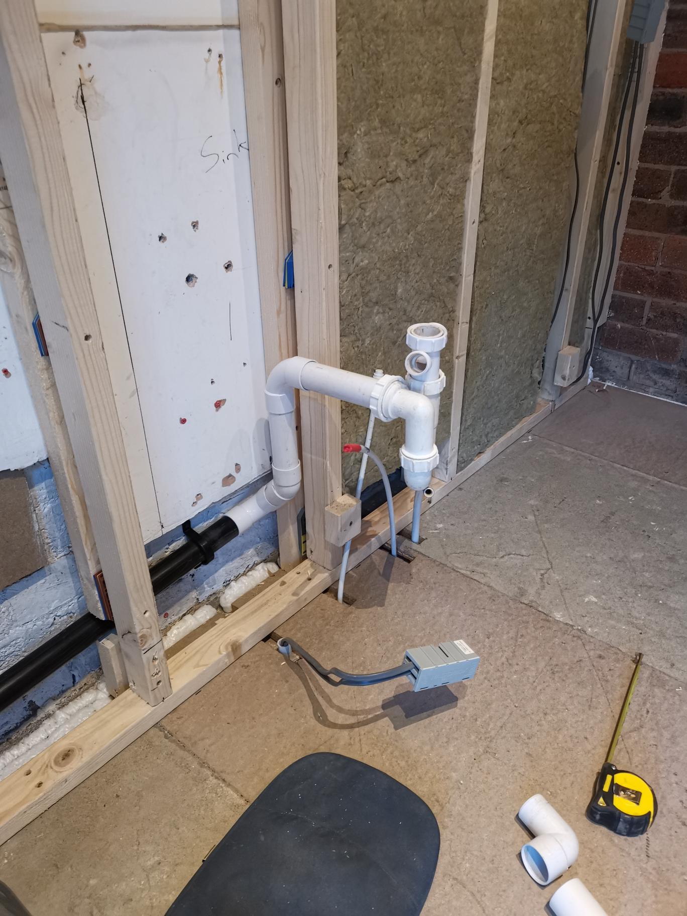

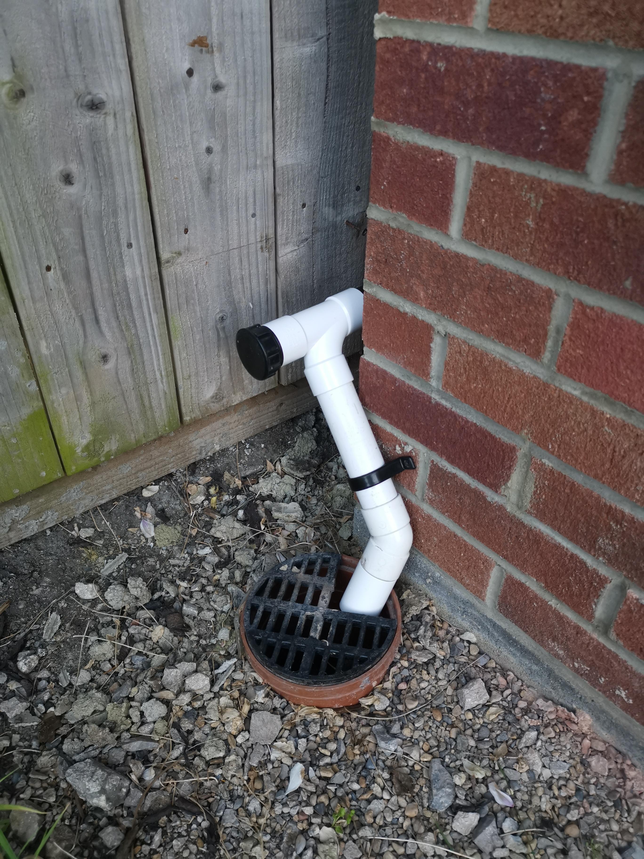

Super_Paulie Posted May 13, 2024 Posted May 13, 2024 Hi guys. Planning my kitchen waste with various bits I have hanging around. Is this my best option for a rodding access? That run along the side of the extension is 2m which is supported, but I'm thinking this rodding access will just collect kitchen waste and do the exact opposite of what I want, but I can't think of another way to do it? Obviously I'll get new fittings all the same colour.
Super_Paulie Posted May 13, 2024 Author Posted May 13, 2024 The thought has just dawned on me that I could just use a swept bend and just not weld it on one end, thus making it removable. Or is this frowned upon by the majority?
saveasteading Posted May 13, 2024 Posted May 13, 2024 That should work. If the end gets mucky inside, does it matter?
Super_Paulie Posted May 14, 2024 Author Posted May 14, 2024 10 hours ago, saveasteading said: That should work. If the end gets mucky inside, does it matter? i guess it wouldnt in the scheme of things, i guess it could collect so much crap that in time it blocks. Dunno, probably over thinking it.
Mr Punter Posted May 14, 2024 Posted May 14, 2024 I think you are better rodding in the direction of flow. If the pipe gets blocked, where will the rods push the blockage? Can you get an access where it exits the wall?
Super_Paulie Posted May 14, 2024 Author Posted May 14, 2024 2 hours ago, Mr Punter said: I think you are better rodding in the direction of flow. If the pipe gets blocked, where will the rods push the blockage? Can you get an access where it exits the wall? i have access but im not sure how to make an access point at it and not look a mess.
Conor Posted May 14, 2024 Posted May 14, 2024 No, you can rod downstream aswell with a pulling action with one of the flip scrapers.
saveasteading Posted May 14, 2024 Posted May 14, 2024 54 minutes ago, Super_Paulie said: how to make an access point Take off the U bend , and use a snake.
Super_Paulie Posted May 14, 2024 Author Posted May 14, 2024 18 minutes ago, saveasteading said: Take off the U bend , and use a snake. So just remove the rodding point outside altogether? I'd be happy if that'll work as it's much less of an eyesore.

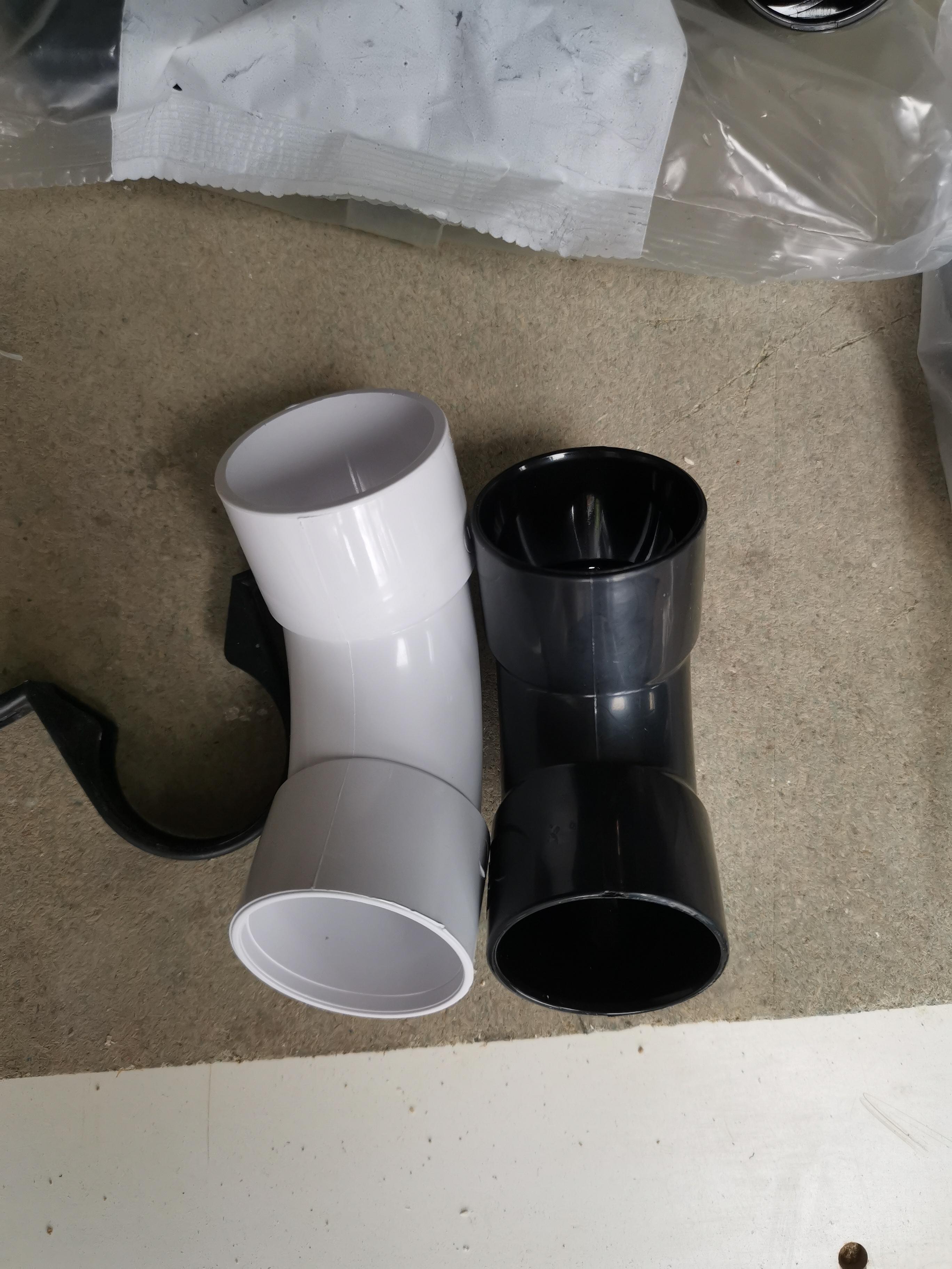

Super_Paulie Posted May 15, 2024 Author Posted May 15, 2024 Further to this, why the hell are the white swept bends bigger than the black? I've already cut the pipe now white I waited for them to come into store, proper seen me off 😤
