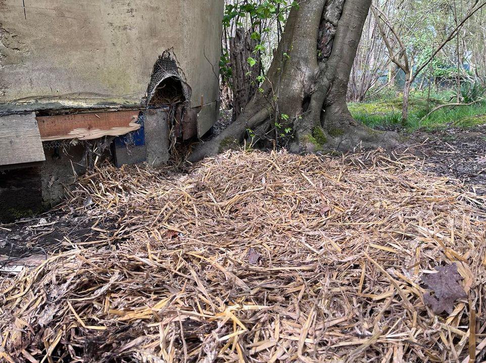

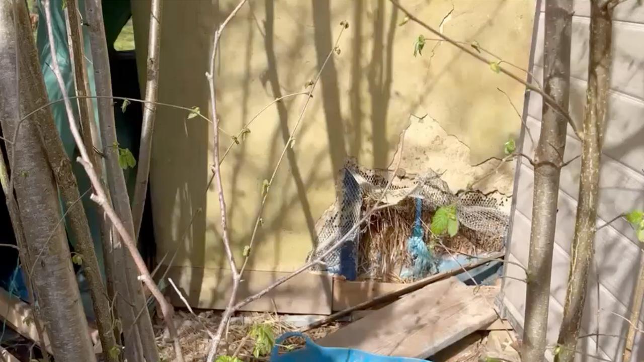

Mud Hut Learner Posted May 12, 2024 Share Posted May 12, 2024 Hi. We have a mud hut in Herts that has been used to hold community events/ workshops in for about 10 years. Recently I arrived to find holes made in the wall ( as seen in the photos ☹️). Does any one have advice on how best repair this damage? ( I am new to such building work. I tried using mud on the smaller hole, but not surprisingly it cracked when it dried ). Many thanks if you can help! Link to comment Share on other sites More sharing options...
joe90 Posted May 12, 2024 Share Posted May 12, 2024 Mud huts are adobe but this looks more like straw covered in rendered metal mesh? Link to comment Share on other sites More sharing options...
Mud Hut Learner Posted May 12, 2024 Author Share Posted May 12, 2024 Thanks for replying. Apologies, yes ( straw bales & metal mesh - as seen in photos ). Link to comment Share on other sites More sharing options...
Nick Thomas Posted May 12, 2024 Share Posted May 12, 2024 That's some intentional-looking damage . People rather than animals? I've seen one video where voids in a straw bale wall were filled in with expanding foam, but I don't know that it's wise. You'd want them filling with *something* though? Stuff straw in tightly, mesh over it again and then render over, perhaps? Is it lime render on the outside? If it feels like mud then it's probably actually a clay render, and you'd be quite lucky to have earth you dug from the ground next to the hut match it ^^. I've done a little bit of clay plastering onto straw, and it went on easily, but the detail escapes me right now. Poking at books, I found https://www.amazon.co.uk/Clay-Lime-Renders-Plasters-Paints/dp/0857842692 - I haven't read it, but will do so this week. I've got some lime rendering to do soon anyway. Link to comment Share on other sites More sharing options...
Redbeard Posted May 12, 2024 Share Posted May 12, 2024 (edited) Open up and hack out a bale. Of course it's not as easy as that, and you might have to resort to 'flakes' (the 'sections' which appear when you split a bale, but in order to carry render, even with the help of the mesh, it needs to be really firm. Don't know how it was built but even if it was not ratchet-strapped it has had the weight of a roof on it, so if you take out a (compressed) bale the replacement bale will be too tall. Experimentation is the order of the day (and yes, I have had to do it. The 'wrangling' may make a bit of a mess of your render... Assume you or your group have 'Building With Straw Bales' (in UK) by Barbara Jones? Not much on repair but a great 'primer'. https://strawbale.com/repairing-water-damaged-bales/ (not a UK site but looks OK the few words I read on repairs) Edited May 12, 2024 by Redbeard add'n'l info Link to comment Share on other sites More sharing options...
