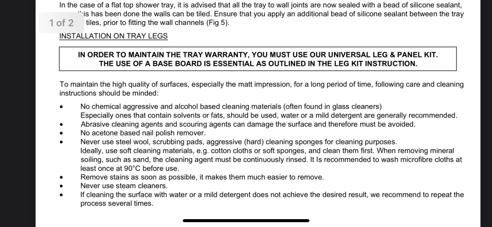

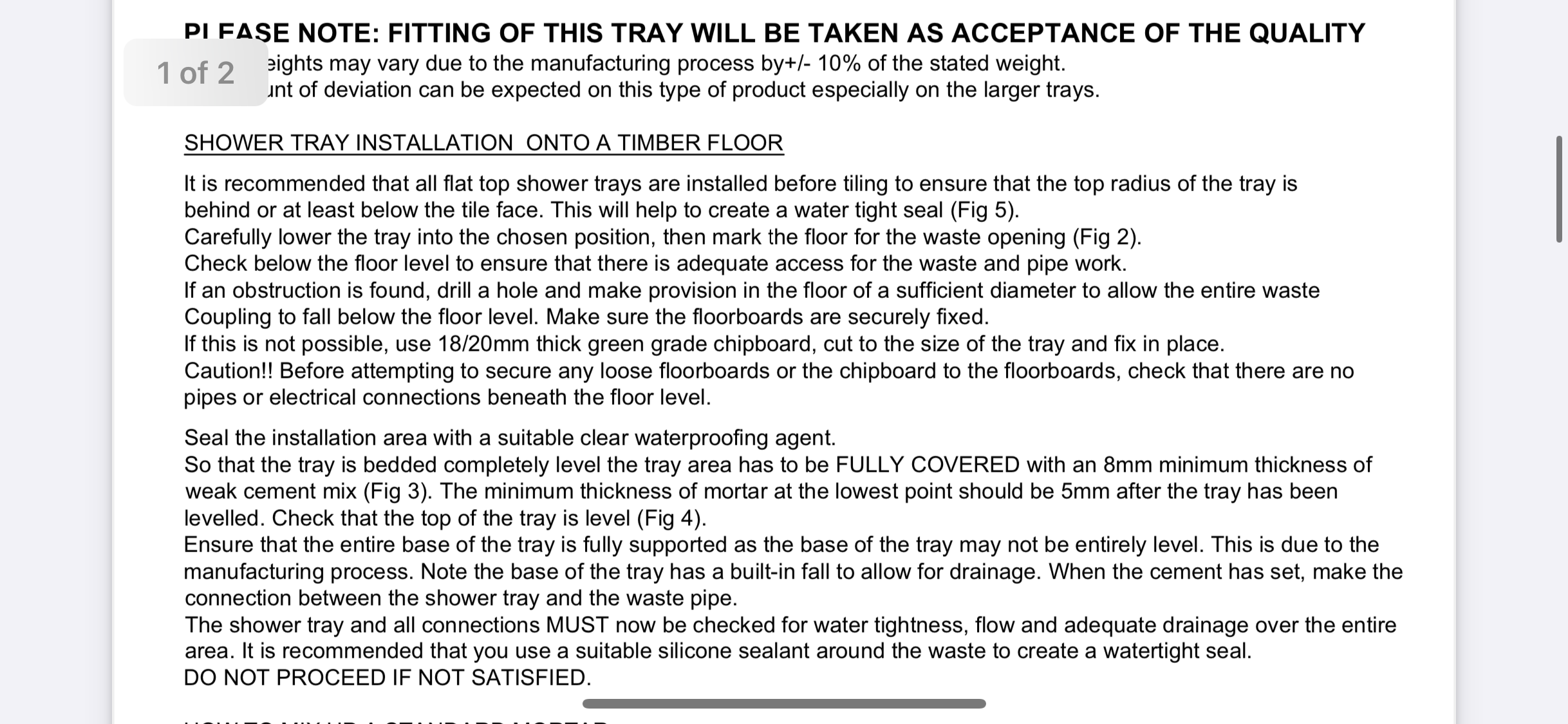

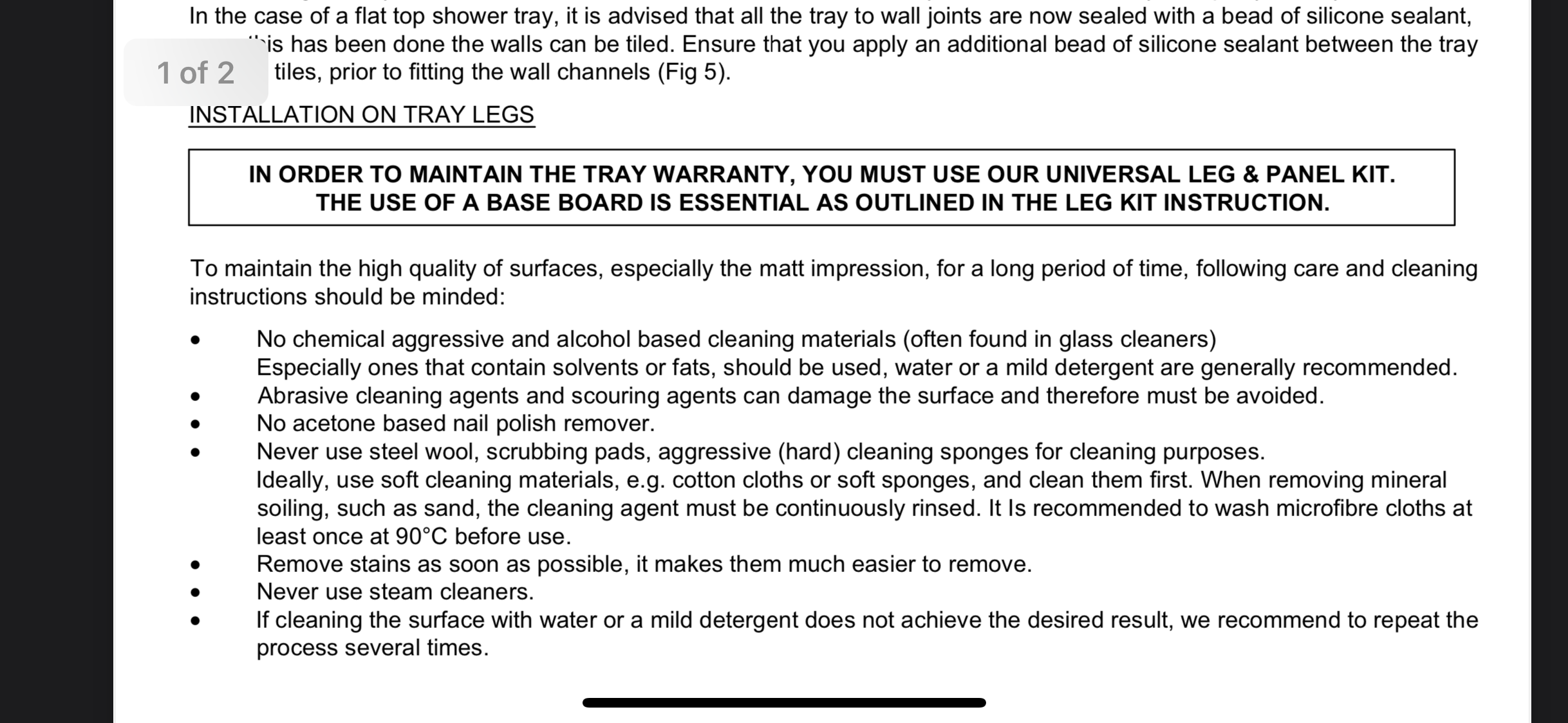

Guest Posted May 11, 2024 Posted May 11, 2024 Hi everyone looking for some advice if possible i wanted to know how important this step is on my shower tray installation guide (see photos) So far I’ve installed it by siliconing it onto a custom built wooden frame is this going to be fine or am I gonna experience issues in the future thanks in advance

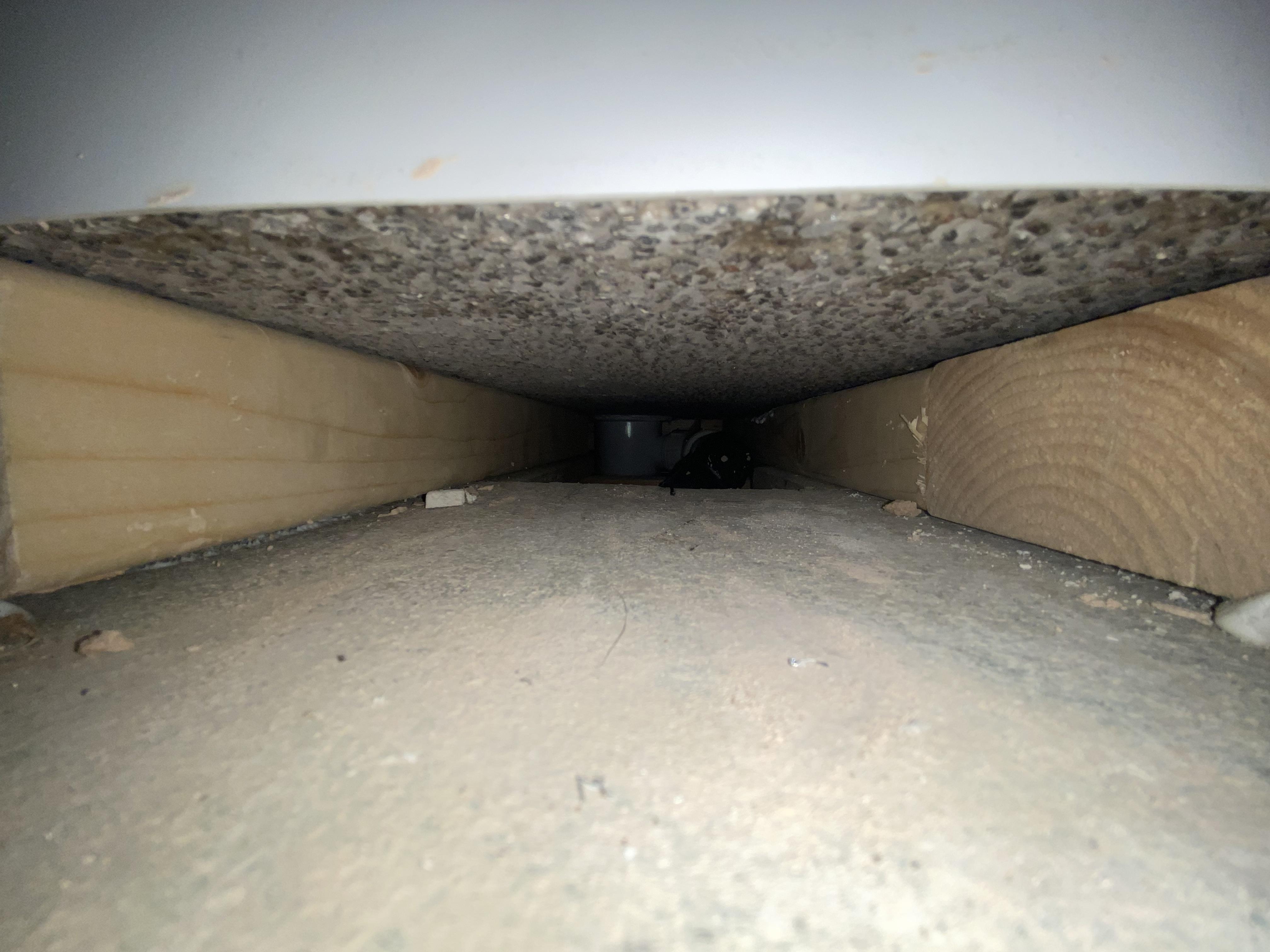

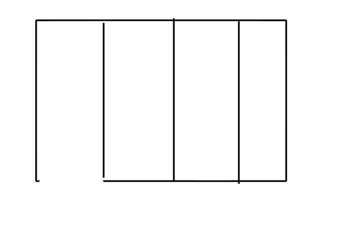

Guest Posted May 11, 2024 Posted May 11, 2024 Forgot to add some photos showing the frame that the tray has been set on I’ve got three support bars in the middle and then all the edges and sides have support also planning on using expanding foam on the cavatitys for extra support The base is attached to the floor using silicone and the tray is also attached to the base using silicone
twice round the block Posted May 12, 2024 Posted May 12, 2024 So your not going to bed it down on a mortar mix then ? 1
Pocster Posted May 12, 2024 Posted May 12, 2024 Definitely want to bed that - I used flexible tile adhesive on mine . Bedded to marine ply sheet which in turn was glued and screwed to battons . 1
Redbeard Posted May 12, 2024 Posted May 12, 2024 Hmmm... so the tray is already fixed in. You do want to bed in a semi-dry mix of sand-cement as per the instructions you posted. My tray was not raised on a frame so I had to guess the height of the s/cem mix and luckily got it right. In your case you could just use a T-piece of wood/ply and push it in like a croupier shifting chips (no, not the edible ones). 1

Temp Posted May 12, 2024 Posted May 12, 2024 Shower trays are normally bedded on mortar (or flexible tile adhesive for thin beds). I believe this is to reduce the risk of the tray cracking by providing distributed support. If your installer hasn't bedded the tray you have to wonder what sort of job he is doing elsewhere. 2

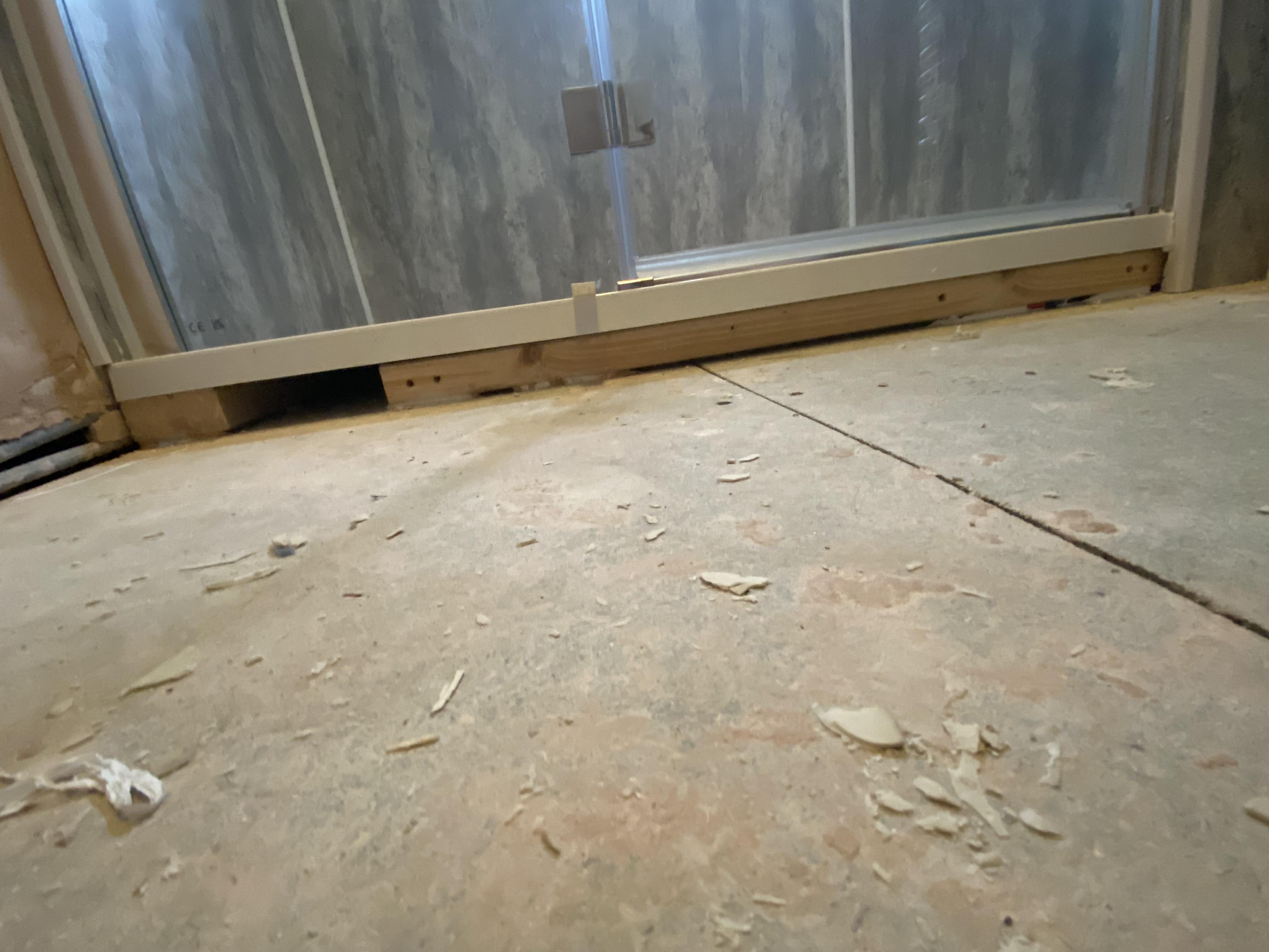

Guest Posted May 12, 2024 Posted May 12, 2024 (edited) This is the custom built frame he put in just so you can see the support but there was no plinth or anything the gaps are just hallow is the only issue that I might face is that the tray could crack or is there more issues I could face I need to know so I can go back to him and say why I’m not happy and why I’m concerned Edited May 12, 2024 by Jamie rhys

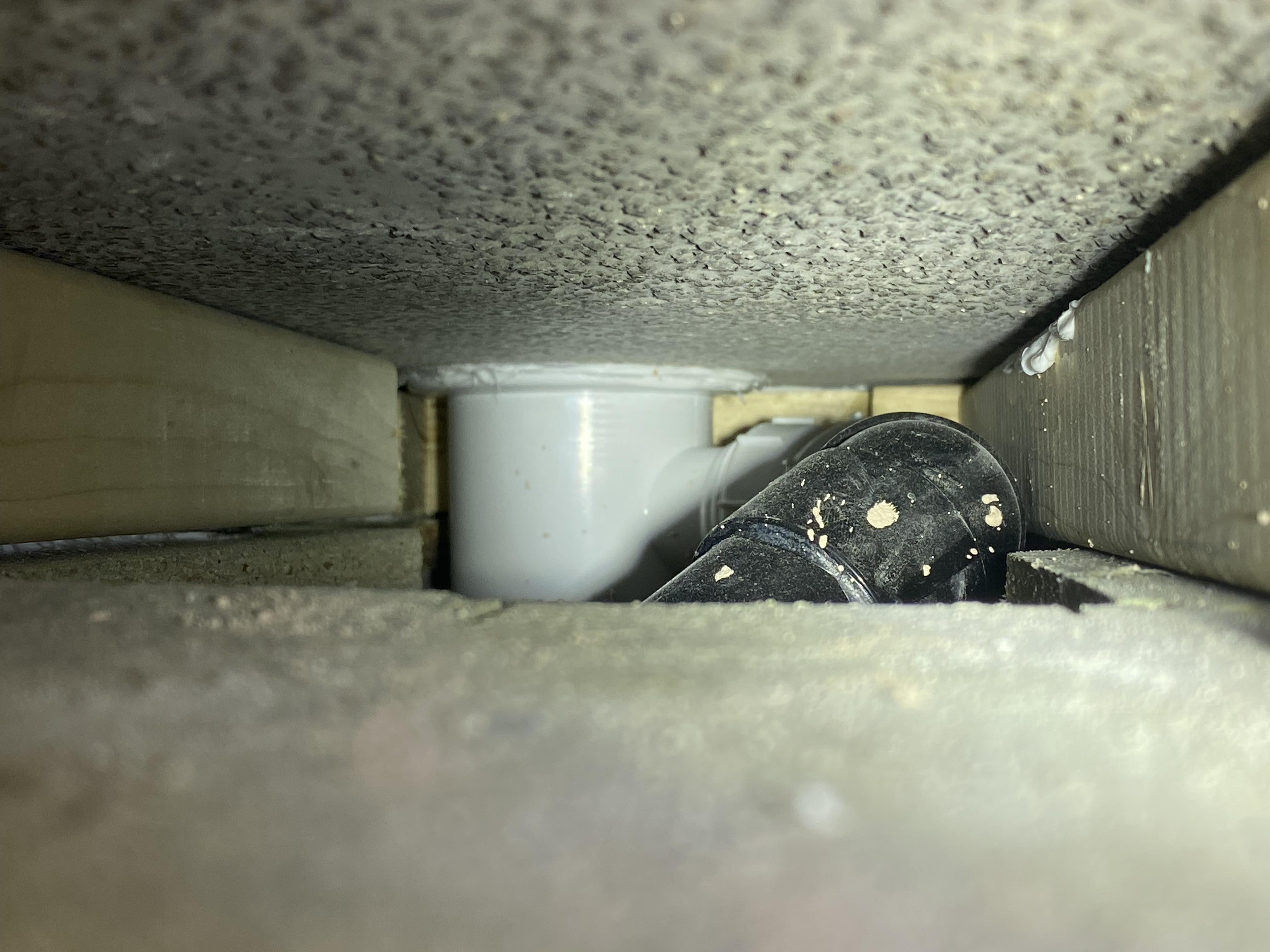

Bozza Posted May 12, 2024 Posted May 12, 2024 Well for starters the manufacturers warranty wont be valid. That appears to be a slimline tray ? I can only assume it’s been placed on a timber frame to make it easier to run the waste pipe above the floor boards ? If so that’s lazy work. I am not a plumber but did my parents bathroom and installed a slimline tray and lifted the flooring and waste pipe noticed the joists and laid 18mm ply and bedded the tray into that flat surface which is I’m sure the proper way to do that. why has the installer done it that way ? You’ve posted elsewhere regarding the dodgy screen support arm. Is your installer a professional plumber both these things are raising red flags for me I’m afraid. Sometimes waste pipes may need to run above the floor level, in which case there is no point in buying a slimline tray that’s why deep trays exist. 1
Guest Posted May 12, 2024 Posted May 12, 2024 (edited) 38 minutes ago, Bozza said: Well for starters the manufacturers warranty wont be valid. That appears to be a slimline tray ? I can only assume it’s been placed on a timber frame to make it easier to run the waste pipe above the floor boards ? If so that’s lazy work. I am not a plumber but did my parents bathroom and installed a slimline tray and lifted the flooring and waste pipe noticed the joists and laid 18mm ply and bedded the tray into that flat surface which is I’m sure the proper way to do that. why has the installer done it that way ? You’ve posted elsewhere regarding the dodgy screen support arm. Is your installer a professional plumber both these things are raising red flags for me I’m afraid. Sometimes waste pipes may need to run above the floor level, in which case there is no point in buying a slimline tray that’s why deep trays exist. I’m not sure if my guy is a plumber but is definitely a joiner he does advertise for bathrooms and kitchens we had him in to do doors and he did a good job and so we got him to quote us for our shower room we were happy with the price but as you can see we’re seeing issues now he did also install our downstairs bathroom which including fitting a new sink, toilet and towel radiator and we had no issues with that so we went ahead with the shower room he said the reason why he had to lift the tray up off the floor is their was a pipe from out boiler underneath the floor which would block the waste pipe for the shower hence why he built the custom frame the pipes in red are the ones that were blocking the waste pipe Edited May 12, 2024 by Jamie rhys
Redbeard Posted May 12, 2024 Posted May 12, 2024 The 'custom frame' is not a problem per se. However the instructions say it should be fully bedded in sand/cement. It should. I cannot, you cannot and he cannot guarantee that it will not crack if you have not followed the instructions for fitting provided by the manufacturer. I *think* there will be too much movement in squirty foam. I have never tried to make it load-bearing, but if you have doubts get or make a wooden box, squirt foam into the bottom then stand on it. If it gives at all it could give when you stand on the shower tray. Trying to measure by eye the gap on the LHS looks about 200mm. Are they equal? Is the bottom of the tray completely flat? If it sits fully on the bearers it *may* be OK, depending how thick it is and how much it will flex in that ?200mm? width, but if it isn't, as others have said, you would have no claim against the manuf'r as you have not followed their instructions. I would guess you could cut the end piece out carefully between each batten.
Guest Posted May 12, 2024 Posted May 12, 2024 26 minutes ago, Redbeard said: The 'custom frame' is not a problem per se. However the instructions say it should be fully bedded in sand/cement. It should. I cannot, you cannot and he cannot guarantee that it will not crack if you have not followed the instructions for fitting provided by the manufacturer. I *think* there will be too much movement in squirty foam. I have never tried to make it load-bearing, but if you have doubts get or make a wooden box, squirt foam into the bottom then stand on it. If it gives at all it could give when you stand on the shower tray. Trying to measure by eye the gap on the LHS looks about 200mm. Are they equal? Is the bottom of the tray completely flat? If it sits fully on the bearers it *may* be OK, depending how thick it is and how much it will flex in that ?200mm? width, but if it isn't, as others have said, you would have no claim against the manuf'r as you have not followed their instructions. I would guess you could cut the end piece out carefully between each batten. Okay I can measure up the distance between the Battons later tonight for better information since it’s not been installed correctly as per the manufacturer instructions what would you suggest I do with my guy should I express that he’s installed not in line with the manufacturer instructions and ask him to put it right even though that might require him to rip out the tray and all the cladding or should I just say nothing and hope it doesn’t become a problem?

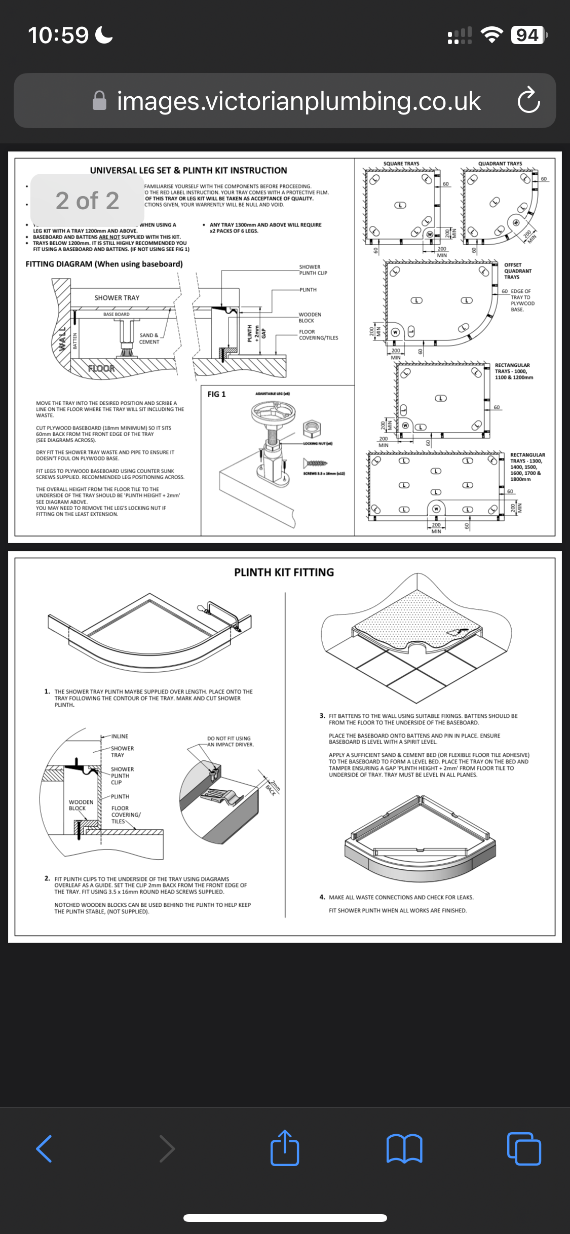

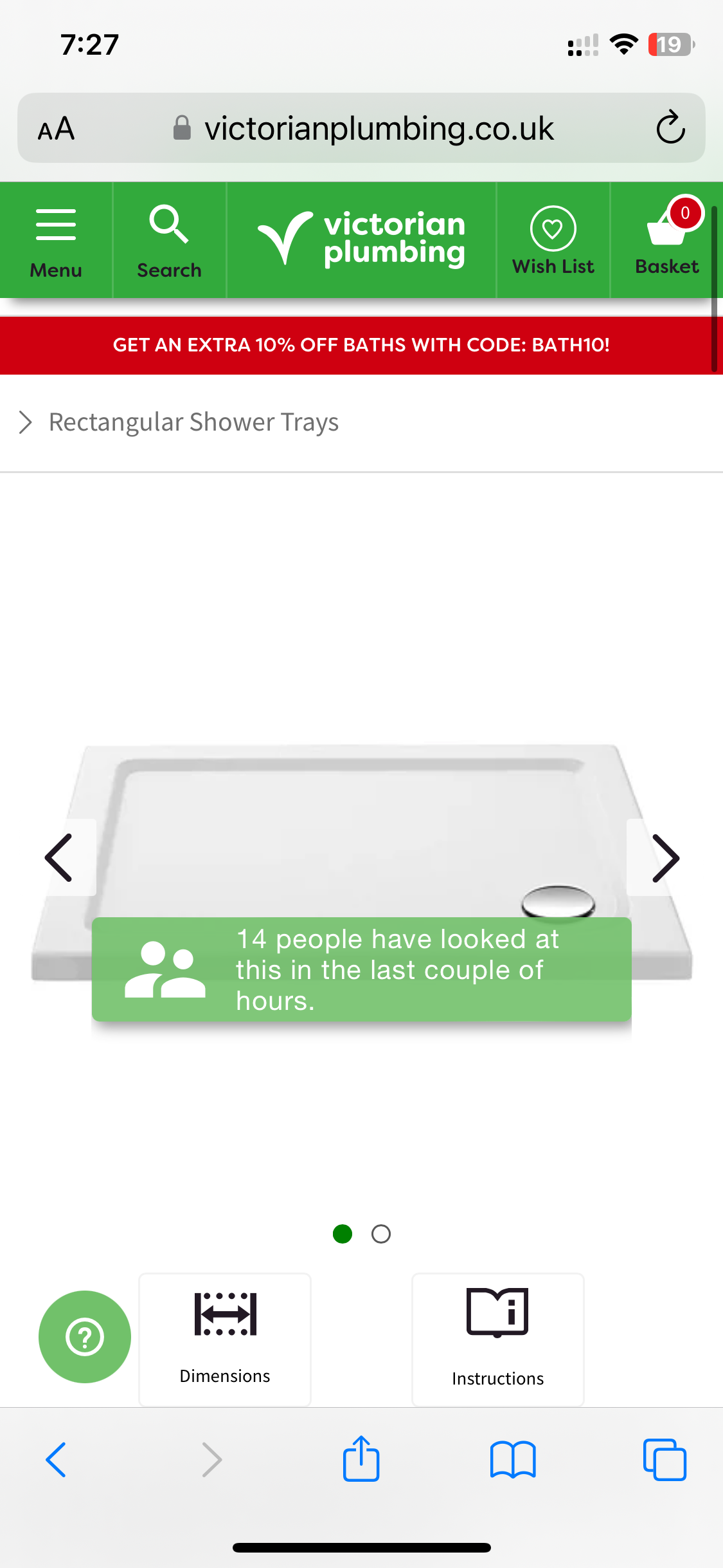

Guest Posted May 12, 2024 Posted May 12, 2024 I notice that the shower tray guide also says you can use their universal leg guide https://images.victorianplumbing.co.uk/products/pack-of-6-legs-for-easy-plumb-shower-tray-panel-ntp001/instructions/screwlegs_enclosures_v2_fi.pdf but this was not done either so the warranty is still void 🤦🤦♂️

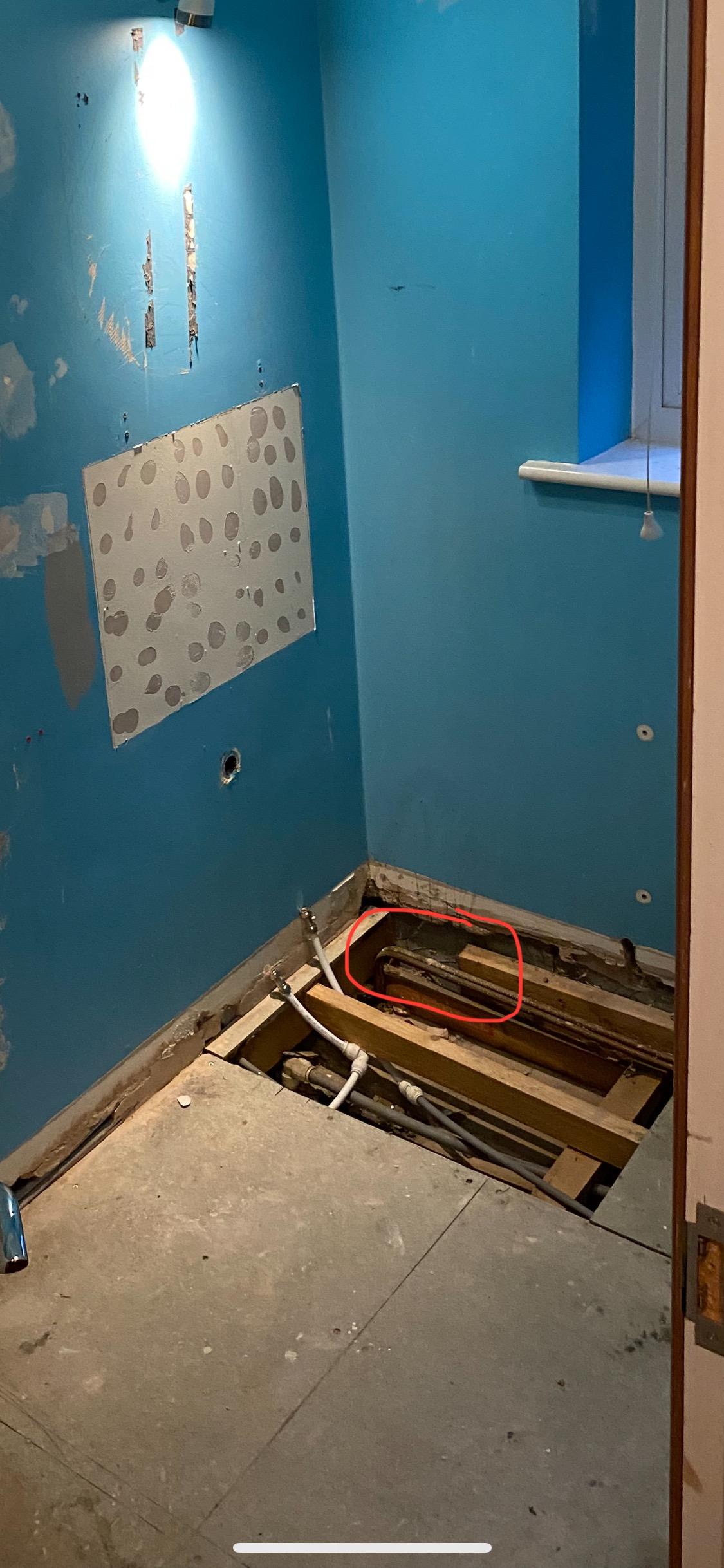

Bozza Posted May 12, 2024 Posted May 12, 2024 From the pipework picture there appears to be room to reroute the pipe work closer to the middle joist thus allowing the correct low profile installation of the waste pipe & tray. But that would depend on what’s to the right and where the waste would run to. so either (a) it was impossible to reconfigure the pipe work or (b) it was possible but he either can’t do that level of plumbing or didn’t want to do that work and it’s easier to put it on a plinth but having decided to put it on a plinth, he’s decides to fabricate one out of softwood rather than a proper legs & plinth kit. I’m not a plumber nor a tradesman but fitted a low profile tray for my parents house and had obstructive pipe work underneath which though time consuming even I was able to reroute. If I had been unable to re route and had to raise the tray, there is no way I’d have done what he’s done. I’d have got the correct plinth & legs set and replaced the chipboard with marine ply for enhanced stability. id be asking him why he didn’t reroute the obstructive pipework, and why he didn’t utilise the correct plinth kit & legs. I can guess the true answer may be because it’s easier for him to do it that way.
Guest Posted May 13, 2024 Posted May 13, 2024 24 minutes ago, Bozza said: From the pipework picture there appears to be room to reroute the pipe work closer to the middle joist thus allowing the correct low profile installation of the waste pipe & tray. But that would depend on what’s to the right and where the waste would run to. so either (a) it was impossible to reconfigure the pipe work or (b) it was possible but he either can’t do that level of plumbing or didn’t want to do that work and it’s easier to put it on a plinth but having decided to put it on a plinth, he’s decides to fabricate one out of softwood rather than a proper legs & plinth kit. I’m not a plumber nor a tradesman but fitted a low profile tray for my parents house and had obstructive pipe work underneath which though time consuming even I was able to reroute. If I had been unable to re route and had to raise the tray, there is no way I’d have done what he’s done. I’d have got the correct plinth & legs set and replaced the chipboard with marine ply for enhanced stability. id be asking him why he didn’t reroute the obstructive pipework, and why he didn’t utilise the correct plinth kit & legs. I can guess the true answer may be because it’s easier for him to do it that way. From what I remember he said that the waste pipe was getting obstruction by the copper pipes which are for our boiler he said he didn’t wanna touch them pipes in case we then had any issues with our boiler in the future so he said he was going to raise the tray up on this wooden frame which we assumed was fine since I’ve never fitted a shower tray and don’t know what’s involved it’s only afterwards I’ve seen all this about laying a weak cement mix I get the feeling I’m going to have to tell him he needs to install this correctly as per the instructions which is going to be a flipping mess around since he’s already siliconed the shower tray to the wooden framed and the wall and has now put up and glued the cladding on extra photo of the waste pipe

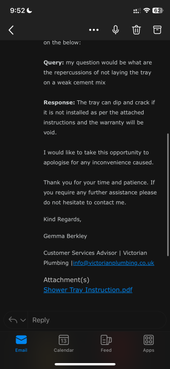

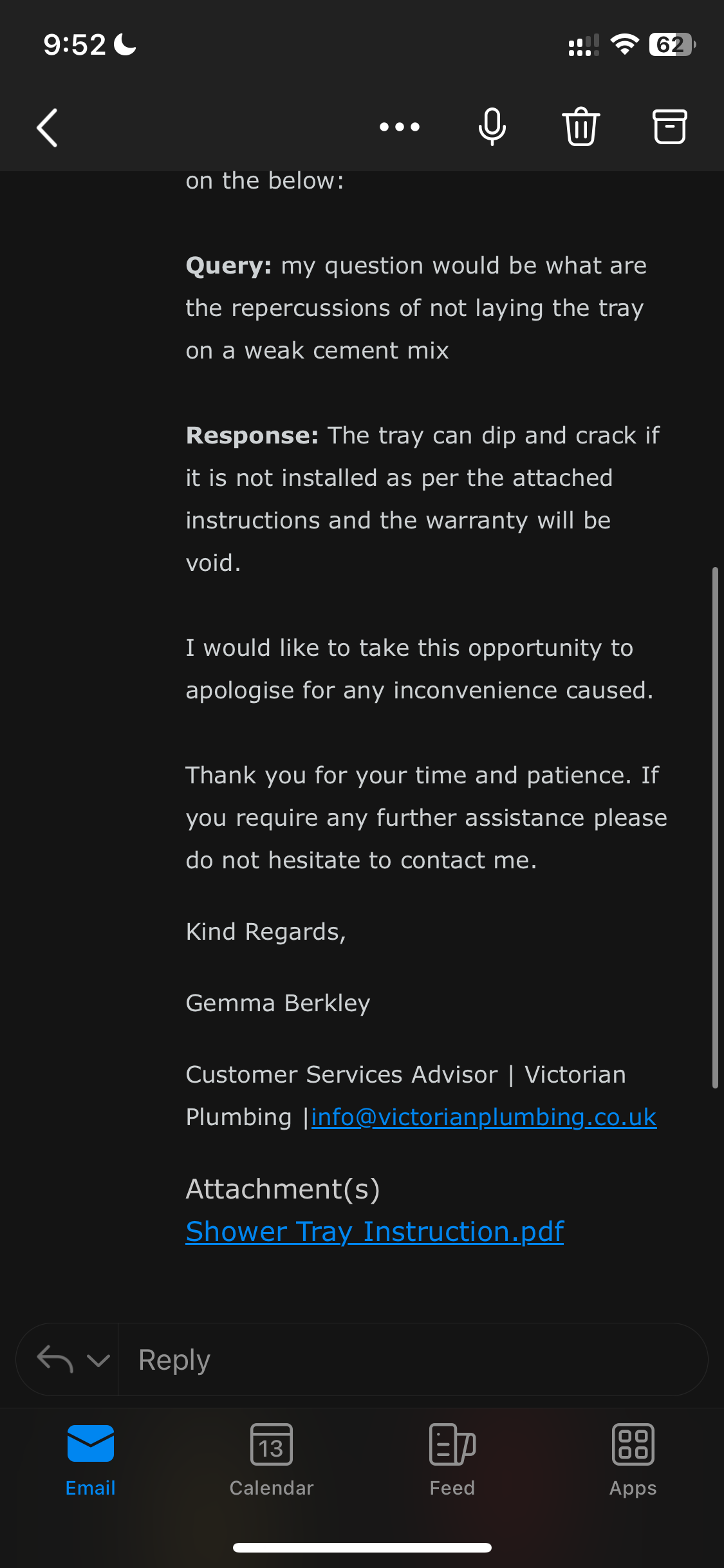

Bozza Posted May 13, 2024 Posted May 13, 2024 7 hours ago, Jamie rhys said: From what I remember he said that the waste pipe was getting obstruction by the copper pipes which are for our boiler he said he didn’t wanna touch them pipes in case we then had any issues with our boiler in the future so he said he was going to raise the tray up on this wooden frame which we assumed was fine since I’ve never fitted a shower tray and don’t know what’s involved it’s only afterwards I’ve seen all this about laying a weak cement mix I get the feeling I’m going to have to tell him he needs to install this correctly as per the instructions which is going to be a flipping mess around since he’s already siliconed the shower tray to the wooden framed and the wall and has now put up and glued the cladding on extra photo of the waste pipe You could leave it / chance it but at your own risk. there appear to be a gap between the tray and the timber on the right hand side. So it’s not even sitting on that. To place it on a plinth without using the correct plinth kit it would have been better to use ply sheeting on top of a frame thus creating a false & level floor. Then bedding it on that. Warranty would have been good. if he’s given a reason for not rerouting the plumbing “in case there’s a problem with the boiler” that sounds like a nonsense reason / excuse TBH. I bet he’s on a fixed price for the job. his solution is the cheapest and easiest for HIM. 1
Guest Posted May 13, 2024 Posted May 13, 2024 Yeah so I think I’m going to have to speak with him and tell him he needs to put this right not gonna be a fun conversation and I’m sure as hell he’s not gonna be happy with it but it’s too much of a risk especially after getting confirmation from the manufacturer just not prepared to take this risk I would like to thank everyone who has helped me I really appreciate it and hopefully he does it right this time around otherwise I’ll end up back here 🤦♂️
