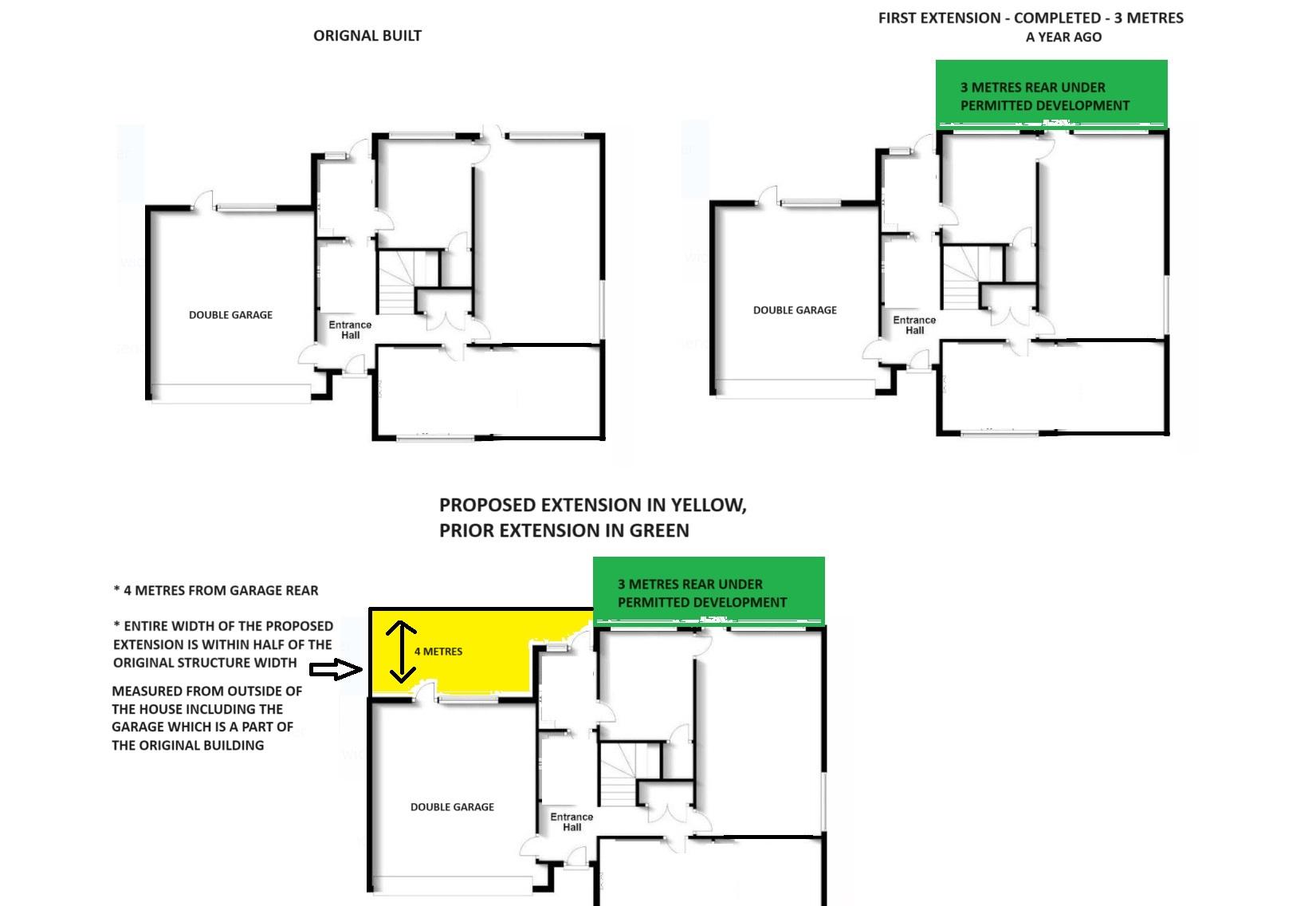

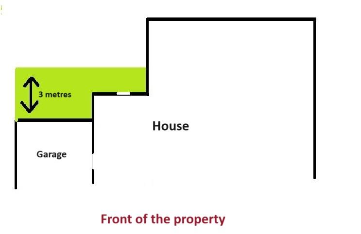

Newbie To Extensions Posted May 9 Share Posted May 9 Dear all, I would like to construct a small room behind the attached garage of my detached property. The house currently has the garage attached to its side. (picture provided below). The entire house with the attached garage all originally constructed together. I am going under 3 metres and the extension will end well before the current rear wall of my house. I believe this should be a simple extension and well covered under the permitted development, there is plenty of curtilage after extension. The architect says this would require planning permission as construction behind a garage is not permitted development. Please could some one advise if they have done a rear extension behind the garage under permitted development? Thanks in advance Link to comment Share on other sites More sharing options...
DevilDamo Posted May 9 Share Posted May 9 (edited) If the depth does not exceed 4m and the overall width does not exceed more than half the width of the original house, then it may well be considered PD. Any reason why you’re trying to avoid Planning? Are you within the Green Belt? Edited May 9 by DevilDamo Link to comment Share on other sites More sharing options...
Newbie To Extensions Posted May 10 Author Share Posted May 10 Thanks for your response, I am keen on starting the work in a month's time as need the extra space for urgent personal reasons. Planning would mean waiting for atleast 2 to 2.5 months. The builder is available to start the work too. The overall width at the widest - if it is widest measured from outside (inside would lose out the wall width) then the extension will not exceed more than half the width of the original house. Hence why wondering taking PD route is fine, once the work is started is there a chance for council to make random visit and question the construction. It usually doesnt work that way right, they don't bother unless someone complains isnt it? In this case as it is straightforward and not impacting any neighbours there should not be an issue in work getting stopped etc? Link to comment Share on other sites More sharing options...

DevilDamo Posted May 10 Share Posted May 10 8 hours ago, Newbie To Extensions said: Thanks for your response, I am keen on starting the work in a month's time as need the extra space for urgent personal reasons. Planning would mean waiting for atleast 2 to 2.5 months. The builder is available to start the work too. The overall width at the widest - if it is widest measured from outside (inside would lose out the wall width) then the extension will not exceed more than half the width of the original house. Hence why wondering taking PD route is fine, once the work is started is there a chance for council to make random visit and question the construction. It usually doesnt work that way right, they don't bother unless someone complains isnt it? In this case as it is straightforward and not impacting any neighbours there should not be an issue in work getting stopped etc? It would appear to comply with the PD requirements. If you want that formally confirmed, you would need to submit a Lawful Development Certificate application. Btw, assume this is not a bungalow? You will require Building Regulations. A BN application is fine providing you’re not excavating over or within 3m of a public sewer. Otherwise, you would need to submit a FP application. Or if you get the Build Over Agreement sorted before you submit a Building Regulation application, then a BN application would be ok. Will your excavations be within 3m of a neighbours’ building? Link to comment Share on other sites More sharing options...
Newbie To Extensions Posted May 10 Author Share Posted May 10 1 hour ago, DevilDamo said: It would appear to comply with the PD requirements. If you want that formally confirmed, you would need to submit a Lawful Development Certificate application. Btw, assume this is not a bungalow? You will require Building Regulations. A BN application is fine providing you’re not excavating over or within 3m of a public sewer. Otherwise, you would need to submit a FP application. Or if you get the Build Over Agreement sorted before you submit a Building Regulation application, then a BN application would be ok. Will your excavations be within 3m of a neighbours’ building? LDC would still mean wait for 8 weeks, I am glad one person other than me says it is a PD. Atleast four other architects all said differently with reasons like - this could become wrap around, garage is not a main structure and extension to the rear of the garage is not a PD etc. But I keep reading PD guide inside out and the more I read the more I am convinced it is a PD. Btw the property was once extended behind the main house for 3m. Now this rear and side is more of an infill but still not reaching the exisiting extended rear. The excavation will be 2.5 m of the neighbours' garden alleyway but atleast 3.5 metre from the neighbours' garage. No public sewer at all. Link to comment Share on other sites More sharing options...
DevilDamo Posted May 10 Share Posted May 10 LDC applications are optional. If you’re confident the proposals are PD, there’s nothing stopping you in submitting a LDC application, then a BR application and then starting works. Wrap arounds are not normally PD. But primarily because they fail the “no more than half the width” rule. This one would appear to meet that, especially if the garage is original. Link to comment Share on other sites More sharing options...
Newbie To Extensions Posted May 10 Author Share Posted May 10 16 minutes ago, DevilDamo said: LDC applications are optional. If you’re confident the proposals are PD, there’s nothing stopping you in submitting a LDC application, then a BR application and then starting works. Wrap arounds are not normally PD. But primarily because they fail the “no more than half the width” rule. This one would appear to meet that, especially if the garage is original. Sorry, when you say 'This one would appear to meet that' - you mean wrap around or no more than half the width rule hence qualifies as PD? Link to comment Share on other sites More sharing options...
DevilDamo Posted May 10 Share Posted May 10 This design would appear to meet the PD rules. Link to comment Share on other sites More sharing options...

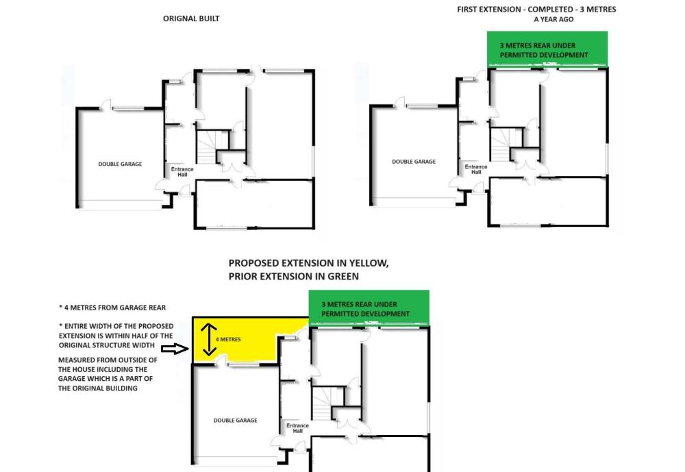

Newbie To Extensions Posted May 10 Author Share Posted May 10 44 minutes ago, DevilDamo said: This design would appear to meet the PD rules. Thank you so much for your responses, I was wondering if it would help if I give you a diagram explaining the full picture here. The house went through its very first PD extension a year ago and this is hopefully the second PD to go through. I would be grateful if you could let me know your thoughts why the architects may say this would not qualify as PD. Thanks in advance Link to comment Share on other sites More sharing options...
DevilDamo Posted May 10 Share Posted May 10 Ok, now I’ve seen that… my opinion changes. If the yellow part connects to the green part, it isn’t PD. If the above layout is what you want, you will require Planning. Otherwise, reduce the depth of the yellow line part so there is no physical connection to the green part. Link to comment Share on other sites More sharing options...
Newbie To Extensions Posted May 10 Author Share Posted May 10 1 hour ago, DevilDamo said: Ok, now I’ve seen that… my opinion changes. If the yellow part connects to the green part, it isn’t PD. If the above layout is what you want, you will require Planning. Otherwise, reduce the depth of the yellow line part so there is no physical connection to the green part. Ah, that is disappointing but good to find out now than when it is too late! I was wondering if I am not seeing something that the others who suggest planning are actually seeing. But only you have clearly explained why it requires planning. The point that the new extension cannot connect the old extension is a new thing that I don't think I have read anywhere in the PD document. Should be one of those construed rules, would you mind me asking which rule of PD would it break when the new extension meets the old extension? Unfortunately reducing the depth of the yellow part is'nt a viable option as I will end up with a very odd space and the rear will be at three odd levels. So I have to take the planning route. Really appreciate your prompt and timely response. Link to comment Share on other sites More sharing options...
DevilDamo Posted May 10 Share Posted May 10 https://assets.publishing.service.gov.uk/media/5d77afc8e5274a27cdb2c9e9/190910_Tech_Guide_for_publishing.pdf (Page 26) In your situation, the resulting extensions would not meet PD as they would fail to meet the PD rules for a side extension, as elements would come off a side wall. PD doesn’t just focus on extensions in isolation but the “resulting” extensions which do not form part of the original house. Link to comment Share on other sites More sharing options...
Newbie To Extensions Posted May 10 Author Share Posted May 10 32 minutes ago, DevilDamo said: https://assets.publishing.service.gov.uk/media/5d77afc8e5274a27cdb2c9e9/190910_Tech_Guide_for_publishing.pdf (Page 26) In your situation, the resulting extensions would not meet PD as they would fail to meet the PD rules for a side extension, as elements would come off a side wall. PD doesn’t just focus on extensions in isolation but the “resulting” extensions which do not form part of the original house. Got it, its very clear now. The width calculation for my new side extension will start from the end and will only stop when it meets an old existing structure. But in my diagram it will continue with the new existing structure, hence the extension of width will be the entire width of the property. Now that it is clear that it has to be a planning, in your experience do you think this application would be straightforward and will not be room for any rejection? I am not obstructing any neighbours light or access with this construction. No trees impacted and boundary is much further too. Is there any precaution you suggest/ any area I need to be careful? Is there any article on things that become ground for planning rejections that you could advise? I could go through them. Link to comment Share on other sites More sharing options...
DevilDamo Posted May 10 Share Posted May 10 That’s right. Your proposed extension along with the existing extension would be 100% of the overall width of the original dwelling, hence why it would not constitute PD. The majority of single storey extensions go through Planning with no issues. There shouldn’t be any major reason as to why yours wouldn’t go through too. If they were to be difficult, you could argue that you have a potential PD fallback position. But as mentioned above, that fallback position would be a slight reduction in the depth (so the extensions do not connect). Link to comment Share on other sites More sharing options...

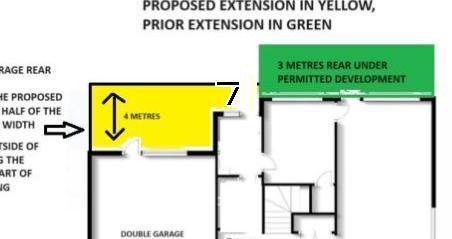

ProDave Posted May 12 Share Posted May 12 What happened to the idea of build it so the new extension does not quite reach the old extension so it would qualify? Then later apply for PP to bridge the tiny gap between the two PD extensions? Build footings etc to allow that right from the start. 1 Link to comment Share on other sites More sharing options...
Newbie To Extensions Posted May 12 Author Share Posted May 12 10 minutes ago, ProDave said: What happened to the idea of build it so the new extension does not quite reach the old extension so it would qualify? Then later apply for PP to bridge the tiny gap between the two PD extensions? Build footings etc to allow that right from the start. Mmm, that is an option but the builder would like to finish the work start to finish than a two job, the bridging one separate from first one! Link to comment Share on other sites More sharing options...
ProDave Posted May 12 Share Posted May 12 How about this. Excuse the lousy picture. Build the extension as shown in yellow. It does not join the existing extension. Yes you have to go outside and then back in through a door to get to the new extension. Then later (with PP) build the link, which is little more than put a door on the back and a roof over the link. Easy if the foundation work is done at the time of the main build. 1 Link to comment Share on other sites More sharing options...
DevilDamo Posted May 12 Share Posted May 12 @Newbie To Extensions What’s the point in applying retrospectively? Why not just submit a Planning application, submit a Building Regulation application and start building? Although it isn’t advised to start works before or without receiving Planning approval, it’s better to apply before than doing it after. @ProDave Although the OP was wanting to avoid the “lengthy” Planning process but have what they need (which requires Planning). Link to comment Share on other sites More sharing options...
Newbie To Extensions Posted May 12 Author Share Posted May 12 3 hours ago, ProDave said: How about this. Excuse the lousy picture. Build the extension as shown in yellow. It does not join the existing extension. Yes you have to go outside and then back in through a door to get to the new extension. Then later (with PP) build the link, which is little more than put a door on the back and a roof over the link. Easy if the foundation work is done at the time of the main build. Thanks for taking the effort to do the drawing, but working on a tight budget. I have a feeling that doing it this way will escalate the costs, but I will check with my building about this. Link to comment Share on other sites More sharing options...
Newbie To Extensions Posted May 12 Author Share Posted May 12 2 hours ago, DevilDamo said: @Newbie To Extensions What’s the point in applying retrospectively? Why not just submit a Planning application, submit a Building Regulation application and start building? Although it isn’t advised to start works before or without receiving Planning approval, it’s better to apply before than doing it after. @ProDave Although the OP was wanting to avoid the “lengthy” Planning process but have what they need (which requires Planning). Didnt realise that was an option,,, I thought council wouldnt take it well if the work is already started when they come over for an inspection. Would they not instruct to stop until approval is received? Link to comment Share on other sites More sharing options...
DevilDamo Posted May 12 Share Posted May 12 You wouldn’t be in their best books whichever way you decide. But by applying before you start is better than during or after. They cannot tell you to stop works if there’s a live and pending application. They could potentially tell you to stop should you not submit an application and are reported for potentially unauthorised works. But the first thing the LPA would or should do is invite you to submit an application. Link to comment Share on other sites More sharing options...
