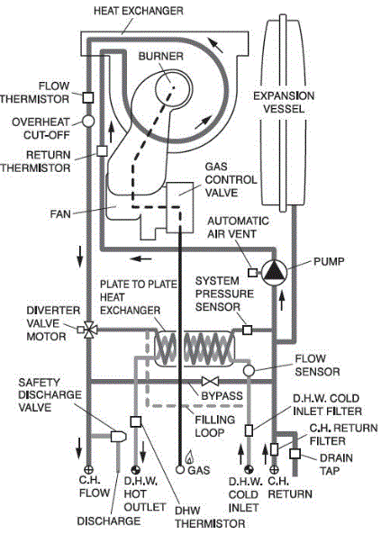

Please also find generic gas combi functional block diagram image attached - I don't imagine mine is much different.

Question(s) (these relate to initial transient heating, as quickly as possible, of hot tub water from cold to 40C)  - there could be a lot of "impossible" / "it depends" / "needs clarification" associated with this:
Comparing 3 cases...
a/ Using combi boiler primary gas to water heat exchanger direct connection to hot tub
Combi CH flow connected directly to highest point of hot tub water, Combi CH return connected directly to lowest point (to aid condensing) of hot tub water (for now, please imagine pipe connection friction losses as zero).
The combi instruction manual says "Your appliance has a pressure sensor - if it falls below 0.3 bar the appliance switches off":
(i) If the water at the top of the hot tub is 3 metres above the level of the combi pressure sensor should the appliance stay on i.e. now a vented system?
The combi installation manual says "Circulation water volume  (delta T = 20K) = 1032l/min" ... at 4200 J/kg°C SHC this is 24.08 kW:
(ii) If the water at the top and bottom of the hot tub were both at, say, 5C when heating began could I expect, at least, a 24.08kW transfer rate when the hot tub thermostat initially called for heat?.
(iii) Can I assume the Gas combi will be in condensing mode throughout this heating period because the  CH return will always be less than or equal to 40C?
b/ Using combi boiler primary gas to water exchanger connection to external hot tub water to water heat exchanger
Combi CH flow / CH return connected to the primary of a newly purchased water to water heat exchanger (the secondary of this new item being supplied with pumped pool water. For discussion, please imagine  the thermodynamic properties of this new heat exchanger are exactly the same as those of the gas combi existing inbuilt water-to-water (DHW) heat exchanger  (for now, please also imagine pipe connection friction losses as zero).
The gas combi instruction manual says "DHW flow rate delta T = 35K rise = 11.5 l/min" ... at 4200 J/kg°C SHC this is 28.175kW:
(i) if the hot tub circulation pump pushed 11.5litres through the new heat exchanger's secondary in 1 minute would the hot tub have gained 28.175x60 kJ?
(ii) Since heat transfer is directly proportional to temp difference then, In each subsequent minute, the heat transfer rate would decrease from this 28.175kW as the pool gradually heats?
(iii) Can the state of the return flow temp,in this case, be easily determined to be above/below condensing level?
c/ Using combi boiler internal DHW Hot Outlet to fill hot tub via open hose (i.e. without recirculation)
repeating from b/ above:
If mains water was supplied at constant 5C at 11.5l/min it would take  1000/11.5 = 87 min = 1.45 hours to fill the tub.
(i) Assuming zero heat loss this would require 28.175 x 1.45 = 40.85kWh of gas - is that correct?
(ii) Again, can the state of the return flow temp be easily determined to be above/below condensing level for DHW operation?
My current observation, with low level confidence is that, for initial heating only, DHW using a hose could be the quickest fill of the 3 options.

Your combi needs to be in an unvented circuit, so it gets a permission to start.  Get yourself a plate heat exchanger - cheap enough on eBay.
Plumb your primary circuit to the primary side of the PHE and the hot tub to secondary side with a circulation pump. Use a thermostat and timer on the hot tub to heat as and when you want. Set the heating side flow temp to about 40 to 45 so you don't boil yourself. But a return water pipe stat on as well set to protect you should things get a little hot without you knowing.

Because with a series of unfortunate failures here, you have a scald risk. Those that don't know, don't know, and they are the dangerous ones. A little like those who argue that doing your own gas work is legal, which on a dark day may well be the case, but ONLY if you are the sole occupant of the house and you have the only key to get in to it.
Absolutely do not do this, it is dangerous as feck.
Possible, but expensive and complex.
The easiest, as it's what I do to top up the kids outdoor paddling pool to take the edge off the cold water it gets filled with after cleaning.
However, this is done via a thermostatic mixing valve to prevent scalding water getting to the hose. Any instantaneous water heater carries a serious risk of delivering scalding water.
OK, time for a reality check methinks!!!!
Just go and buy a simple, cheap A2W pool / hot tub heat pump LINK and end this madness. Great CoP and you can do away with the relic of a boiler you are gambling all this cost and complexity on, as it will fail shortly and then you'll be kicking yourself.

A.
i) Not sure.
ii) I would expect it to deliver close to 28kW. Even when the return is 40 and the flow 60C. That's also a 20C uplift. But I think you should check the data. I might be wrong.
iii) yes.
Corrosion inhibitor in the tub water?
B.
i) Google suggests heat exchangers are about 90% efficient so you won't quite get 28kW out if you put 28kW into a heat exchanger.
ii) I looked at the 30kW heat exchanger here...
https://heatpumps4pools.com/myfiles/file/Elecro-G2-heat-exchanger-Leaflet.pdf
It has a table for the power transfer vs delta T..
If your boiler is 60C and the tub at 40C the delta is 20C. The data for that exchanger says the power transfer is in the range 11kW to 15kW.
If your boiler is 60C and the tub at 20C the delta is 40C. The data for that exchanger says the power transfer is in the range 20kW to 26kW.
Perhaps use a bigger heat exchanger?
iii) I think once the tub is upto 40C the boiler return will be too hot for condensing.
C.
If we assumed the heat exchanger power transfer was a constant  15kW thats 15kJ per second.
To raise the temperature from 5C to 40C requires 35*1000*4200 = 147MJ.
That would take 147*10^6/15*10^3 = 9800 seconds or about 2h 45 min.
147MJ is about 40.8 KWh (units) not including losses due to efficiency of boiler and heat exchanger, pipes etc.
I'm not a boiler engineer!  This is just physics to me.

Looking at this again, just to be sure I have it straight / not:
The gas-combi instruction manual includes, for example "CH heat output range 9.0 - 24.0 kW"
For info, on the off-chance it matters - simple thermostat on/off control was used in the combi boiler while it was hiustorically used for space heating (no bus modulation device was ever employed).
For case B, is it/could it be correct to imagine that either of the following apply:
a/ as the combi return thermistor registers a gradually increasing temperature it then modulates (in combination with the flow thermistor reading) the flame in order to keep the flow temp to set/target value (i.e. load matching)?
b/  the above at a/ is not the case  -  rather, some Vaillant predefined return temp causes the flame to extinguish entirely and the pump to continue until some "other" condition is met at which point reignition occurs (i.e. on/off at max power output)?
I'm tentatively assuming that the boilers internal single stage pump supplies a constant flow.
Example repercussions:
If a/ is true and the boiler (at target 60C) automatically modulates down to meet the Electro-G2 (as per link) load then, for example the hot tub open top/occupied reheat time (from 38 to 40C) will take, rather than nearly 5.75 mins at, say, 24 kW to replace the 2.3kWh will take, say, 2.3kWh/13kW = 10.61 mins?
If b/ is true on heating the entire 1000 litres from cold once its temp reaches 30C (delta T 30) the Electro-G2 max dissipation to hot tub falls to 20kW and the boiler will continuously cycle on/off all the way to tub thermostat stopping call for heat at 40C (since the boiler is still trying to produce mismatched 24kW)?

In an attempt to identify the maximum combustion chamber to water instantaneous available power - the combi installation manual states:
"CH heat output range 40C flow / 30C return 9.8 to 26.0 kW"
Therefore, assumption is that maximum flame /fan can generate 26 kW
The integrated pump is single speed (apparently of the non-modulating variety)- the installation manual states:
"Circulation water volume (delta T =20K)" = 1032 l/hour
Analysis based on above (simple as possible line by line):
4200    J/kg°C   SPECIFIC HEAT WATER (assume at all temperatures)
1 lite water = 1kg (assume at all temperatures)
1032    l/h    =    0.287    litre/sec    Circulation water volume
60 C     manually adjust boiler set-point flow temp to this
The available 26kW (assuming max flame/fan) provides an uplift to a first 0.287 litres of CH flow of:
                   26000/(4200 x 0.287) =            21.570 K
This first  0.287 litres enters the hot tub at (21.570 + 5) = 26.570C and is instantly mixed to raise its temperature from 5C by:
                  26000/(4200 x 1000) =            0.00619 K
At the start of the 2nd second the CH return is therefore 5.00619C
The boiler flame / fan is maintained at max (modulation logic only reduces these if flow equal or greater to 60C),
A further 26kJ is added, to this subsequent 0.287 litre, over the following second  and enters the hot tub at:
21.570 + 5.00619 =         26.576 C    (measured at CH flow thermistor, so flame/fan kept at max)
The additional 26kJ is instantly mixed and the hot tub  temperature becomes
            5.00619 + 0.00619 =        5.01238C
This is the CH return temp at start of third second
i.e. CH flow temp rises, linearly, by 0.00619K every second until Hot Tub thermostat call for heat ends at 40C. In this entire heating period the flame/fan are kept at max as the CH flow thermistor never rises to 60C.
The hot tub requires a 35K uplift to attain it's thermostat 40C cut off. This will take
35/0.00619 = 5654.28 sec    (1.57 hours)
Is that all pretty much correct (or fantasy)?
