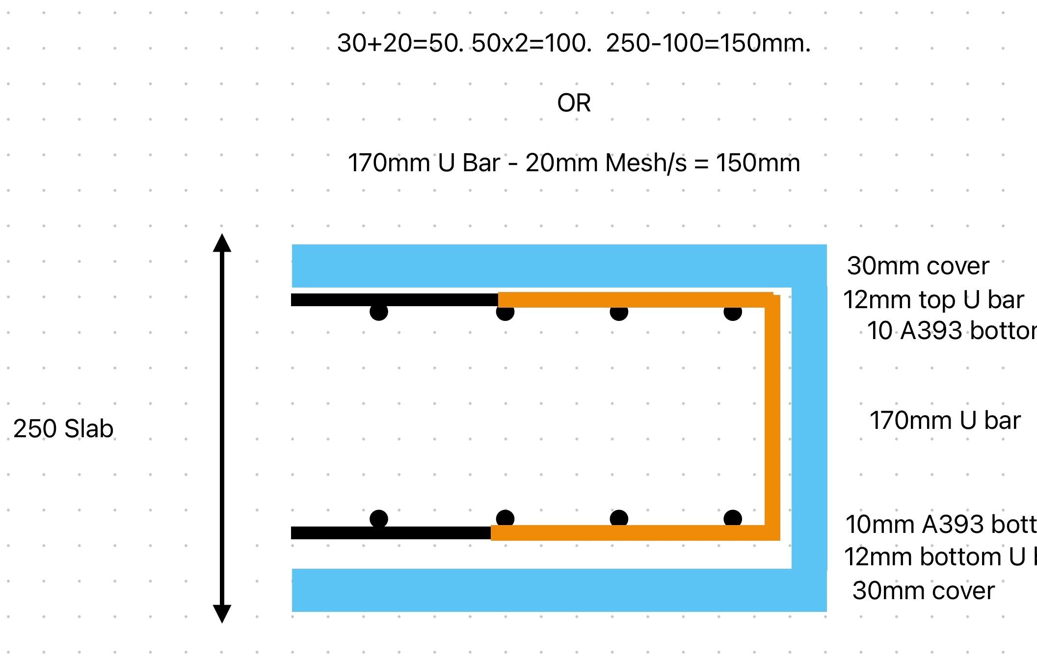

Ive got a 250mm deep slab foundation which has been specced by my SE to have 2 layers of A393 mesh Top and Bottom.
Ive also got 170mm U bars around the perimeter and its at this stage that I'm struggling to understand how I install the U bars to ensure I keep the concrete coverage correct.
Slab make-up is:
30mm Bottom Cover (Spacer)
A393 Bottom Layer:  20mm (2 bars in sheet:  long and lat)
U Bar:  H12 170mm  (150mm High Chair inside this)
A393 Top Layer:  20mm (2 bars in sheet)
30mm Top Cover
SO if I add up the math:  30mm+20mm+170+20+30= 270mm   too high....
Therefore I assume that the U bar must sit alongside one bar of the A393, thereby reducing the total height by that one bar of mesh (both on top and bottom layers).  So, 30mm+10mm (1 bar on bottom mesh)+170+10(1 bar on top mesh)+30= 250  and the 150mm high chair would span the 150mm between the 2 sheets......  This seems logical...
HOWEVER if i have U bars around both sides of the mesh (perimeter of the foundation) the U bars on the x/y axis will then hit the horizontal bar...  So the u ar can sit alongside on the one axis but not on the other....???  Does this mean I have to place the u-bar that fouls the mesh below the A393 mesh....
Ive resorted to getting lots of pencils and pens and trying to work out how I place the U-bars along both axis (length and width of slab) to work out how the u bar placements change the total height and also impact on the High Chair height.....
I'm due to start laying the steel tonight and would appreciate any advice.......
Yes
Really they should have been 150mm U-bars so they can fit within the mesh layers. However, if the mesh are the same way up you should be able to slot them in on both orientations.
It's also not the end of the world if you angle them so they can fit in.

My sincere thanks George, I’ve been worrying about this day and night!

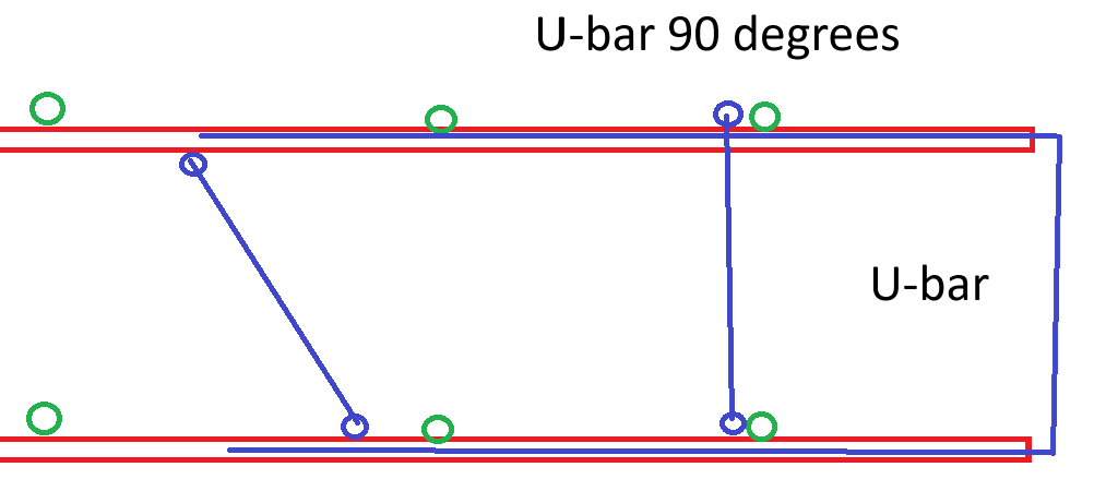

I assume the High Chairs would normally be placed right up to the edge of the mesh around the perimeter?  With the slightly off-set U bar heights (where it turns the corner of the slab, one higher than the other) if I set back the high chairs a little it’d ease the difference.  It was just a thought.
Posted
The high chairs are for within the mesh. At the very edge the u-bars will do the job of keeping the top mesh supported.

I had this problem, and there was a lot of "squashing" of high chairs and "fettling" of U bars. Alongside all of that I was fitting the UFH pipes to the mesh and trying to keep the whole lot with a 50mm coverage.
It can be done!! Take time to think through the laying of the mesh.
FYI - 2 layers of A393 is 30mm in thickness if you overlap them, not 20mm. If you get the overlapping at 90 degrees to each other that goes up to 40mm

Yeah although that's always an issue. If cover is tight you can do flying ends or use loose bars to lap the mesh layers.
