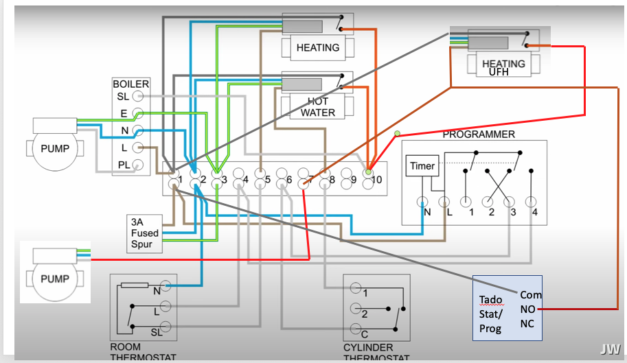

It's 2 55metre runs. My boiler is sat right above my ufh manifold in the same room. My main question is.... do I need the circulating pump on the manifold with it being connected to a combi boiler? And to run a thermostat on rad system and thermostat on ufh do I need 2 2port valves?
Off the combi you need the 22mm flow going into 3 tees, one to a zone valve for heating, one for the zone valve for Ufh, and the third for an automatic bypass valve ( ABP ) so the boiler can recirculate back on itself.
Room stat to the rad ZV brown wire, second room stat to the Ufh ZV brown wire. Boiler LS ( 'live send' on the WB iirc ) to both orange ZV wires, and both grey ZV wires to LR ( 'live return' ). The brown wire of the Ufh ZV also supplies the manifold pump.
The stat tells the ZV to open instead of telling the boiler to fire.
The ZV tells the boiler to fire so the boiler pump won't start spinning until the ZV is fully open and there is an open waterway.
As the boiler will do pump overrun, after the stats stop calling for heat / get switched off, you will need the ABP to allow the boiler pump to continue to spin ( against both shut ZV's ) back on itself to the boiler during those 2 mins or so of overrun.

  • 4 years later...
Hi Russ. That's a nice quick description which is just what I was looking for to help me out. I have a Vallaint ecotech plus currently running HW and CH on an S plan. Ive just had a single zone UFH installed in a large kitchen but not yet wired. It has a typical ZV, TRV and APB set up. To give the engineer who is doing the wiring a running start I did some research on how to integrate my Tado system and it seems fairly clear and your description gave me the final clue. I was wondering if the manifold pump should be fed by the UFH Tado wired thermostat or the ZV orange wire. You say brown wire meaning the manifold pump will run as soon as the Tado UFH thermostat demands heat. See my diagram, my wires are the wonky looking ones! The only question I have is that this means in a situation where the UFH TRV does not need any hot water and is closed and the CH ZV is off BUT the UFH Tado thermostat IS demanding heat the Boiler pump may well run which will force flow either through in the internal boiler APB of the external fitted one. It seems that you think this is not ideal but acceptable? I thought the APB was kind of for 'emergencies only' but here it may be used much more frequently. Can you advise on what bypass pressure should be set at please or how I can figure it out. Many thanks! I have yet to understand what a buffer is but thats my next research as I dont have one...
