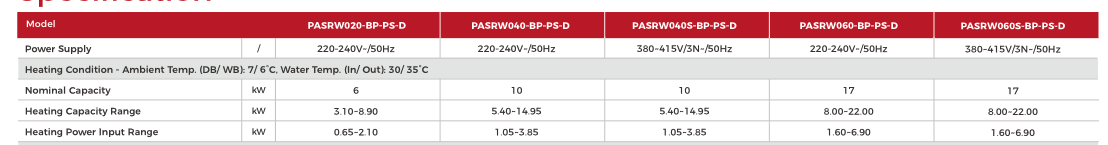

OldSpot Posted May 4, 2024 Author Posted May 4, 2024 Can someone help me understand these figures please? For example, the first model says at an ambient temp of 7/6c and a water in temp of 30c and out of 35c, it has a nominal capacity of 6kW but it also has a heating capacity range of 3.10 - 8.90kW so can output more than the nominal by 2.9kW..? Presuming there is a direct relationship between Heating capacity and Heating Power Input? i.e Input = 2.10kW, Output = 8.90kW On the MCS product pages, they list an SCOP at different flow temperatures - what ambient temperature is this measured at and is there anywhere to see the SCOp at different ambient temperatures. On 02/05/2024 at 19:12, JamesPa said: Performance tables pretty useless and show large fall off below 7C (data given only at 7 and -10). Expand How did you determine this James? Many thanks.
JohnMo Posted May 4, 2024 Posted May 4, 2024 On 04/05/2024 at 14:37, OldSpot said: 7/6c and a water in temp of 30c and out of 35c, it has a nominal capacity of 6kW but it also has a heating capacity range of 3.10 - 8.90kW so can output more than the nominal by 2.9kW..? Presuming there is a direct relationship between Heating capacity and Heating Power Input? i.e Input = 2.10kW, Output = 8.90kW Expand The manufacturer has chosen a stated nominal capacity of 6kW, but at that OAT and flow temp it could output up to 8.9kW and down to 3.1kW, another manufacturer may say it's rated at 9kW and can turn down to 3.1kW. at -10 or -20 it may only output the nominal 6kW. SCoP is seasonal performance, so over all temperatures seen in the heating season - CoP is at a given OAT temperature. On 04/05/2024 at 14:37, OldSpot said: Heating capacity and Heating Power Input? i.e Input = 2.10kW, Output = 8.90kW Expand Divide 8.9 by 2.1 to get the CoP so 4.2 at 7 OAT and 35 deg flow temp.

JamesPa Posted May 4, 2024 Posted May 4, 2024 On 04/05/2024 at 14:37, OldSpot said: For example, the first model says at an ambient temp of 7/6c and a water in temp of 30c and out of 35c, it has a nominal capacity of 6kW but it also has a heating capacity range of 3.10 - 8.90kW so can output more than the nominal by 2.9kW..? Expand Yes. Nominal capacities are a bit meaningless. Heat pump capacity varies with oat and ft and you need to make sure it works at your design oat/ft (and also that it will go low enough to cover the OAT that is more common) There are detailed tables for most heat pumps, including this one, which tell you the actual output at a variety of ft/oat combos
