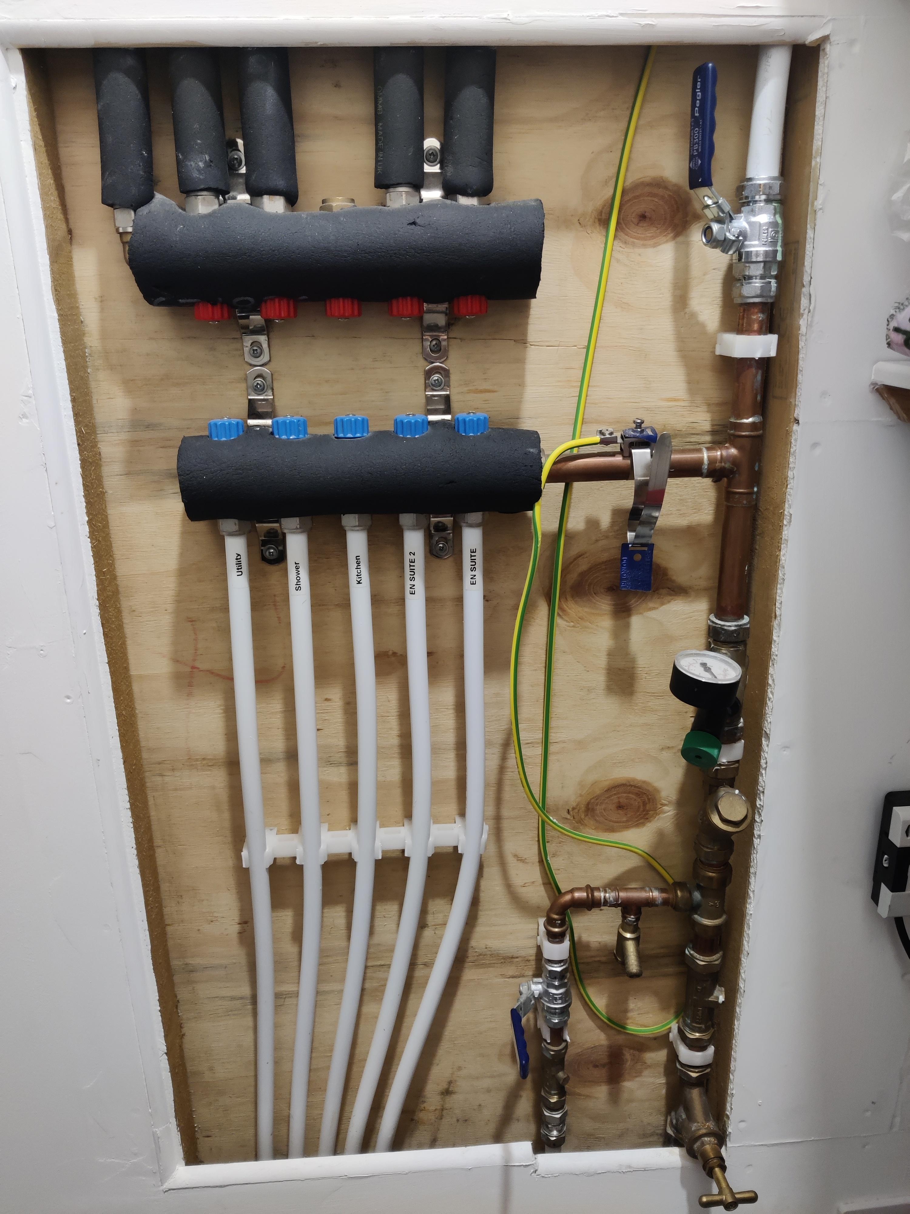

We have a temporary water supply at the moment and about to switch it over to our final connection.  We have a meter on the boundary so it's a straightforward 32mm MDPE run from this, through a duct and into to our plant room.  Can't quite agree with myself on the best way to supply our external taps.  Ideally we'd like 3-4 taps dotted around the building and up at the furthest corner of our plot.
I could branch off the 32mm MDPE and run to all tap locations - but how do I handle isolation/freezing/drain-off?  The tap uprights visible on the building are like to be copper to keep them a bit more subtle, so could be prone to splitting. Thought about installing an extra access box to allow for access to an MDPE isolation valve, then just open all taps? Or is a drain-off practical? I guess double-check valve on the branch would then just be buried.
Alternatively, I thought about putting the branch/isolation/drain-off port in the plant room, and then running a second MDPE back out through the duct to all the external taps.  But feels a bit awkward!

Our water comes into the house through a duct under the foundations. Up to the stop cock, prior to any pressure reduction the pipe takes a turn left and down to its own isolation and the down through the same duct and then up to the outside tap.  Stop cock stops all water flow, and outside tap has its own isolation also.
This is what I have in my notes;
32mm external MDPE, into Plasson stop tap, convert to copper, double-check non-return valve, drain valve, (PRV if >5 bar), external taps (with isolating valves and non-return valves), then 28mm copper on to all the internal feeds (UVC, hot manifold, HRC manifold, etc.)
EDIT - just found a question I still haven't resolved; should PRV come *after* feed for external taps? Maybe someone else can advise on that one and I can update my notes with the answer! 😉
Yes
Thanks @JohnMo - I originally had "32mm external MDPE, into Plasson stop tap, convert to copper, double-check non-return valve, drain valve, (PRV if >5 bar), external taps (with isolating valves and non-return valves), PRV, then 28mm..."
So the PRV came after the external taps. I removed it because I'd at some point I added the (PRV if >5 bar) and assumed it was a duplicate, but perhaps it's both?
Is there a reason to keep the external taps under 5 bar pressure?
