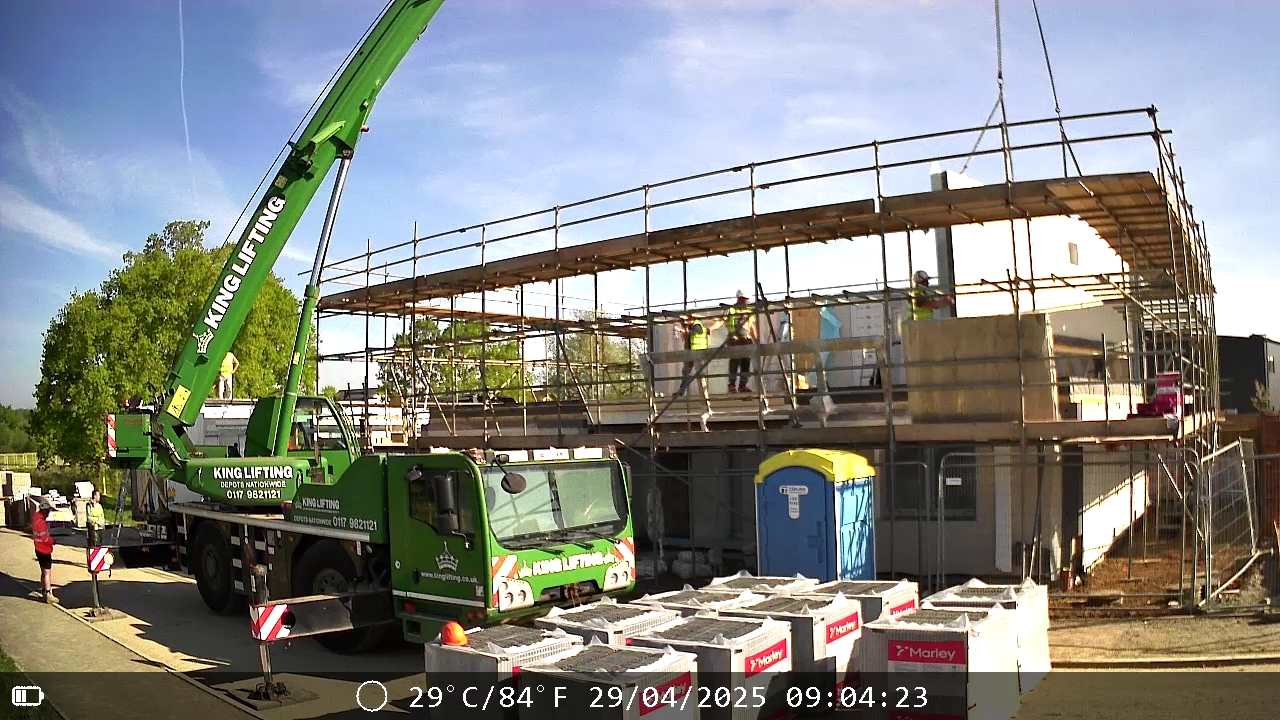

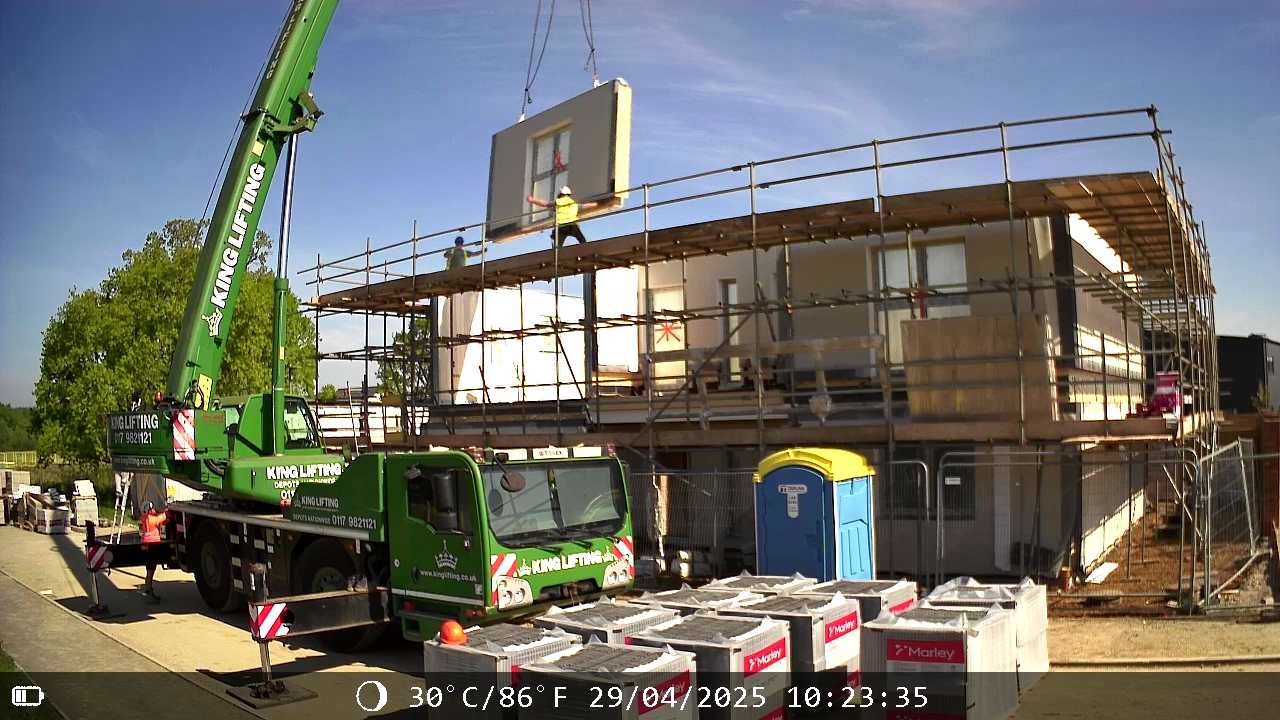

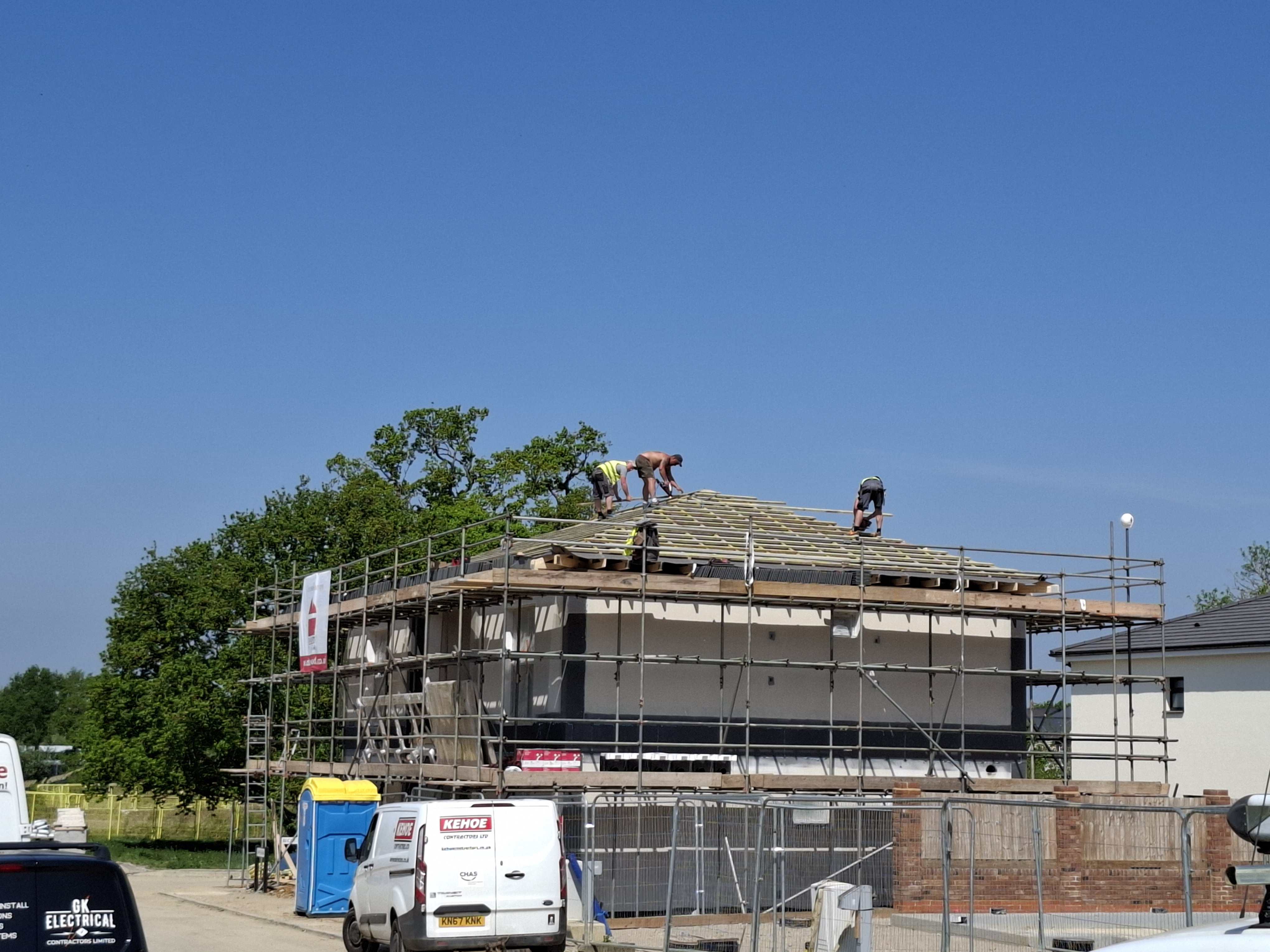

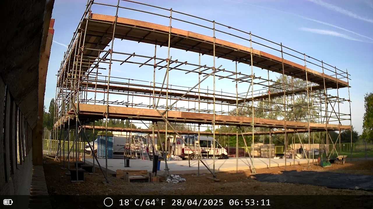

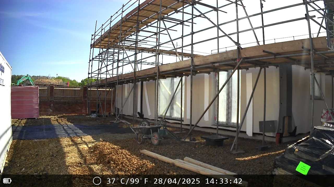

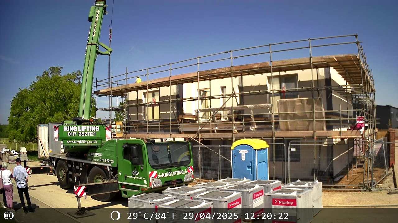

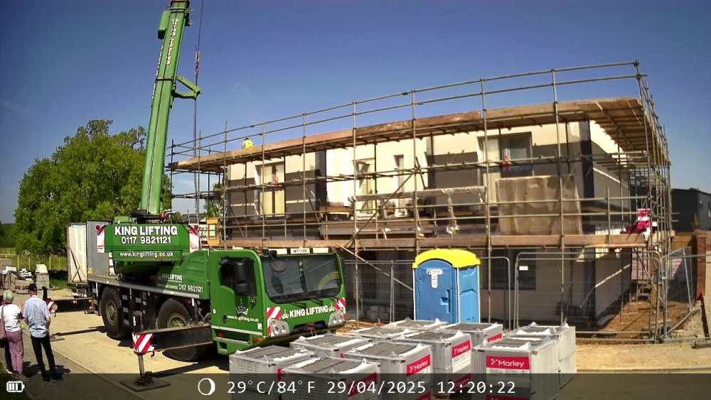

RCbuild Posted May 2 Posted May 2 So from ground up ie not for land or foundations our house for Approx. 200 Sqm, 4 bed, 4 bathroom, ASHP, underfloor heating and balcony with standard finish was £320k we up specced ours to £380k. Excluding a kitchen. Their factory is in Poland they produce 2,000 houses per year mainly for the continent it is a manufacturing operation rather than a builder. The same assembly snd finishing crew move from house to house. Photos of ours delivered on Monday 28th April up to this morning.
