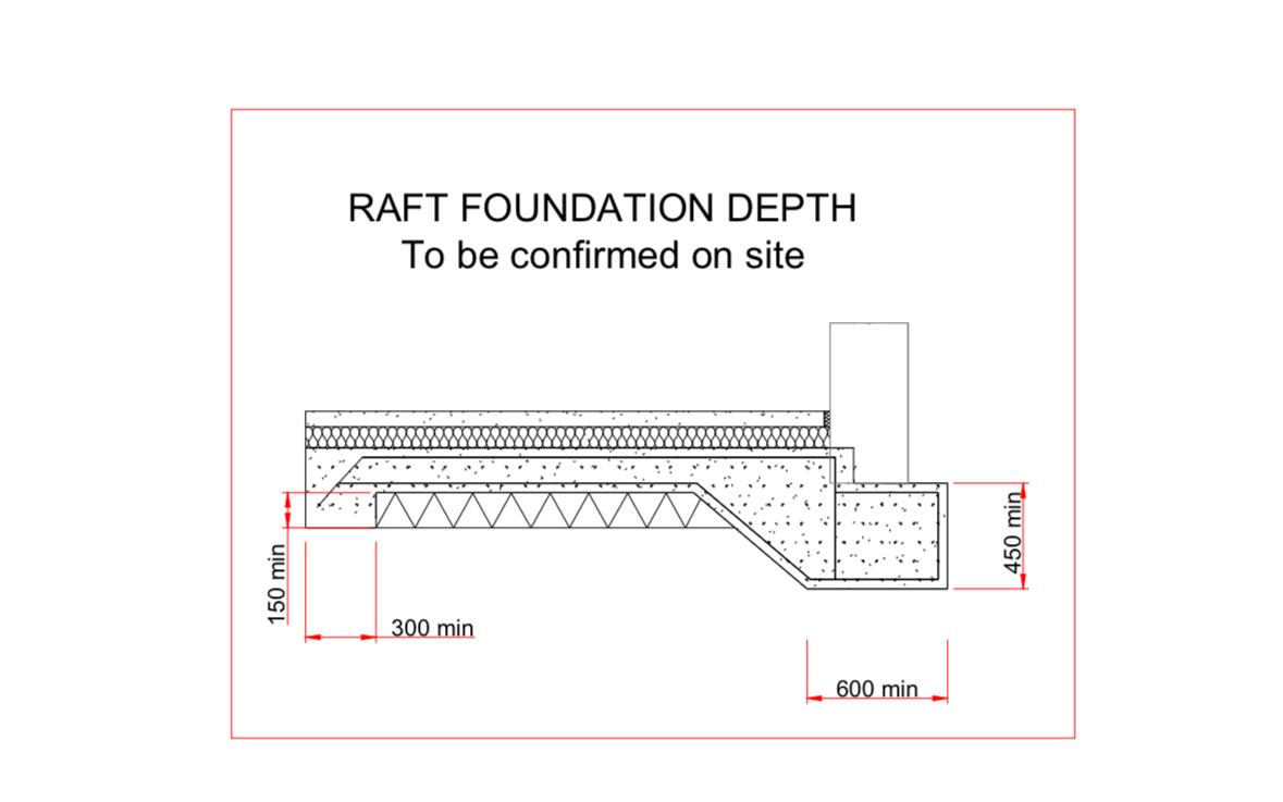

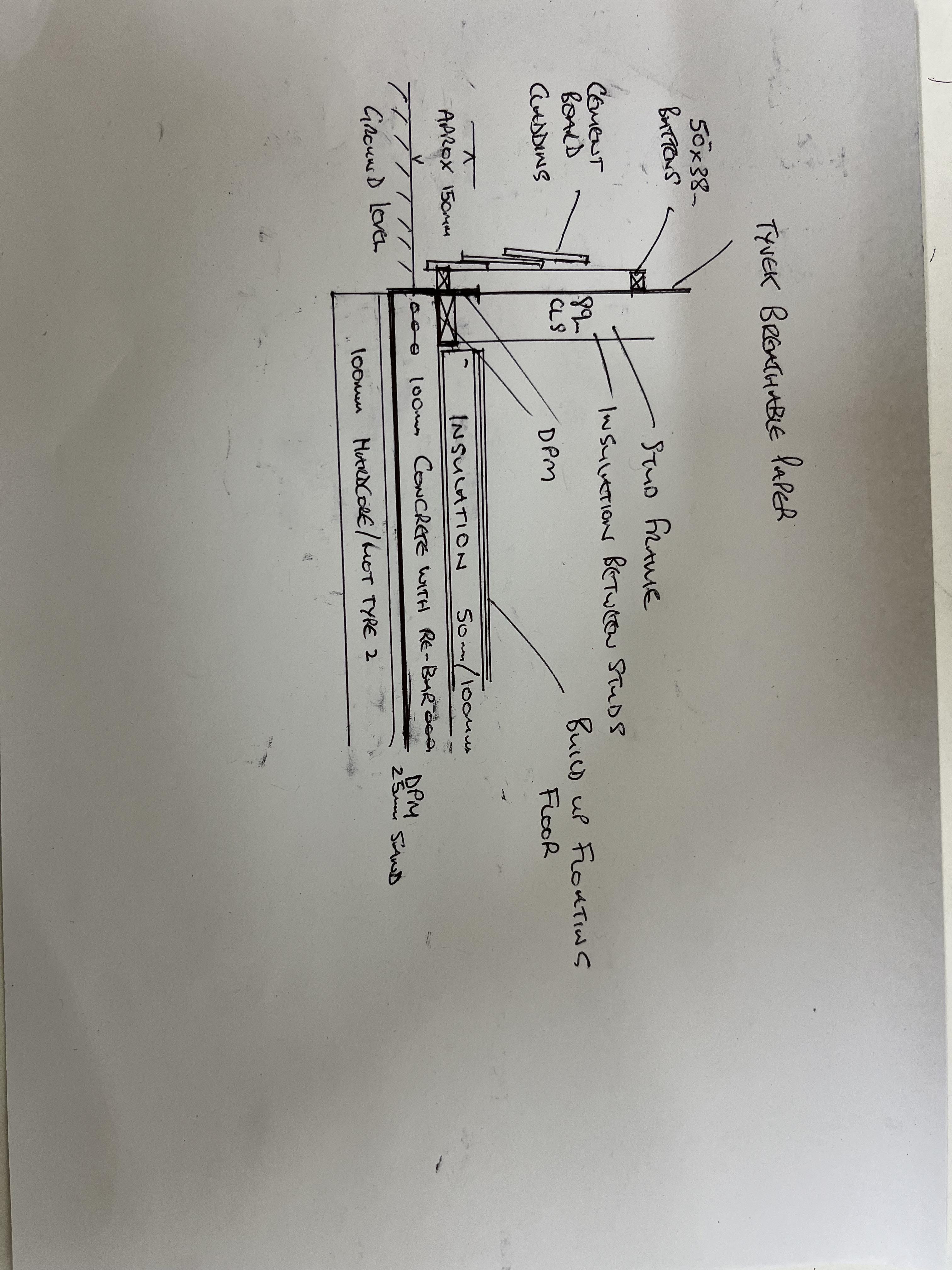

I’m not sure how to introduce but I’m just going to blurt it out… looking at doing a garden room and my architectural technician has designed a raft foundation for me but I still seem to be at a loss on how to go about it.
the raft foundation design to me seems OTT for a timber frame garden room but then this is not my area of expertise so…. Advice please.
to me it looks like 150mm insulation under the raft going to 100mm under where perimeter frame sits (with concrete going other way 100mm to 150mm). Any advice would be most appreciated

You are going passivehouse for a garden room? I'd buy a kit like JohnMo says and sit it on a reinforced slab. At 20m2 it'll be exempt building regs if you keep it away from the boundary.

How much will it be used ?, if very often/long hours then maybe worth insulating but if not then heating it for short periods will be fine IMO. Yes that slab looks OTT to me.

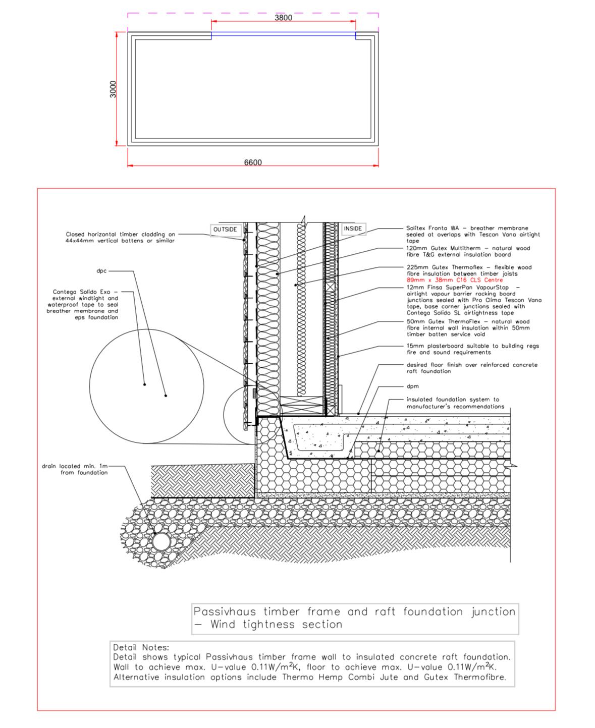

Holy smoking woodfiber Batman! That is one hell of an install.
U Value about 0.1 on the wall. Top shelf products from all the premium players. Gutex, pro clima. For giggles I'm going to price it up without the cladding and plasterboard as you'll need them anyway.
Solitex contega = £5.90/M2
120mm multitherm= £39.44
225mm thermoflex =£39.77.
Studs £8/M2
Finsa board £12.51.
50mm Thermoflex £8.76
Tape £3/m2
Service cavity battens. £2
Total £119.38 plus vat and with zero waste. GULP. I do like this type of wall but it is unfortunately just so so dear.
Amusingly every single product was available from this website.
https://www.ecologicalbuildingsystems.com/
I wonder how much homework your architect actually did and how much they copied from elsewhere.....
Yes the whole thing the more I look online feels like a copy and paste job with like you say one site conveniently having all listed. Way over engineered too and is giving me a head ache.

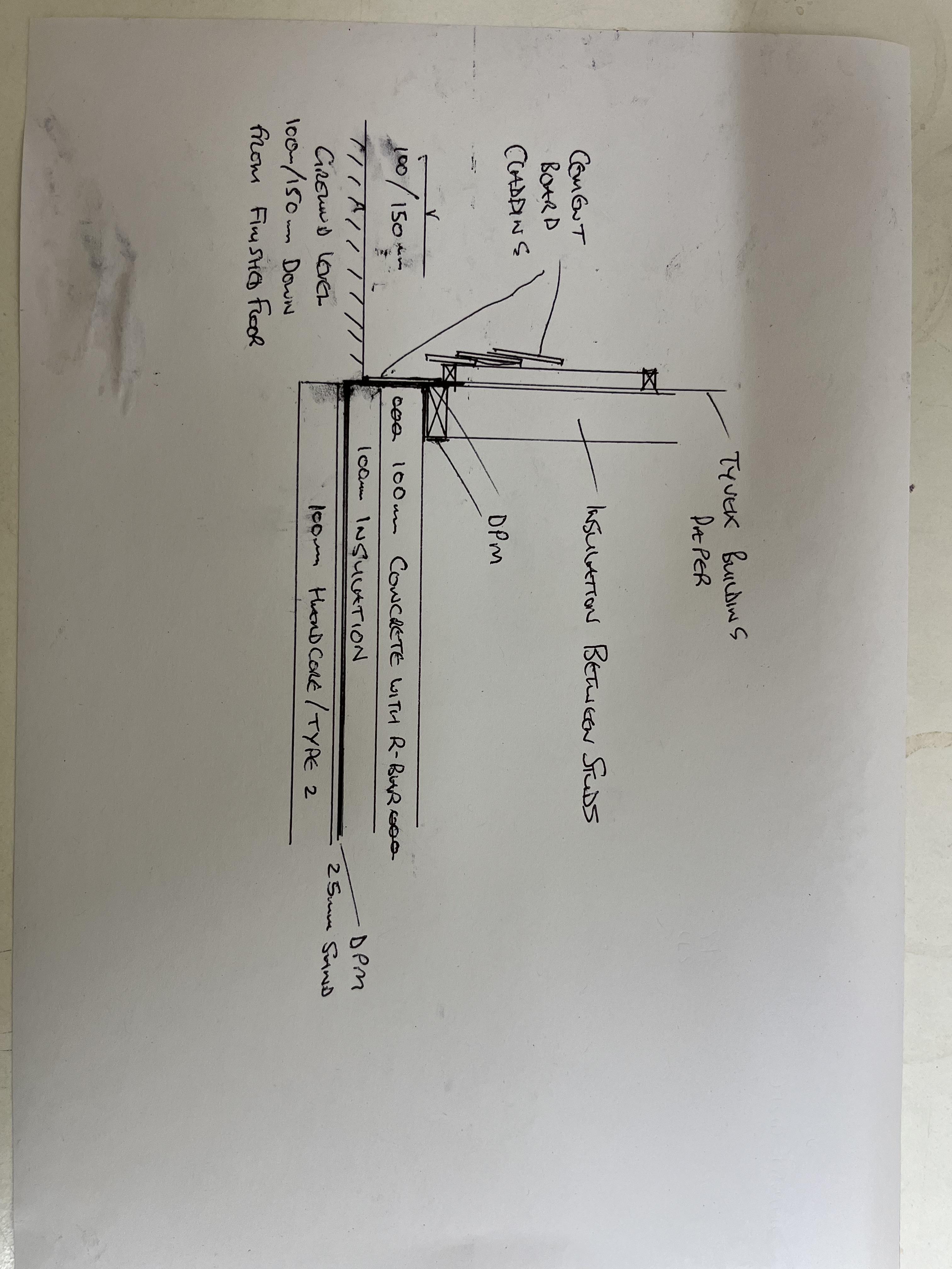

My view to the wall profile is as attached with 90mm rigid insulation inside timber frame then service batten & 15mm board.
Building control said the architects drawing looks “robust” lol! I briefed him that I didn’t want to spend the earth too. Cost me £600 so far for his services which also includes submitting planning application.

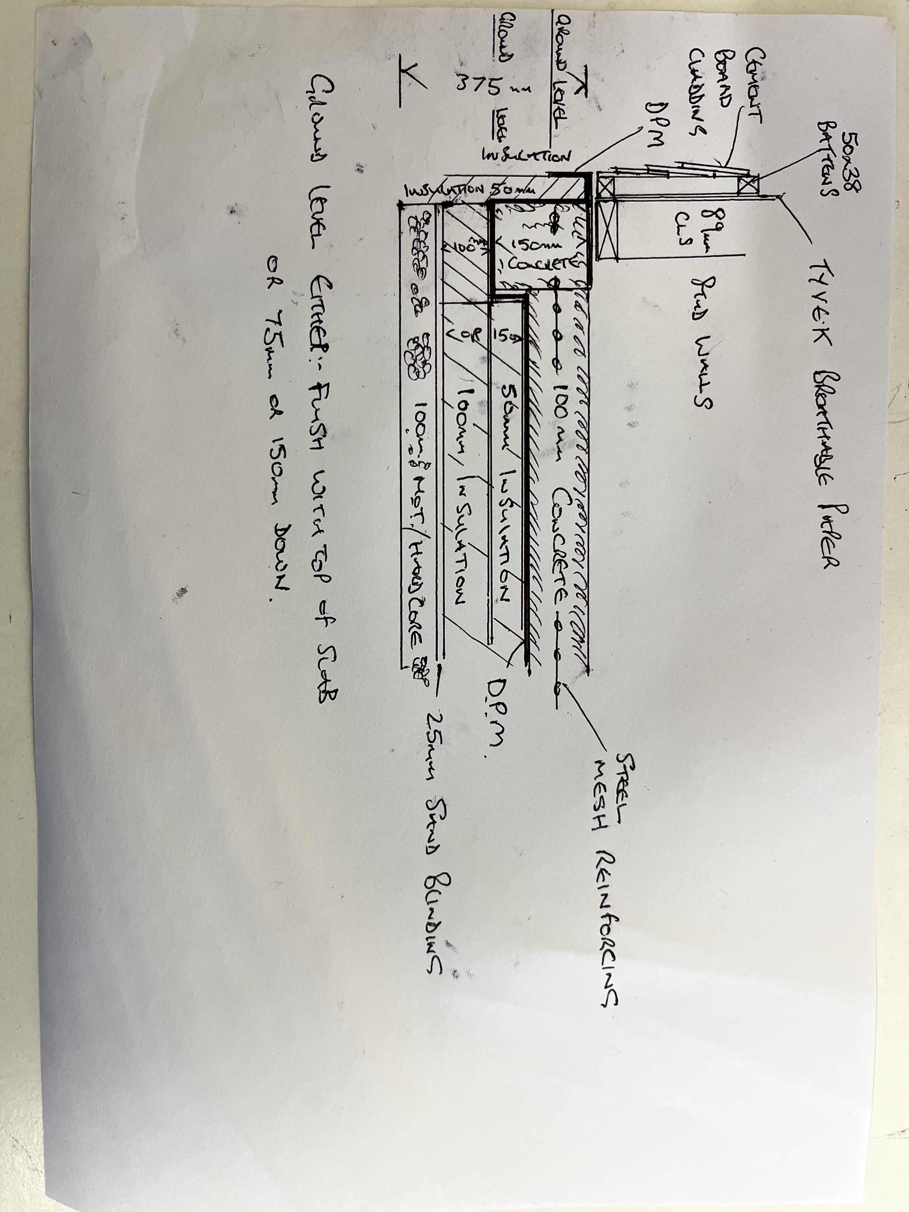

Back to the base, my original thoughts were to having 100mm mot, 20 - 50mm sand blinding, 120 pir insulation with 100mm concrete slab to top with which the timber frame would sit… But I don’t think this works and you need ffl 150mm above ground level which eats into head room to stay under 2.5m… so my current thoughts are as my drawing.

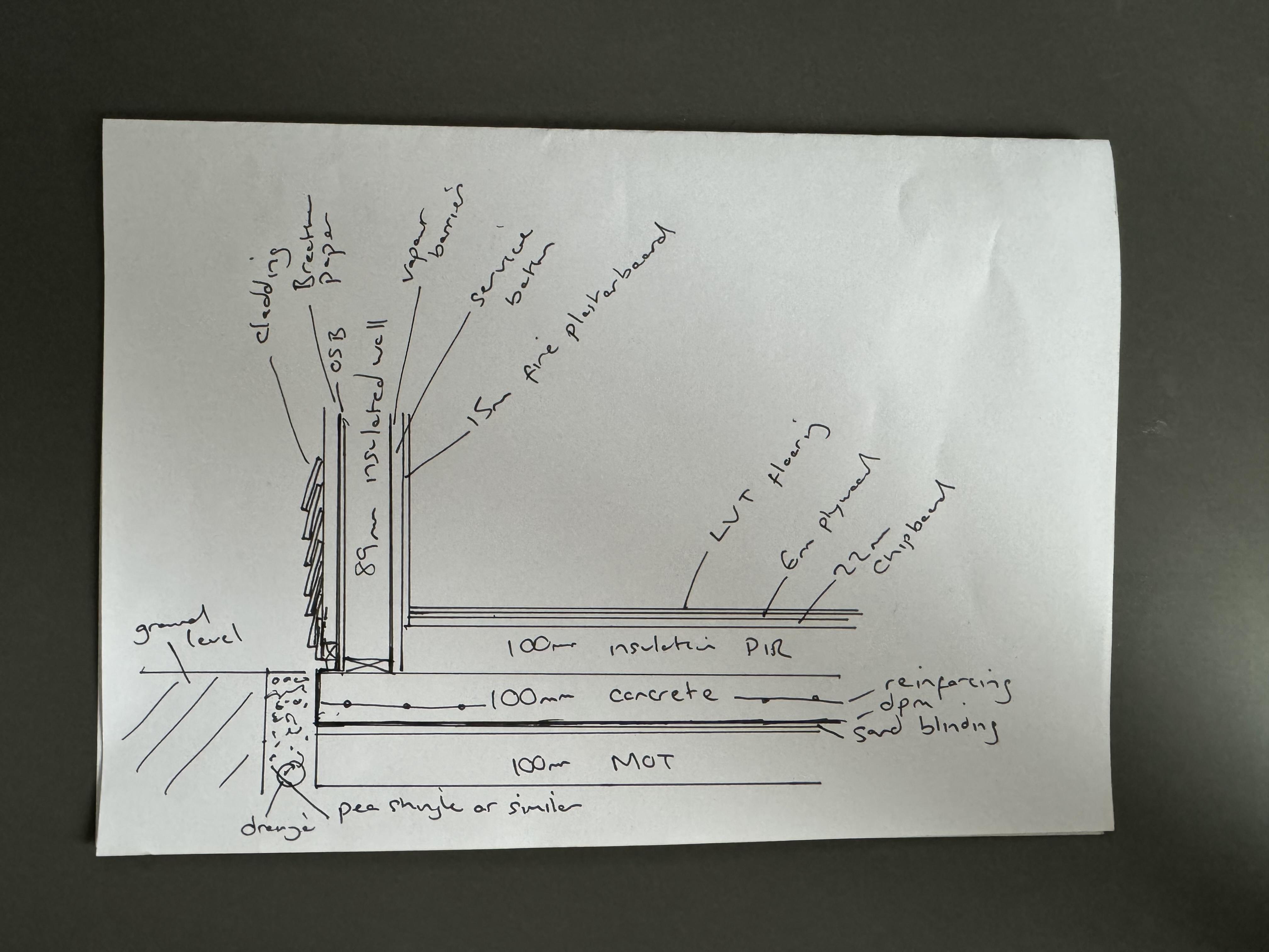

I built a garden building for my wife's business, she uses it for 2-4 hours a day max all year round. I went waaaaaay simpler than your architect, and did it all within PD so no planning required.
For floor I did 100mm reinforced raft over 100mm MOT, and then floated 100mm PIR over the top with floating subfloor on that. The walls sit directly on the concrete, with the PIR inside the perimeter. 2x4s infilled with 100mm PIR.

Oliwoodings, yes that’s definitely what Ives been looking at for concrete floor… concrete then insulation on top. Did you do your slab level with ground then end up with 150mm ffl above ground?
The walls this is also pretty much my thinking 4x2 insulated with pir, service batten then fire board inside and batten then cement board cladding outside.

Yes I did the foundations level with the ground. Only mistake I made was oversizing the slab compared to the wall perimeter due to changes in layout. This meant bits of my slab stick out under the walls, creating drainage issues. So, just make sure the slab is sized correctly and built correctly!

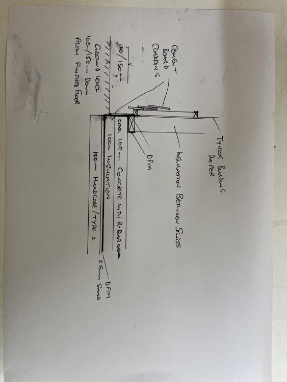

I'm still unsure to be honest on slab design, either insulation above or below concrete slab (obviously original plan is below albeit OTT)... so either 150mm insulation below slab or 100mm insution above (i know its different types of rigid insulation also). I thought with slab (with insulation above) you are suppose to go 50mm bigger than where you plan to sit your wall plates for strength or does that not matter as its reinforced concrete slab - plus the external batten then cladding will take up the 50mm anyway.
Im just looking to get max headroom and i know you suppose to bring your finished floor up 150mm above ground (got to stay below 2.5m)
The wall design i'm definitely going to go with insulated 89mm timbers with service batten on inside.
In my head how insulated above slab will look though maybe move wall to edge of slab
so got to decide which
Two drawings showing (ignore the first can’t seem to edit it away) under slab insulation and over slab insulation (dpc under timber frame)
