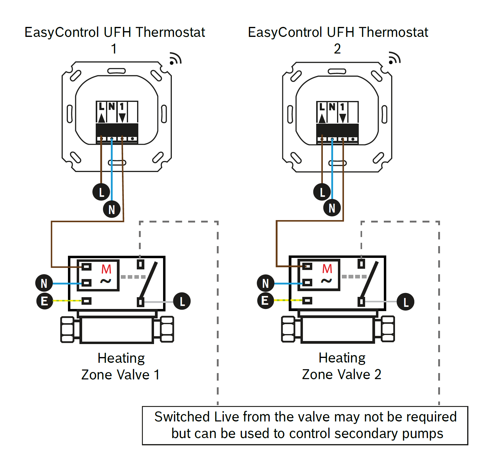

Hi all.  Thanks for the pointers.  We needed to make a decision quickly so I have chosen the following.  I'd appreciate your comments even if you think I've done the wrong thing.
Worcester 4000
Zoned via manifold to upstairs, downstairs and new underfloor extension
Zones controlled by EasyControl 'stats
Priority hot water (fairly sure this will run the boiler as full chat so must be timed outside heating demand)
No smart TRVs
One of the drivers for the EasyControl system was the 10 year cover when fitted alongside the boiler.  The plumber assures me this setup will have full modulation for heating.

Just so you know, you will not get what you're after using the EasyControl. Re how EasyControl does zoning and modulation, read this:
https://www.worcester-bosch.co.uk/professional/news/smart-heating-gets-smarter-with-zoned-heating-control
It only does zoning with the smart trvs.
How is your plumber going to implement Worcester PDHW with the optional diverter valve kit and zones using motorized valves? Ask him or her to explain it to you in detail before parting with your money. Get them to show you the wiring detail in the boiler installation instructions and the EasyControl instructions and the diverter kit instructions.
It's not about the wrong decision as such, it's about whether you're actually going to get what you think you're going to get.

Okay, I think a little further explanation is needed here.
When you install the hot water priority kit for a WB boiler you also install a DHW cylinder sensor which signals to the boiler when it should ramp up to high output. The EasyControl is wired into the EMS low voltage connector on the boiler, which controls modulation. To make this work, you then bridge the 230v high voltage switched live connectors so on that side the boiler is seeing constant demand.
If you install motorised valves and a UFH manifold with a pump, these are wired up to the boiler using 230v so that when the motorised valve is open, it switches 230v to the boiler's 230v switched live to make it work. Now, this setup doesn't work when you have the switched live bridged as per above. On Opentherm systems, the Opentherm controllers handle the 230v switch and then send the relevant signals to the boiler low voltage Opentherm connectors and on some controllers like the EPH ones, you can connect the DHW and CH receivers together directly using 230v switching to provide priority hot water.
Now, the WB EasyControl and the WB 4000 does not have the capability to natively handle the 230v switching while also providing modulating control, which is why WB uses smart TRVs to handle zoning and modulation.
So unless WB has devised a new add-on or changed the product in the last couple of months since my last detailed conversation with WB technical department about EasyControl and zoning with zone valves, you're still not going to get what you think you'll get. By far the best way to use EasyControl is to have one zone and the PDHW optional diverter kit and you can then run weather compensation and then, if necessary add zones using the smart trvs.
With your plan, you will have a 'smart system' but that just means you can control it on your smart device, it doesn't mean intelligent modulation.
If you still don't believe me, call WB technical and ask them about 230v switching with EasyControl and modulation.

@SimonD thanks for the detailed description. We have weather compensation and priority hot water. How this is achieved I need to find out. The boiler is in now so we are very unlikely to change it. We still have the option of adding smart TRVs if that would help but I suspect not going on your description of how it works above.
The plumber assured us that we are getting a modulating system so I am quite annoyed if we are not. It is likely to work and will be better than we had before but one of the reasons to get a new boiler was to go away from relay control with the hive thermostat.
I will ask the plumber about the system and get his thoughts.
Thanks again.
Having a read in a few places with your info in mind....
Is the bridging only a requirement for priority hot? If I disable/remove that feature would it modulate as planned even with the 230v motorised valves?
We are on cheap night rate with solar diversion get much of the hot water from electric. If we remove the requirement for heating the hot water with the boiler could we get a modulating CH system?

I have been reading this discussion and wanted to know are these Smart Individual Room Thermostats giving you full modulation via your CT200 Easycontrol? I am assuming you have these via 2 port zone valve? Are you using these for your central heating or underfloor heating?
These thermostats use RF signal and connect to Easycontrol so they must be doing modulation from what I can understand.  I was hoping use these to zone a central heating system instead of using smart eTRV's
I have a Worchester 4000 series system boiler with PDHW (4 pipes integral diverter valve)

Hi
Sorry I only just got back to this as not used build hub for a while. As far as I can tell yes we are getting modulation using the zone valves and the room stats.
However, the guys above are correct, we don't have hot water working properly. As we have the immersion working with solar and cheap night rate we have lived with it so far.  It our mission after Christmas to get it fixed which I think with all least involve a new control setup. Maybe even a rewire or replumb.
