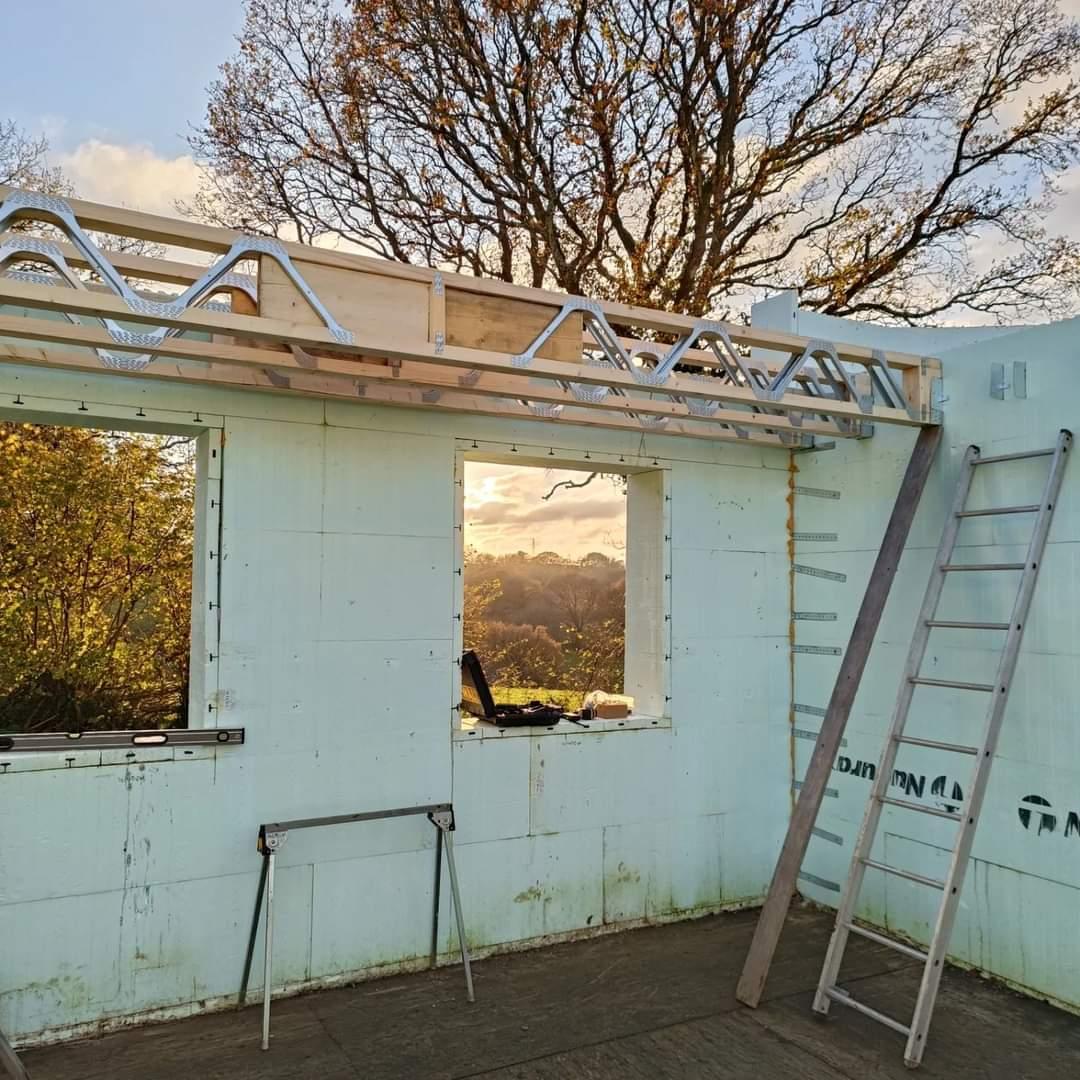

BotusBuild Posted April 22, 2024 Posted April 22, 2024 In the picture you will see the opening for windows created in Nudura walls. As I approach plaster boarding, thoughts turn to the traditional wooden window cill at the bottom of each window. Am I safe to presume that I can attach the cills directly to the Nudura, with nothing else in between.
Russell griffiths Posted April 22, 2024 Posted April 22, 2024 I found that scratching it up and putting a coat of render on them, then any glue you use will stick better.
