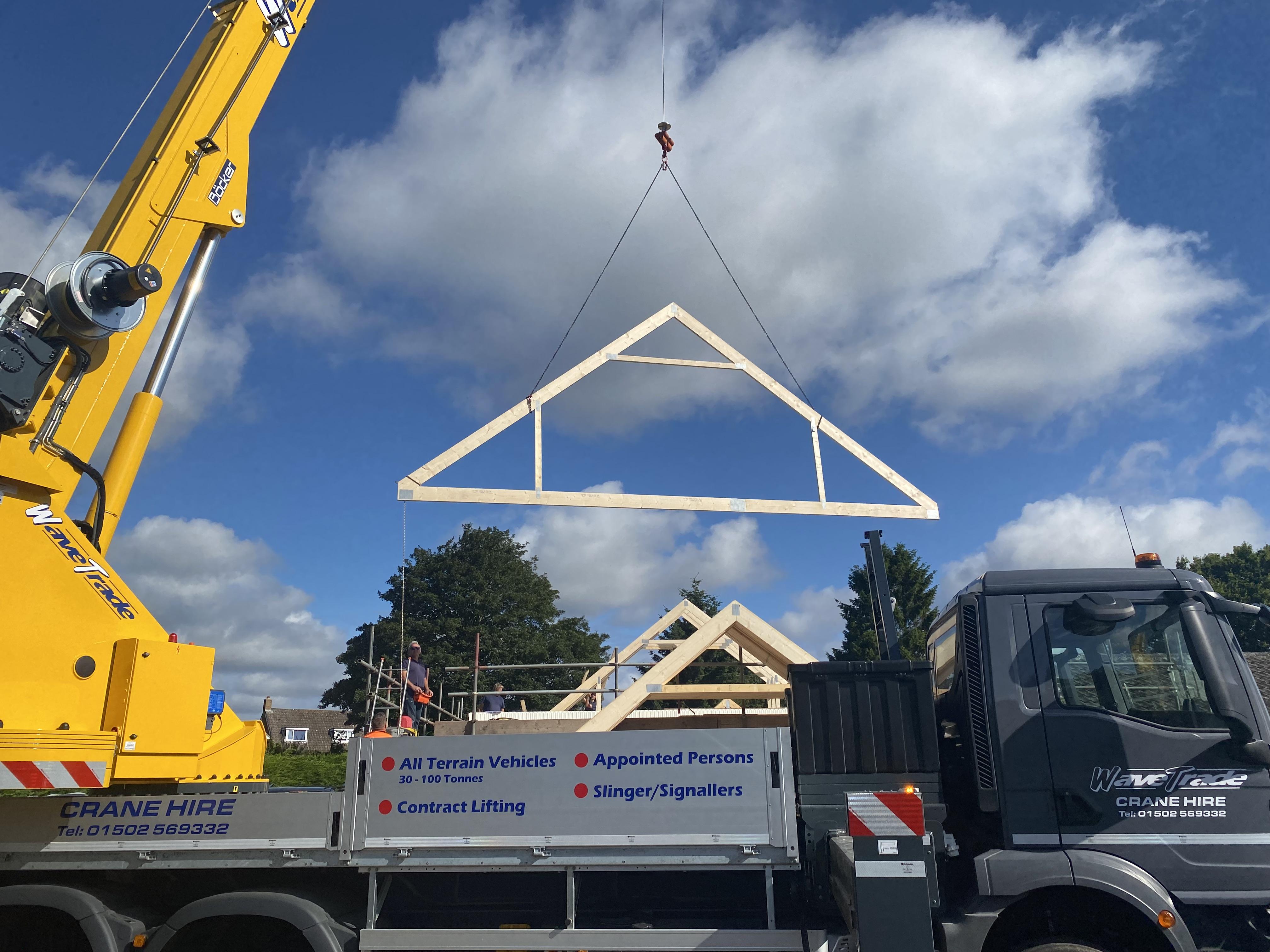

Ours were similar size and slightly heavier at 136kg each, I would not want to lift by hand, so hired a crane. Trying to manoeuvre trusses that size by hand could be dangerous.
The carpenters fitted all 24 attic trusses and 12 raised cord trusses in one day.
We did the raised cord trusses by hand but they only spanned 5m. But they were lifted onto the wall plate and lent against the scaffold with the crane.

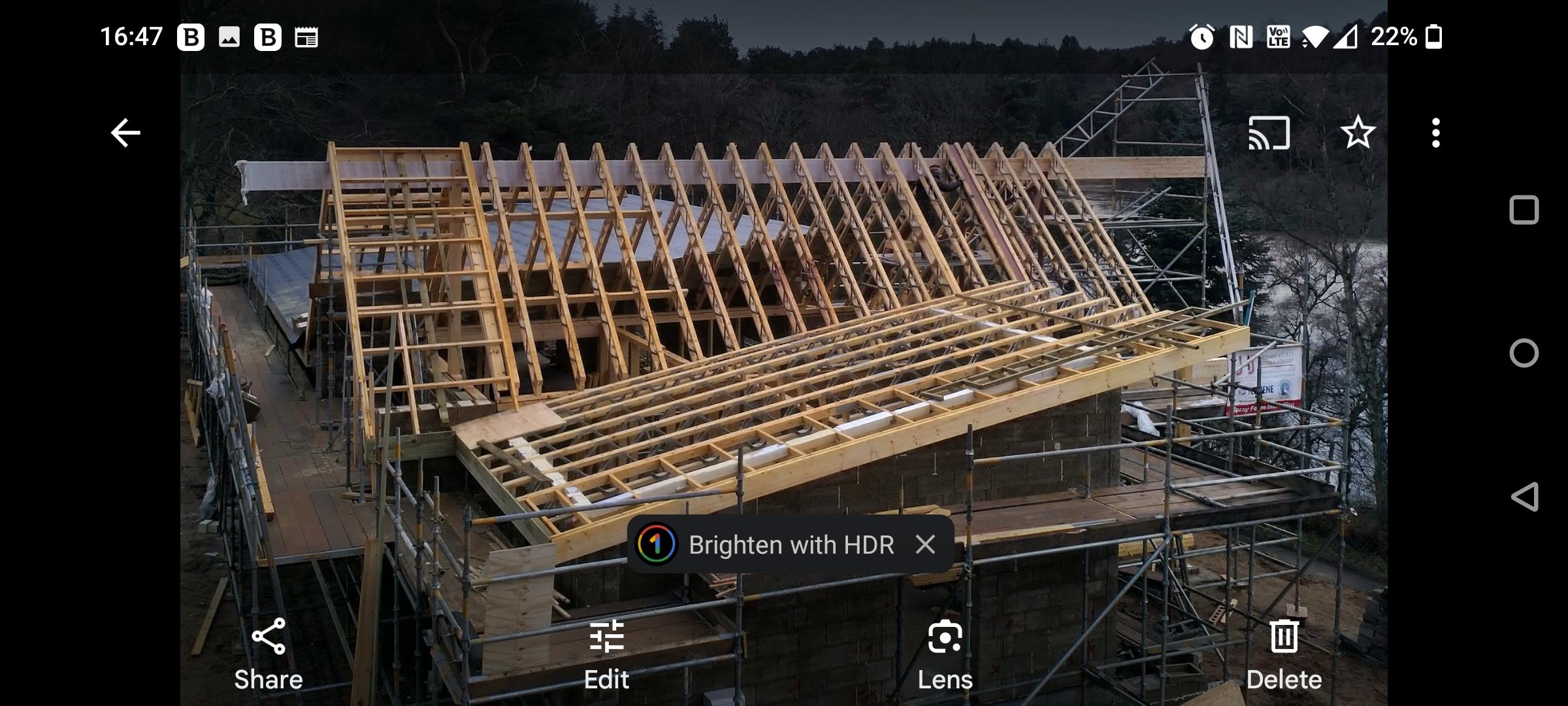

We’ve lifted our trusses between three of us on our previous build 12 meter span Pouring rain All on the day
You will need an easy rout up and over the scaffolding I had to cut four poles inline with the handrail
