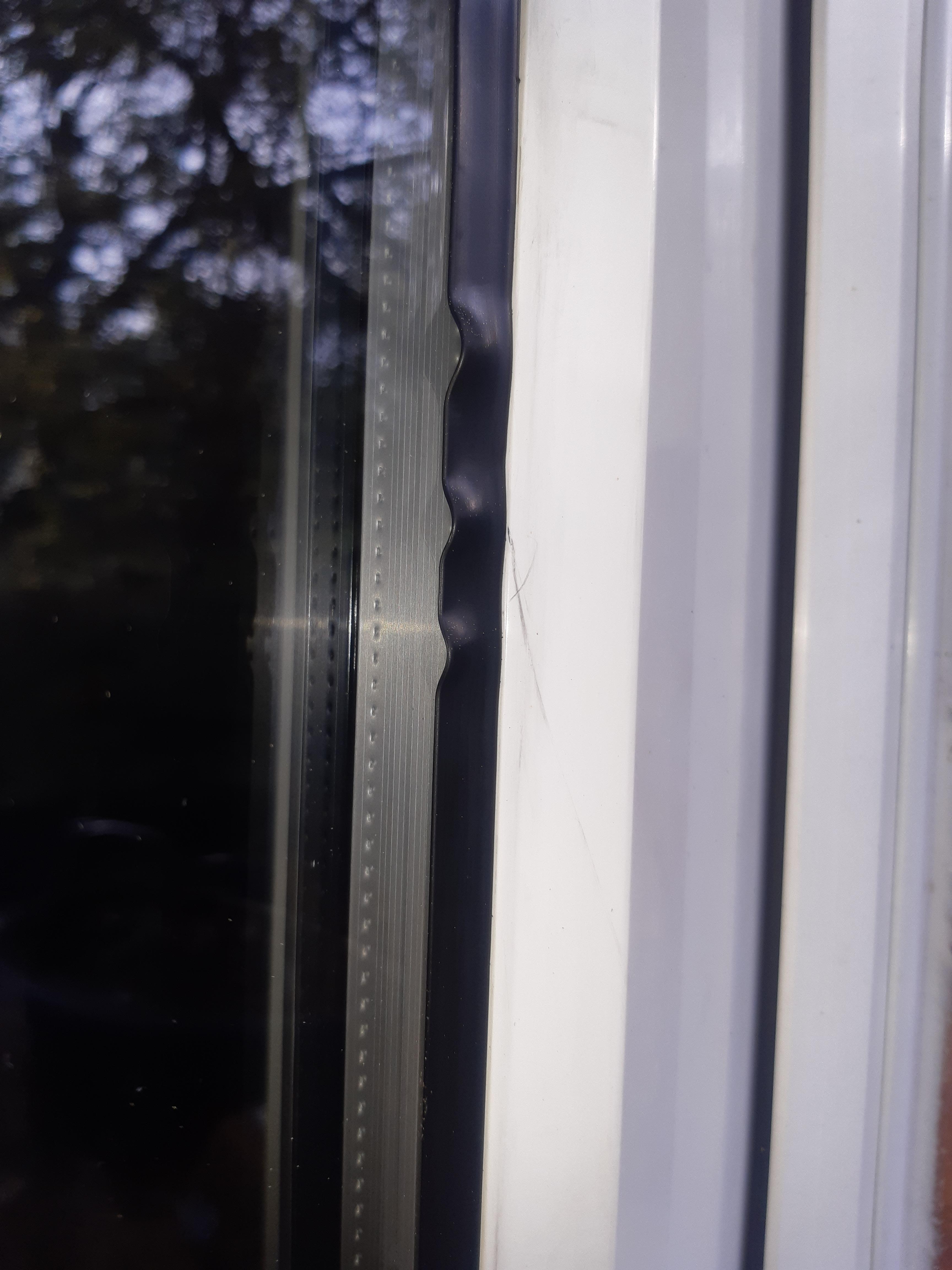

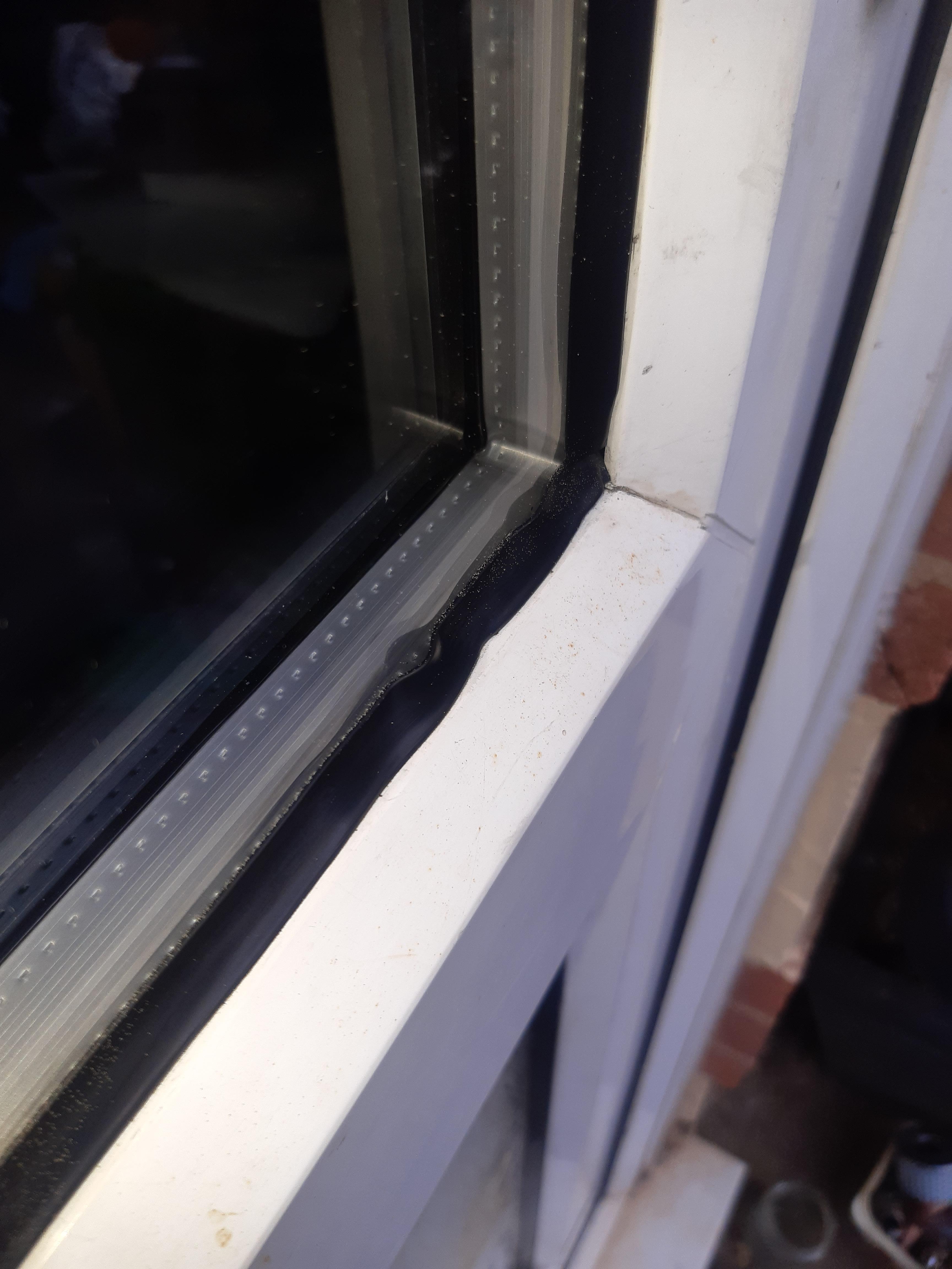

The new units made, I again hook out the rubbers, then take out the internal beads. New unit fitted and trims in, rubbers last. What a pig,   ten times worse than when I first did it! I've made a hash of if and in places the rubbers are irretrievably distorted. When I removed / refitted the second time the ambient temperature was warmer. I even used some silicone spray to help ease things in and worked my way along pushing the rubbers in with a screwdriver. New rubbers are the only option.
What did I do wrong?

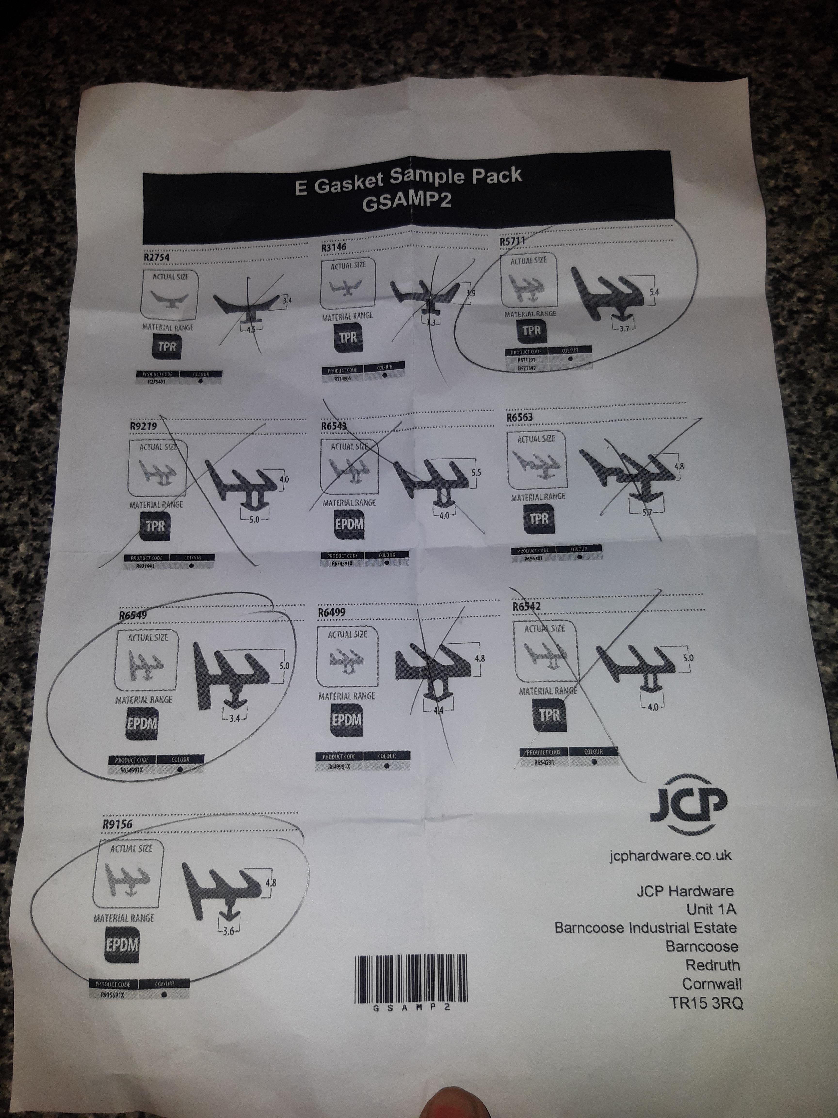

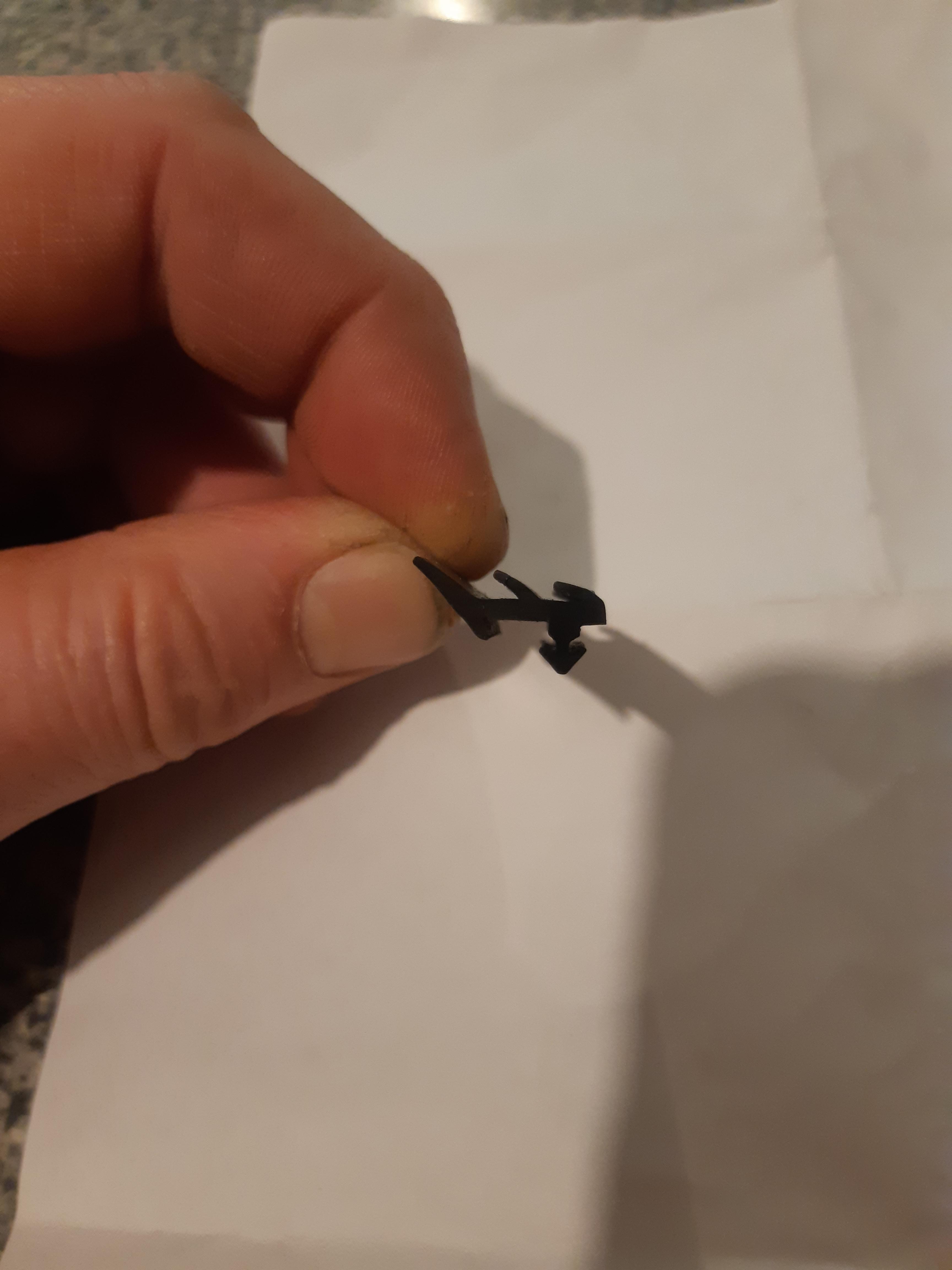

I'm also having trouble matching the profile despite having ordered a sample pack off eBay:

2 hours ago, dpmiller said:
so is it likely your spray lubricant has swollen the rubber?
Dunno, someone else said don't take the rubbers out!
So I took the windows out, clipped the rubbers back in, put the units in and banged the trims on with a rubber mallet. All good.
