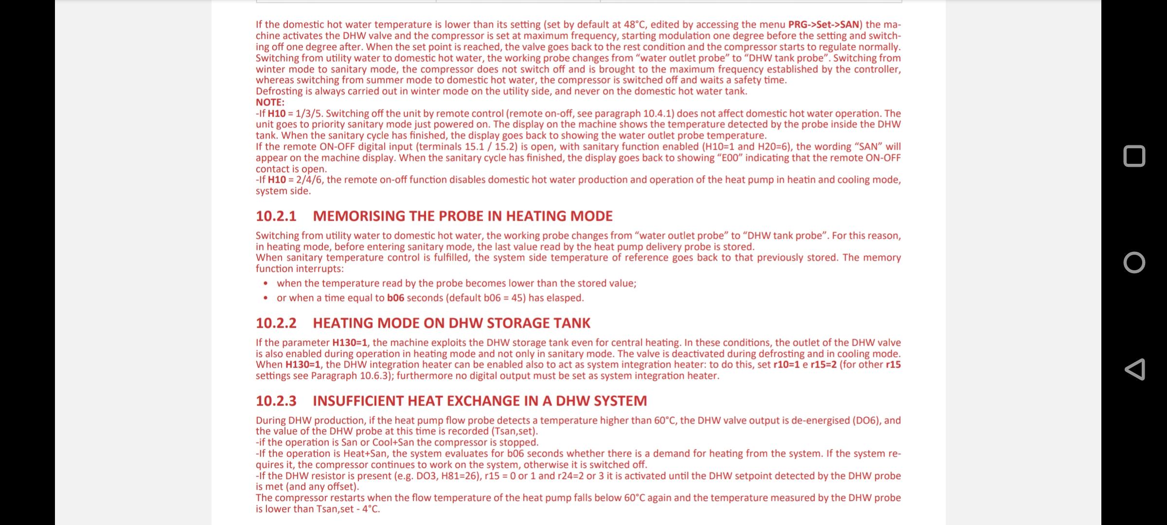

JohnMo Posted April 12, 2024 Share Posted April 12, 2024 13 minutes ago, JamesPa said: I assume you refer to the phe circulator pump. What's the advantage of modulating it? Yes referred to phe pump, not sure if the advantage but that's two companies that do. This what my manual says about DHW heating. There is some modulation but not until 1 Deg of target temp. My Atag boiler seemed to operate exactly the same as the heat pump, I noticed if you tried to heat a cylinder (thermal store with heating coil) at too low a set temperature against small coil, it just wouldn't get there instead it would just cycle a lot. Cylinder temperature would remain static, boiler would run for a minute overshoot target and shutdown for 10 mins. I over came the issue with a huge PHE. Link to comment Share on other sites More sharing options...
JamesPa Posted April 12, 2024 Share Posted April 12, 2024 (edited) 25 minutes ago, JohnMo said: Yes referred to phe pump, not sure if the advantage but that's two companies that do. This what my manual says about DHW heating. There is some modulation but not until 1 Deg of target temp. My Atag boiler seemed to operate exactly the same as the heat pump, I noticed if you tried to heat a cylinder (thermal store with heating coil) at too low a set temperature against small coil, it just wouldn't get there instead it would just cycle a lot. Cylinder temperature would remain static, boiler would run for a minute overshoot target and shutdown for 10 mins. I over came the issue with a huge PHE. Interesting. So what happens with a non modulating heat pump, I wonder, if the tank hasn't reached temp -1C but the heat transfer to the cylinder is less than hp output. Is it the same as your atag - ie it cycles, or does the flow temp rise until there is sufficient heat transfer (obviously still at a ft less than the coolant temp). I guess this depends on the hysterisis allowed on the ft? Actually I think the last part of the extract you posted answers this. The hp cycles if flow temp goes above 60. So as long as there is sufficient heat transfer to the tank when ft=59 and tank is at the required temp, all should be well. That sets a minimum coil/heat exchanger size. Edited April 12, 2024 by JamesPa Link to comment Share on other sites More sharing options...
sharpener Posted April 12, 2024 Share Posted April 12, 2024 I have had a quite lengthy interchange with Vaillant tech about retaining an existing cyl on a 12kW installation and at no point have they said it will not modulate on HW, some of the calcs I shared with them explicitly assumed that it will turn down to 6kW (summer mode, no parallel heating of the thermal store). Also there is the Noise Reduction mode you can set to be at the same times as the DHW, you can programme the output to be 40...60% of the full rating, see the charts here. The rest of that thread is also quite relevant to this discussion as the starting point was the Vaillant 200l tank, which has only 1.4m^2 coil but the chart shows is compatible with the 12kW HP. Proportionality would therefore suggest a 7kW unit will go on a 0.75 coil and the OP's solar tank is at least twice that. Link to comment Share on other sites More sharing options...
