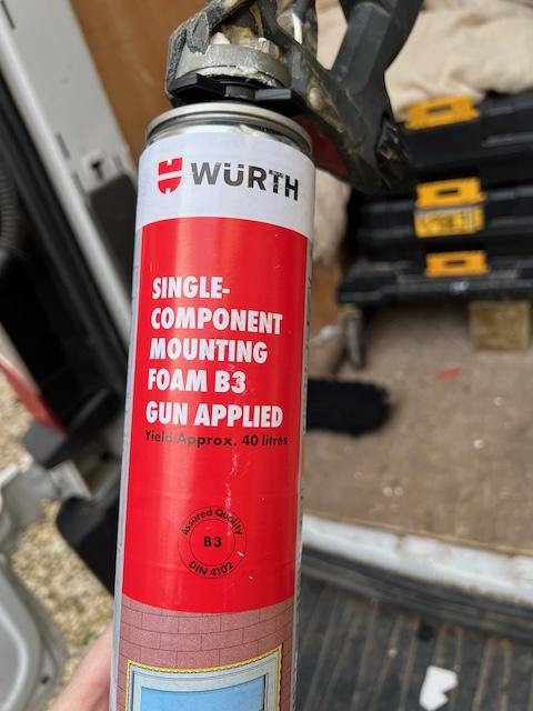

alexo Posted April 10 Author Share Posted April 10 This is the foam they're using. The project manager claims they always use this on Internorm projects including passivhauses. It isn't airtight. They've said they always use it. Is it just cheap crap? I can't find any data sheets on it. Link to comment Share on other sites More sharing options...
garrymartin Posted April 10 Share Posted April 10 I don't have any skills to comment on the install, but I can help out with the datasheet. https://eshop.wurth.co.uk/is-bin/INTERSHOP.enfinity/WFS/3108-B1-Site/en_GB/-/GBP/ViewOfferDetail-GetDocument/08921521__ZTD02.PDF?DocumentId=Y12022052402000005507051e27743ae&ProductRefID=08921521%403108-B1&MimeType=application%2Fpdf 08921521__ZTD02.pdf 1 Link to comment Share on other sites More sharing options...
alexo Posted April 10 Author Share Posted April 10 1 minute ago, garrymartin said: I don't have any skills to comment on the install, but I can help out with the datasheet. https://eshop.wurth.co.uk/is-bin/INTERSHOP.enfinity/WFS/3108-B1-Site/en_GB/-/GBP/ViewOfferDetail-GetDocument/08921521__ZTD02.PDF?DocumentId=Y12022052402000005507051e27743ae&ProductRefID=08921521%403108-B1&MimeType=application%2Fpdf 08921521__ZTD02.pdf 369.34 kB · 0 downloads Amazing, thanks Garry. Unfortunately I do not have the skills to interpret it either 😂 Link to comment Share on other sites More sharing options...
SimonD Posted April 10 Share Posted April 10 7 minutes ago, alexo said: Amazing, thanks Garry. Unfortunately I do not have the skills to interpret it either 😂 I don't think that's an airtightness product. I wonder whether the installers confuse thermal insulation with airtightness. Link to comment Share on other sites More sharing options...
MikeSharp01 Posted April 10 Share Posted April 10 It does not stay flexible like the Illbruk one does so if there is any movement if goes with it rather than staying where it was put and creating cracks / leaks. Also I found this video from Charlie Luxton which shows his Internorm window install. At 56 seconds in you can see him talking about a window and you can see how how your should have packer at the base and he goes on to talk about the expanding tape and how that should be fitted and refers to the microcraking you get if you don't use flexible fillers. Worth a look. 1 Link to comment Share on other sites More sharing options...
alexo Posted April 10 Author Share Posted April 10 4 minutes ago, MikeSharp01 said: It does not stay flexible like the Illbruk one does so if there is any movement if goes with it rather than staying where it was put and creating cracks / leaks. Also I found this video from Charlie Luxton which shows his Internorm window install. At 56 seconds in you can see him talking about a window and you can see how how your should have packer at the base and he goes on to talk about the expanding tape and how that should be fitted and refers to the microcraking you get if you don't use flexible fillers. Worth a look. Fantastic, thanks Mike. Link to comment Share on other sites More sharing options...
MikeSharp01 Posted April 10 Share Posted April 10 Ok so Airseal FM330 from Illbruck "has is a moisture curing expanding polyurethane foam that ideal for use as an air tight gap filler for construction joints. The movement accommodation factor of 35% ensures that the integrity of the seal is maintained." Accommodation factor is not mentioned on the Wurth product (Which I would have a l;ot of time for in other applications - they make good stuff) Link to comment Share on other sites More sharing options...
alexo Posted April 10 Author Share Posted April 10 5 minutes ago, MikeSharp01 said: Ok so Airseal FM330 from Illbruck "has is a moisture curing expanding polyurethane foam that ideal for use as an air tight gap filler for construction joints. The movement accommodation factor of 35% ensures that the integrity of the seal is maintained." Accommodation factor is not mentioned on the Wurth product (Which I would have a l;ot of time for in other applications - they make good stuff) Thanks, I have got some of the Ilbruck FM330 arriving on express delivery tomorrow. Given that I think it’s unlikely I’m going to get completely new frames with my lack of technical knowledge and lack of ability to argue it, the plan is to use that going forward, and for the 3 already fitted we will dig out as much of the existing foam as possible and refoam with the Illbruck. Link to comment Share on other sites More sharing options...

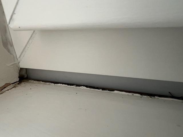

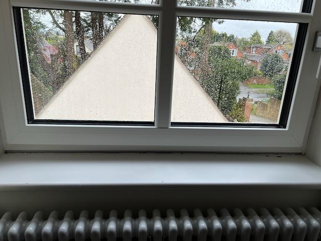

alexo Posted April 10 Author Share Posted April 10 This morning I was reassured by the fitters that no foam would probably be needed on the 2 they fitted today (non-dormers) which led me to believe this problem wouldn't affect all other windows. After fitting this is what we got. Again approx 2 cm gap above window board, with the window resting on a grey plastic ledge internally. This gap is currently letting in a howling gale and the fitters aim to fill it with foam tomorrow, although clearly the amount they can fit in here is minimal so even though they will use airtight foam I'm not confident its going to do much. It's really clear they're all going to have this problem, so as has been said before there is clearly an error here, I assume the windows are 2cm approx shorter than they should be. For example it's quite obvious to me the outside pictures show the window ledge screws visible when the frame should sit closer to the cill, which is also unsightly. So my question is, if I go all in on fighting this do I have a case? Is this enough of a measurement error for me to stop the install and request a resolution such as replacement or a hefty refund without being penalised for stopping the install? Or is this a grey area? Am I making too much of a fuss about 2cm gap? @craig or anyone else in the know advice would be much appreciated! Link to comment Share on other sites More sharing options...
craig Posted April 10 Share Posted April 10 (edited) 5 minutes ago, alexo said: This morning I was reassured by the fitters that no foam would probably be needed on the 2 they fitted today (non-dormers) which led me to believe this problem wouldn't affect all other windows. After fitting this is what we got. Again approx 2 cm gap above window board, with the window resting on a grey plastic ledge internally. This gap is currently letting in a howling gale and the fitters aim to fill it with foam tomorrow, although clearly the amount they can fit in here is minimal so even though they will use airtight foam I'm not confident its going to do much. It's really clear they're all going to have this problem, so as has been said before there is clearly an error here, I assume the windows are 2cm approx shorter than they should be. For example it's quite obvious to me the outside pictures show the window ledge screws visible when the frame should sit closer to the cill, which is also unsightly. So my question is, if I go all in on fighting this do I have a case? Is this enough of a measurement error for me to stop the install and request a resolution such as replacement or a hefty refund without being penalised for stopping the install? Or is this a grey area? Am I making too much of a fuss about 2cm gap? @craig or anyone else in the know advice would be much appreciated! Dinner has just been put on table, will come back to this. Edited April 10 by craig 1 Link to comment Share on other sites More sharing options...

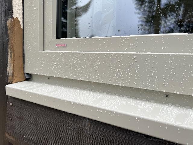

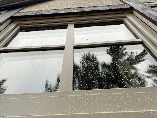

craig Posted April 10 Share Posted April 10 The internal cill height difference should have been taken into account. Cill needs removed, packed up and made good. It’s an oversight but it would need to have been resolved either way. External alu cill as expected but I’d expect coloured screws / cover capped screws for fixing. Along top externally, it's a replacement tbh and I’d expect things not to have been considered or a wait see result before finishing. I’d have expected a discussion to have taken place though. 1 Link to comment Share on other sites More sharing options...
alexo Posted April 10 Author Share Posted April 10 34 minutes ago, craig said: The internal cill height difference should have been taken into account. Cill needs removed, packed up and made good. It’s an oversight but it would need to have been resolved either way. External alu cill as expected but I’d expect coloured screws / cover capped screws for fixing. Along top externally, it's a replacement tbh and I’d expect things not to have been considered or a wait see result before finishing. I’d have expected a discussion to have taken place though. Thanks Craig. I will complain again and hopefully I will not be gaslighted this time. Still no acknowledgement of an error from them. So annoying that we have essentially lost 2cm of view from each window because of this. Link to comment Share on other sites More sharing options...
