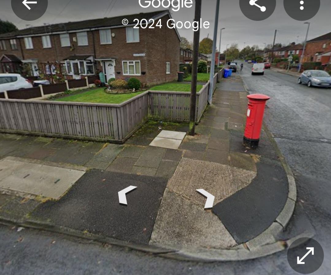

We want put a higher fence at the back and the  side of our house to  extend the garden.We live on a corner plot .
I believe we need planning permission to do so as its next to a road .
Has anybody been successful with the planning permission or could give us any advice on what we can/can't do?

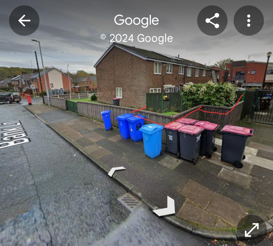

I have marked the area where we want to put a higher fence as we know any more would more likely obstruct the vision .

Frankly as you want the fence in the red bit on your photo which is away from the road junction I don’t think you will have a problem and would go ahead and do it, if anyone did complain by the time it concluded your hedge will have grown (and they can do nothing about that.)
