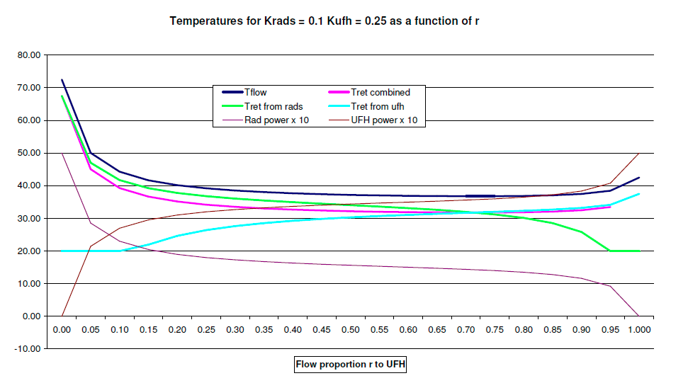

sharpener Posted January 27, 2025 Author Posted January 27, 2025 Well it gets more complicated by the day! The flow limit of 4 l/min to the UFH is required while the radiators are operating as described above. But when they are not, I realise I need to be able to supply the UFH at a higher flow rate and lower temperature, say 35 deg, in order to achieve a correspondingly higher CoP. Perhaps when there is no flow to the rad circuit the internal pump in the outdoor unit will be powerful enough to get sufficient flow through a fixed restriction like a partially closed valve as upthread - I will certainly check this out first. Otherwise the flow restrictor will need to be bypassed when there is no demand signal for the rads. Fortunately I have a spare motorised valve which can be supplied via the n/c contacts on the rad circuit zone valve which should achieve this nicely.
Beelbeebub Posted January 27, 2025 Posted January 27, 2025 Just a thought. UFH tends to have a fairly high thermal inertia compared to rads (especially if it's in slab). Could you have 2 zones UFH and Rad. Each zone is set for the ideal flow and temp and you just "multiplex" between them say 30min on UFH, 30min on rads. Alternatively, you could flow to the rads all the time and, as needed, drop the flow temp and open up the UFH loops, so your rads will cool a bit (but still put out some heat) for a while whilst your UFH slab heats up.
sharpener Posted January 27, 2025 Author Posted January 27, 2025 (edited) 3 hours ago, Beelbeebub said: Could you have 2 zones UFH and Rad. Each zone is set for the ideal flow and temp and you just "multiplex" between them say 30min on UFH, 30min on rads. Alternatively, you could flow to the rads all the time and, as needed, drop the flow temp and open up the UFH loops, so your rads will cool a bit (but still put out some heat) for a while whilst your UFH slab heats up. I think the heat losses are too much for "either or" to work unfortunately. In the recent cold snap the HP needed to work at max o/p much of the time. The hall and the end of the kitchen furthest from the AGA got very cold without the UFH, and I had not at the time worked out why the UFH crippled the output from the rads. Living room has both so it matters less there. We do have the system divided into the two zones but the flow temp from the HP is determined by the heat curve for the higher of the two emitter circuits, so if there is any demand from the rads side it will run up automatically to the higher temp. Not sure how I could prevent that. Perhaps use the microswitch contacts on the UFH zone valve to do something cunning like open the rads zone valve without the HP controls knowing! I still think I would need to modulate the flow rate to the UFH though. Edited January 27, 2025 by sharpener

Beelbeebub Posted January 28, 2025 Posted January 28, 2025 Are your rads on separate circuit to your ufh? Ie can you run just rads and just ufh? If so, and your controller has the facility for separate wc curves per zone you should be able to run each set of emitters at the optimum temp. It might be worth working out which emitter is your "worst" ie needs the highest flow temp. It might be that it is just one or two rads are markedly worse. If those were upgraded it might allow a significant drop to a lower temp.
sharpener Posted January 28, 2025 Author Posted January 28, 2025 14 hours ago, Beelbeebub said: Are your rads on separate circuit to your ufh? Ie can you run just rads and just ufh? If so, and your controller has the facility for separate wc curves per zone you should be able to run each set of emitters at the optimum temp. Yes they are physically separate with their own zone valves. But as upthread the HP controller will cause the flow temp to suit whichever is the higher. So when the rads are in use I only want to allow a small amount of flow to the UFH. At other times a larger flow at a lower temp and better CoP. 14 hours ago, Beelbeebub said: It might be worth working out which emitter is your "worst" ie needs the highest flow temp. It might be that it is just one or two rads are markedly worse. If those were upgraded it might allow a significant drop to a lower temp. No, we upgraded 6 out of the 8 when the HP was installed, they should all be quite well matched now. Current plan is to restrict the flow to the UFH by partly closing the isolating valve, and then see if the pump is sufficiently powerful to push more flow through it to the UFH when the rads are not on. The Wilo internal pump in the Vaillant HP generates a high head and will try and do 34 l/min under most circs. If this does not work well enough I will just set the times so they do not overlap as you suggested earlier, until the heating season is over and I can cut into the pipework to install the bypass valve round the flow restrictor. Am still thinking how to do this without running more cable from utility room to the UFH manifold. Yes I have a spare Shelly plug so might do it wirelessly.

Beelbeebub Posted January 29, 2025 Posted January 29, 2025 13 hours ago, sharpener said: Yes they are physically separate with their own zone valves. But as upthread the HP controller will cause the flow temp to suit whichever is the higher. So when the rads are in use I only want to allow a small amount of flow to the UFH. At other times a larger flow at a lower temp and better CoP. No, we upgraded 6 out of the 8 when the HP was installed, they should all be quite well matched now. Current plan is to restrict the flow to the UFH by partly closing the isolating valve, and then see if the pump is sufficiently powerful to push more flow through it to the UFH when the rads are not on. The Wilo internal pump in the Vaillant HP generates a high head and will try and do 34 l/min under most circs. If this does not work well enough I will just set the times so they do not overlap as you suggested earlier, until the heating season is over and I can cut into the pipework to install the bypass valve round the flow restrictor. Am still thinking how to do this without running more cable from utility room to the UFH manifold. Yes I have a spare Shelly plug so might do it wirelessly. S I can get this straight in my head. You want to run in 3 conditions 1) Just rads at WC curve suited to rads 2) Just UFH at WC curve suited to UFH 3) Both rads & UFH with HP outputting WC curve for rads You can currently run 1 & 2 no problem, the issue is with 3 where the UFH circuit drops the return temp so much the HP cannot achive the desired rad temp? Is that correct? Assuming it is, I imagine you essentially have 2 choices. During the overlap time you can either run with Rads WC, and (as you suggest) have a lower flow rate through the UFH such that the return flow/temp doesn't drag the bulk flow down and cause the HP problems. The other option is the inverse, run both at the UFH WC temp. The UFH will be fine (obviously) the rads will be a bit cooler and output a bit less but the return temp shouldn't be an issue for the HP. The downside of this is the rad zones will be a little underpowered but this could be compensated for by switching to rads only for periods to "blip" a bit more heat into the zones. The upside is there shouldn't be any plumbing changes.

sharpener Posted January 29, 2025 Author Posted January 29, 2025 (edited) 50 minutes ago, Beelbeebub said: You can currently run 1 & 2 no problem, the issue is with 3 where the UFH circuit drops the return temp so much the HP cannot achive the desired rad temp? Is that correct? Yes 50 minutes ago, Beelbeebub said: During the overlap time you can either run with Rads WC, and (as you suggest) have a lower flow rate through the UFH such that the return flow/temp doesn't drag the bulk flow down and cause the HP problems. The other option is the inverse, run both at the UFH WC temp. The UFH will be fine (obviously) the rads will be a bit cooler and output a bit less but the return temp shouldn't be an issue for the HP. Problem here is that reducing the dT between MWT and room from 27.5 to 12.5 means the rad output is more than halved bc of the 1.3 exponent in output vs dT, so is reduced by a factor of 2.79 or to 36%. This is a big drop and wouldn't meet the heat loss of the room as per my last post. So as stated I think it is worth experimenting with the existing valve setup first before making any permanent changes to the plumbing. Edited January 29, 2025 by sharpener

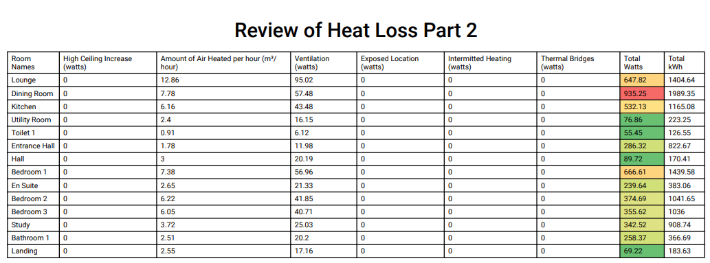

Dillsue Posted January 29, 2025 Posted January 29, 2025 14 hours ago, sharpener said: No, we upgraded 6 out of the 8 when the HP was installed, they should all be quite well matched now. Did you do heat loss calcs for each room to size the rads and factor in the the massive reduction in output for low temp flow?? I'm working my way through all our rooms/rads just now to resize everything for 35 degree flow and intrigued to know the approach you took??
Beelbeebub Posted January 29, 2025 Posted January 29, 2025 (edited) 48 minutes ago, sharpener said: Problem here is that reducing the dT between MWT and room from 27.5 to 12.5 means the rad output is more than halved bc of the 1.3 exponent in output vs dT, so is reduced by a factor of 2.79 or to 36%. This is a big drop and wouldn't meet the heat loss of the room as per my last post. Understood, but is the root problem that there are some rooms that cannot be heated without using rads at 45C and UFH at 40C at the same time? What is the.max temp the UFH can stand? Edited January 29, 2025 by Beelbeebub
sharpener Posted January 29, 2025 Author Posted January 29, 2025 Yes and no. I used the free heatpunk s/w to make my own estimates of the whole house heat loss to confirm HP size. The room-by-room estimates were then done in detail by the three potential installers as part of their MCS approved quotations. All used Heat Engineer (IIRC you can buy a one-project licence for a reasonable fee but the learning curve looked too steep). They all quoted figures at a range of temperatures. Here is one extract: This doesn't quite cover your case, but without reverse engineering it all I think you would get a close result by using an exponent of 1.3 to work from published 50C dT rad outputs. Certainly it would work for the small correction from the figures tabulated above for 35 to get to your 32.5C MWT. All assuming that the scale factors are independent of actual physical rad sizes but I think that is reasonable. I think you would struggle to get a working rad flow temp as low as 35 though without ending up with a lot of K3s. Our oil boiler had been set to 65C, and at 50C flow we only just avoided using any, the average rad size upgrade factor was 1.9. The installer wanted to fit one in B2 but I persuaded him the 5% increase in output from plumbing a K22 as TBOE was sufficient. Even so there was a subsequent iteration to get the sizes down by increasing the MWT to 47.5. Of course all these figures are for worst case OAT (-0.2C, Plymouth), using the WC we expect them to be much lower most days.

marshian Posted January 29, 2025 Posted January 29, 2025 50 minutes ago, sharpener said: Yes and no. I used the free heatpunk s/w to make my own estimates of the whole house heat loss to confirm HP size. The room-by-room estimates were then done in detail by the three potential installers as part of their MCS approved quotations. All used Heat Engineer (IIRC you can buy a one-project licence for a reasonable fee but the learning curve looked too steep). They all quoted figures at a range of temperatures. Here is one extract: This doesn't quite cover your case, but without reverse engineering it all I think you would get a close result by using an exponent of 1.3 to work from published 50C dT rad outputs. Certainly it would work for the small correction from the figures tabulated above for 35 to get to your 32.5C MWT. All assuming that the scale factors are independent of actual physical rad sizes but I think that is reasonable. I think you would struggle to get a working rad flow temp as low as 35 though without ending up with a lot of K3s. Our oil boiler had been set to 65C, and at 50C flow we only just avoided using any, the average rad size upgrade factor was 1.9. The installer wanted to fit one in B2 but I persuaded him the 5% increase in output from plumbing a K22 as TBOE was sufficient. Even so there was a subsequent iteration to get the sizes down by increasing the MWT to 47.5. Of course all these figures are for worst case OAT (-0.2C, Plymouth), using the WC we expect them to be much lower most days. Those heat losses seem really high unless they are massive rooms I used the Heat engineer software (before I was aware of the spreadsheet on here) and it didn't seem like a steep learning curve to me I'm using flow temps of between 28 and 35 with T22 Rads and bedroom temps are set 2 deg higher than the std 18 for bedrooms I think I'd be trying to run the house with a single boiler temp for both UFH and Rads

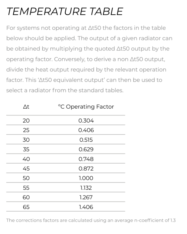

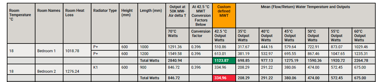

Dillsue Posted January 29, 2025 Posted January 29, 2025 4 hours ago, sharpener said: The table has fixed rad sizes(existing??) showing the output at various flow temps to guide on choosing the minimum flow temp. I'm working on fixed flow temp/heat loss with a calculation to show dT50 equivalent rad output for running at 35c. I'm wanting to keep flow temps low to get a good COP so it's the rad size I'm interested in rather than the flow temp needed for a preset rad size. For your bedroom 2 the rad output shown falls way below the heat loss. Are you running like that??
sharpener Posted January 29, 2025 Author Posted January 29, 2025 (edited) 40 minutes ago, Dillsue said: The table has fixed rad sizes(existing??) showing the output at various flow temps to guide on choosing the minimum flow temp. I'm working on fixed flow temp/heat loss with a calculation to show dT50 equivalent rad output for running at 35c. I'm wanting to keep flow temps low to get a good COP so it's the rad size I'm interested in rather than the flow temp needed for a preset rad size. For your bedroom 2 the rad output shown falls way below the heat loss. Are you running like that?? That table was purely to show you how Heat Engineer tabulates the output at various MWTs, to help you scale your rads for a 35C flow temp if you can't get that info from the rad mfr's data sheets. The relative data are what is important, the absolute values less so. No, those were the original rad sizes. B2 is the one they wanted to upgrade to a 600 x 1200 K33 but the compromise was a K22 with TBOE and upping the MWT to 47.5C. The original B2 rad went into the bathroom where there was none at all. Previous owners of the house had some funny ideas, e.g. the rads are mostly on the far side of the rooms from the windows but taking up all the floors to re-site them was too much. Many were too small even with the oil boiler, I put 3 additional ones in before the HP was thought of. Edited January 29, 2025 by sharpener
