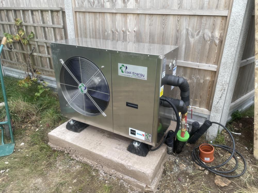

This is @HughF install. He has a good tip about using Solar piping UV resistant tape to finish off the install. But it is expensive. https://www.bes.co.uk/high-temperature-insulation-tape-x-15-m-20220/?refSrc=42745&nosto=productpage-nosto-1-c

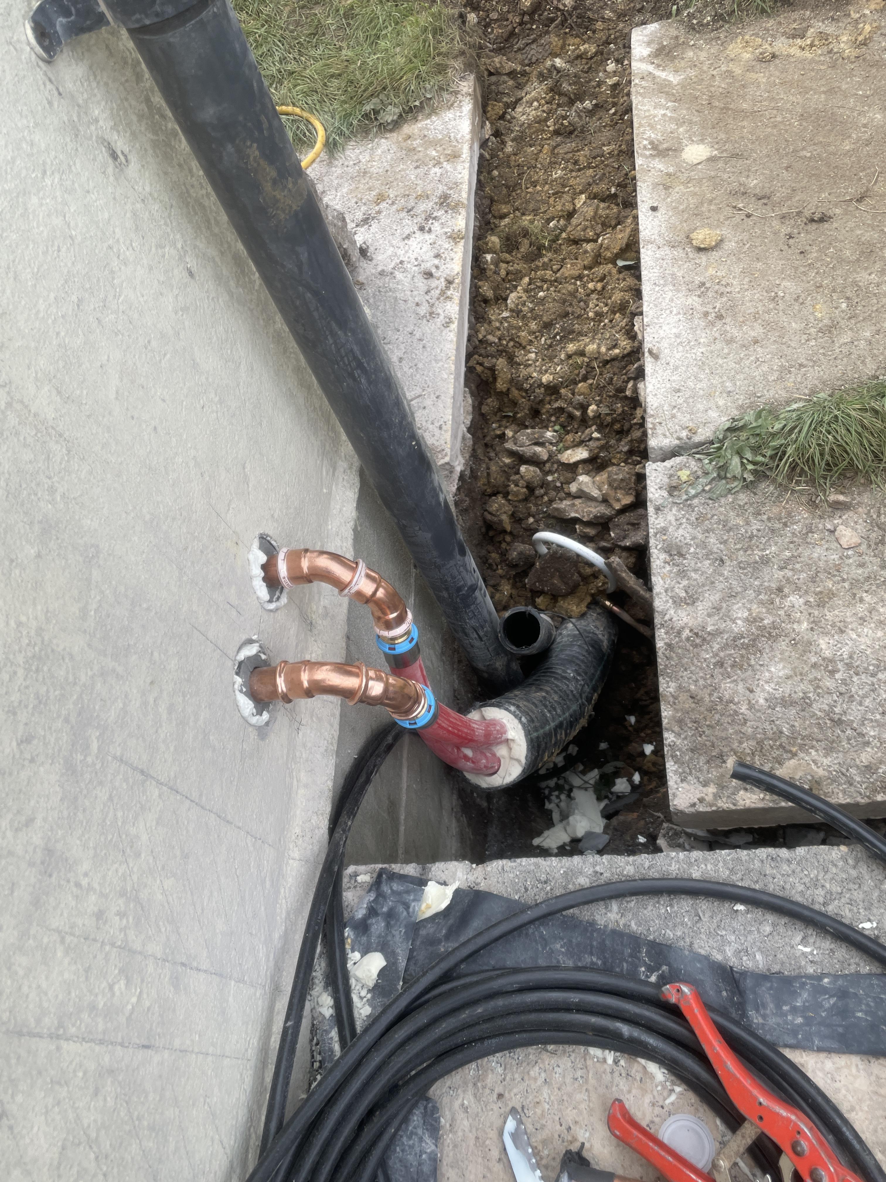

I’m going to use 28mm water softener flexible pipes with primary pro insulation. I need a 1” BSP connection at both ends. The water softener pipe spec limits it to 65° water temp. I will cut the underground insulated pipe and try to get the best finish I can. I will upload some pictures when I’m done. I’m currently waiting on BES to ship the insulation.

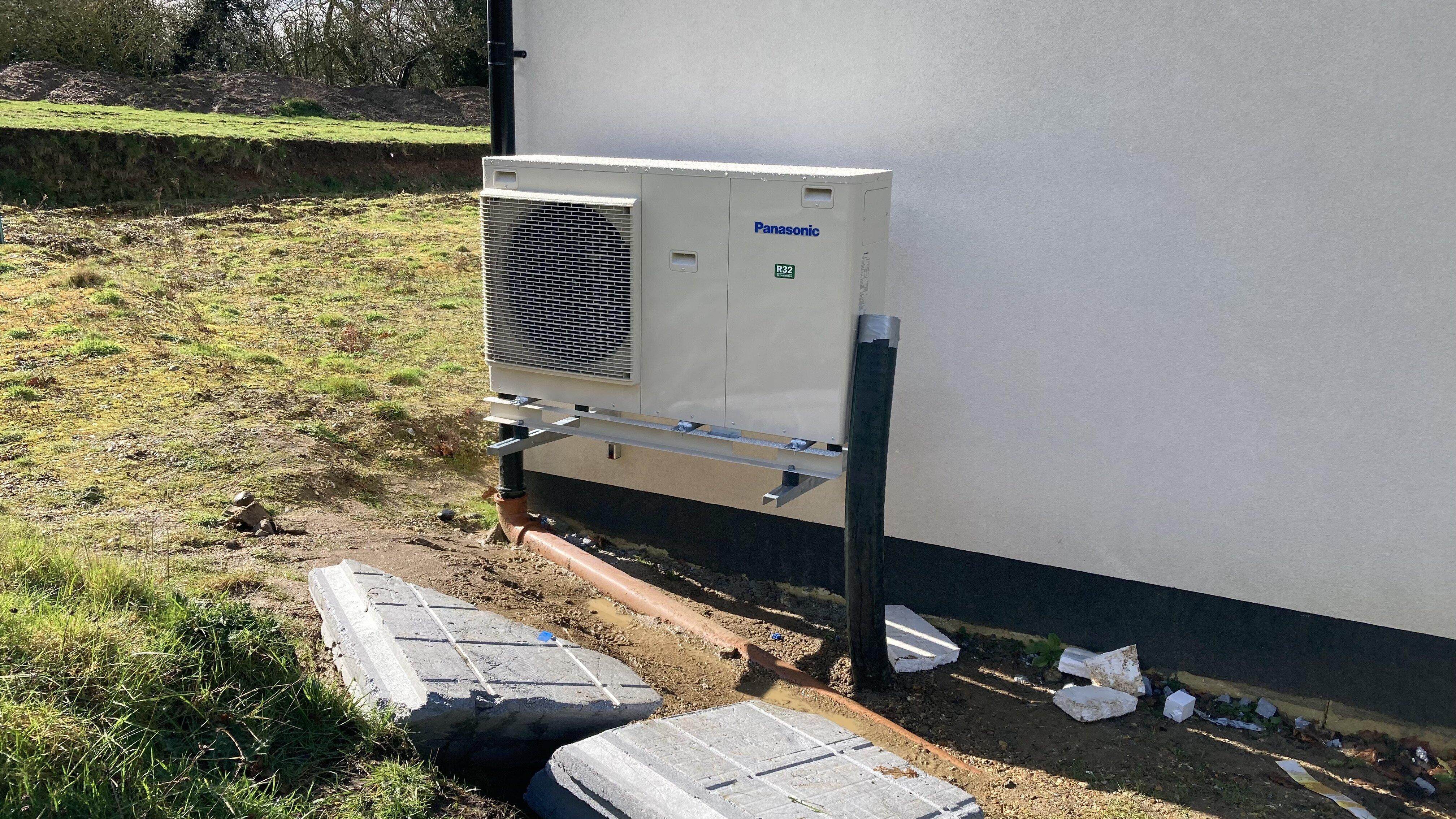

Note: For any one interested, I choose to hang my ASHP from the wall because it was going to be a long time before any landscaping work would be done. I did not want The ASHP concrete plinth to dictate what we ended up doing in regards to levels and access. I got the idea from on of Urban Plumbers YouTube install videos. He was very positive about wall hanging ASHPs.

Thanks! The reality of the install in terms of neatness does not match the clean pics on the manufacturers websites. I seen one website has the heat pump pressed hard up against the house, I assume this is impossible as the air normally is pulled in through the back of the pump and out the front.
Brining the pipes through the wall gives the neatest install. However I would rather bring the pipes through the slab as I don’t like the idea of having a have in my wall that would be difficult to seal. I have an open rainscreen cladding so some driven rain will get in.
i think your install looks good. That’s a good point about landscaping around the heatpump. I am also not sure what my finished landscaping will look like and what the final level will be. I guess I could do a temporary base and adjust from there.
