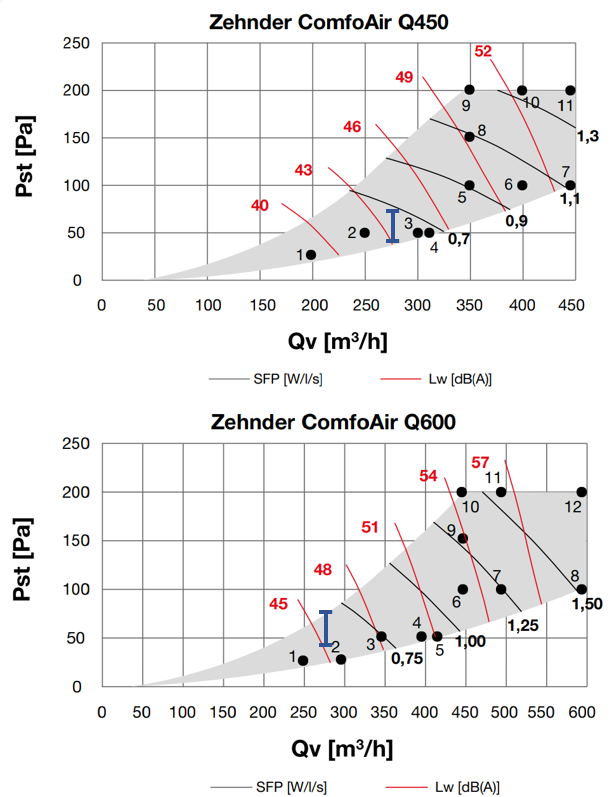

BadgerBadger Posted March 6 Share Posted March 6 So we are finally getting stuck into first fix and ready to start MVHR duct work. I've had a few quotes from the usual suspects, and even paid for a preliminary design, but to be honest have been a bit underwhelmed by what I've been getting back. So I've been doing calculations myself and I think I'm getting to a solution. Using a mix of 90mm semi-rigid and some flat/oval semi-rigid to run a service void, and have managed to keep the flow velocities all well under 2 m/s. Ventilated internal floor area is approx. 250m2 so I'm working from a max ventilation rate of 275m3/hr (~75l/s). I've done some sums on the pressure drop of my longest duct run which on paper seems to be about 40 Pa (as I've kept the flow velocity low) but also assuming it may also be somewhat higher. I'm going for a Zehnder ComfoAir unit but some quotes have been based on Q450 and others on the Q600. So am unsure which to go for. Initially I'd assumed the Q600 would be quieter/better as I'd be running it further away from is maximum but the ComfoAir brochure has some handy plots, I've added my operating point and now I'm not so sure! Feels like I'm a long way down the curve on the Q600 already and in reality may reduce ventilation rate further if building regs rate is too high. The Q600 sound power also looks higher at ~45-46dB, instead of ~43-44dB on the Q450. Is that right? What do you think? Link to comment Share on other sites More sharing options...
JohnMo Posted March 6 Share Posted March 6 Only thing I would say is once signed off you are likely to reduce flow rates. Because building regs rates tend to be a bit excessive. Even with our rates reduced by 30% we are still dropping to mid 30s relative humidity when it's cold which is getting a bit low. I would be tempted to go with the smaller unit. Link to comment Share on other sites More sharing options...
Mike Posted March 6 Share Posted March 6 (edited) The Passivhaus component database indicates that the Q450 is suitable for a capacity of 345m³/hr (according to their independent testing). As a guide, you'd want to run it at a maximum of 2/3 to 3/4 of full capacity in normal use to provide some headroom, so in the 230 to 260m³/hr range. As you're likely to be able to run it at less than Building Regs suggests, that's likely to be adequate. As for noise, you probably wouldn't notice a 2dB difference; if it's in a plant room anyway then ignore it. On the other hand, if the cost difference isn't much I might go with the upgrade. Edited March 6 by Mike prematurely posted Link to comment Share on other sites More sharing options...

MPH243 Posted March 8 Share Posted March 8 We have the Q450 in a 260sqm house in Devon, we are running at about 75% of building regs flow rate. This is normally about 40% humidity which is fine. The unit goes into a frost protection mode when below freezing, it just reduces air supply by a few percent. The unit is in a cupboard in my sons bedroom which has been soundproofed a bit. The supply vent is louder than the unit. 1 Link to comment Share on other sites More sharing options...
