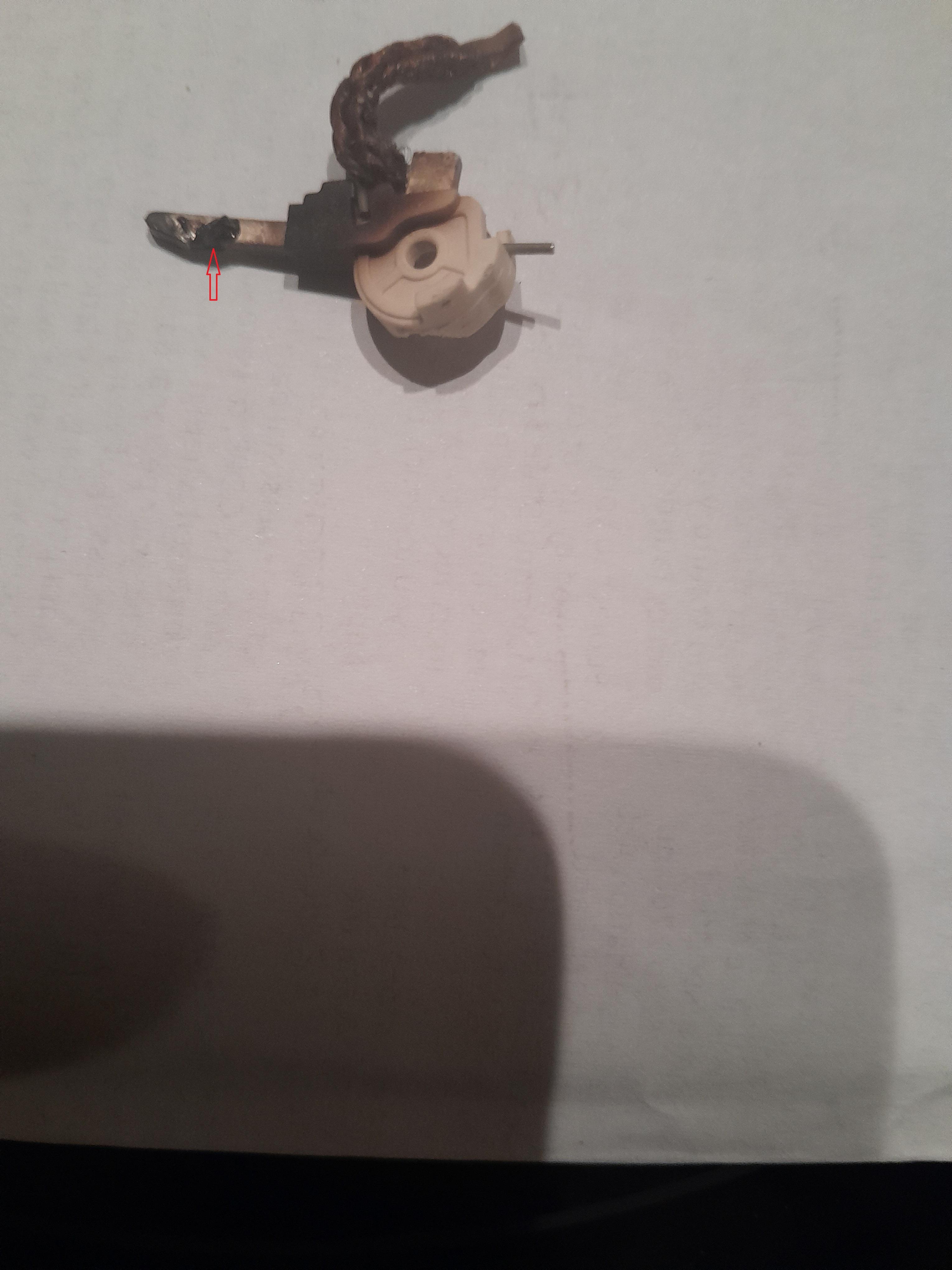

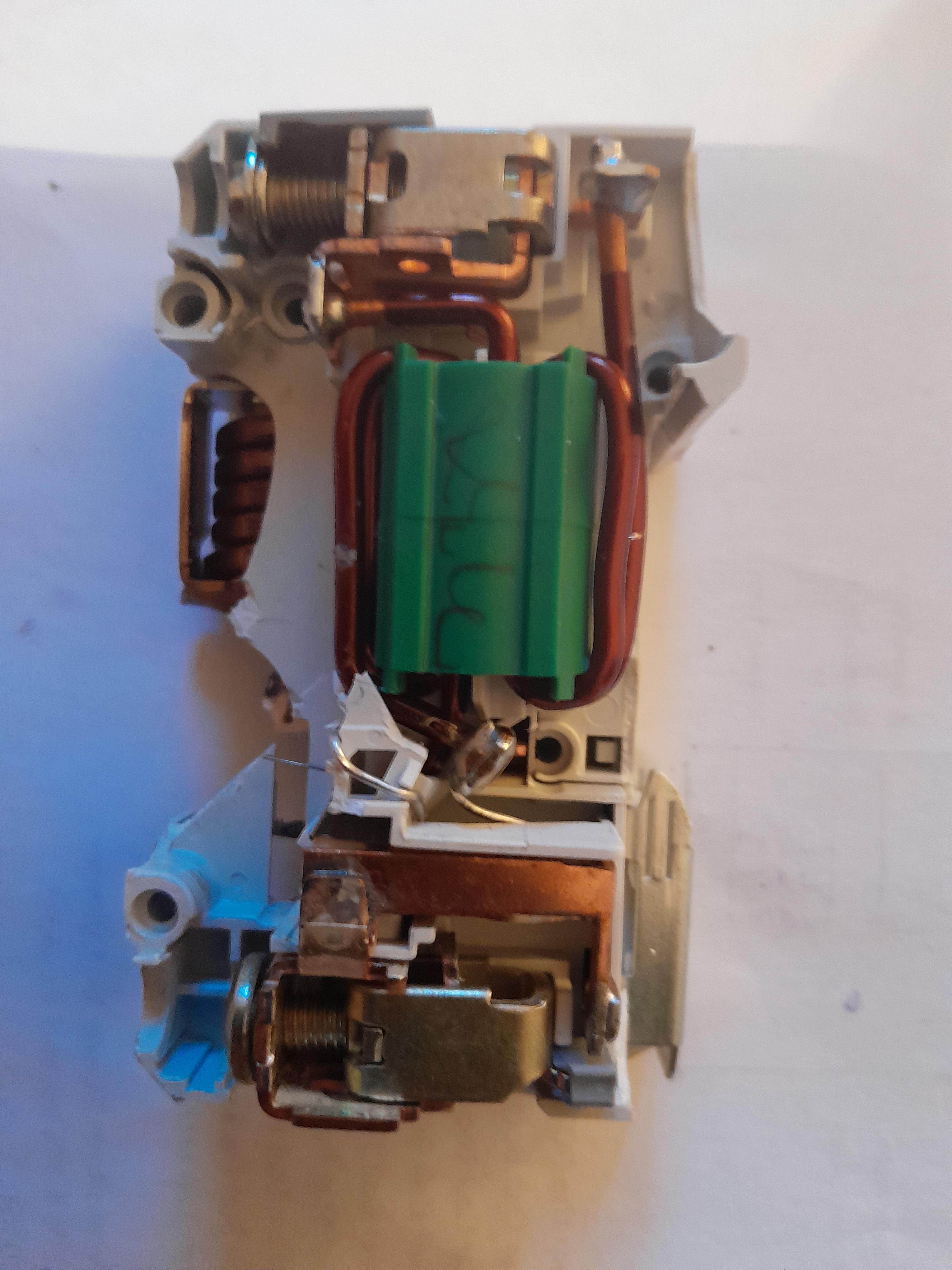

John Carroll Posted March 6, 2024 Share Posted March 6, 2024 (edited) Stayed in daughters house at weekend, had a shower on Saturday, checked trip switch on the RCBO a few hours later, RCBO tripped & reset . Got a call on Sunday morning, no power on shower, found no continuity between the RCBO live contacts, renewed RCBO. Checked shower power at 8.8kw (9.0kw shower) using the smart meter flashing LED. Broke open the failed RCBO (Hager 40A/30ma) and found signs of overheating, the contact (shown below) closes downward, there is a layer of what looks like melted plastic as shown by the arrow which was attached underneat the contact as well which probably prevented the contact closing or it closed with this plastic insulation preventing continuity, I get OC on the M.Meter when testing from the blob of plastic to the contact, also signs of overheating inside the RCBO. I wonder what would have happened if I hadn't tested the RCBO?, I do test it ~ once/annum, this was the original RCBO, installed when the house was built in 2006. The shower is switched on/off at the shower, then isolated each time with the pull cord, this RCBO has never opened/closed on load, is this a unusual failure? Edited March 6, 2024 by John Carroll Link to comment Share on other sites More sharing options...
Alan Ambrose Posted March 6, 2024 Share Posted March 6, 2024 Could be overheating failure I guess as it's running at about 38A vs. max of 40A if your numbers are correct. That's a lot of power. These days the cables in the consumer unit should be torqued using a proper torque driver. So, it's also possible that a slightly loose-ish connection has been arcing. Link to comment Share on other sites More sharing options...
John Carroll Posted March 6, 2024 Author Share Posted March 6, 2024 What ever about torqueing, the screws were certainly well tightened as were all the other CU cables. A 40A RCBO should be well able IMO to carry 40A, a type B can carry 1.2/1.25 times rated current (~ 50A) for hours on end, > 10, 000 secs according to the charts. My own "230V" supply was giving 240V at the (running) 9.0kw shower terminals for about 10 years before returning to normal so I had a lovely 9.8kw shower drawing nearly 41A, the same B40 RCBO is the original, installed in 2007. Link to comment Share on other sites More sharing options...

Mattg4321 Posted March 7, 2024 Share Posted March 7, 2024 Unusual for them to fail like that, especially Hager ime. It won’t have been installer error as that contact has nothing to do with the terminals top or bottom. Sounds like it’s been running under its rated current too, albeit only slightly. Replace and move on! Link to comment Share on other sites More sharing options...
