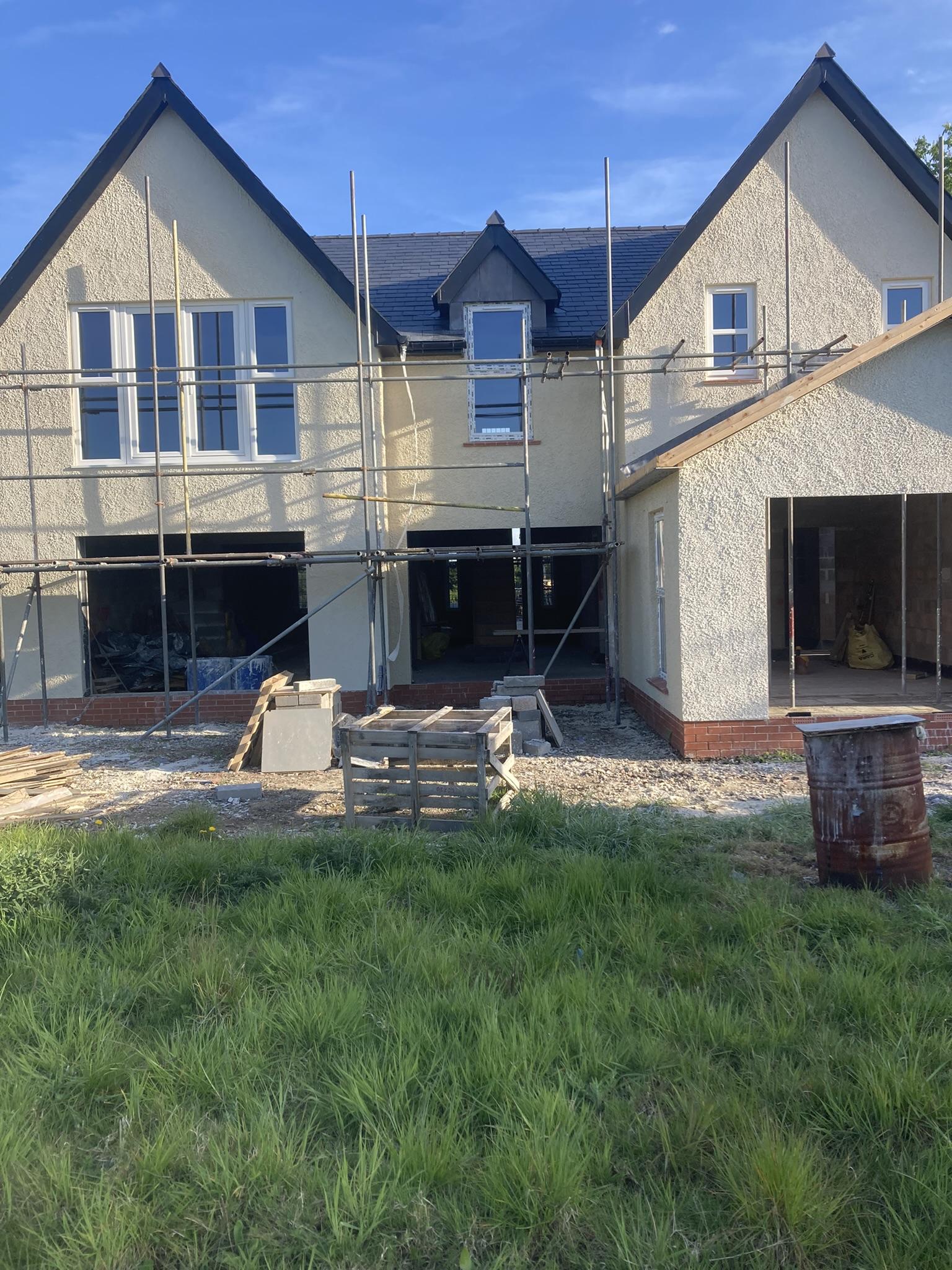

nod Posted March 5, 2024 Posted March 5, 2024 I’ve wet dashed ours with K Dash Ive several pumps that spray the dash but my wife wanted it more random Like I used to do 30 years back in the Lake District White cement Silver sand 3-1-1 The silicone renders keep there colour better 3

JackofAll Posted March 5, 2024 Author Posted March 5, 2024 3 hours ago, nod said: You used the white cement in the scratch coat too? What size chip did you go for Nod, it's a fine looking house.

nod Posted March 5, 2024 Posted March 5, 2024 24 minutes ago, JackofAll said: You used the white cement in the scratch coat too? What size chip did you go for Nod, it's a fine looking house. No. This is K dash But no You don’t need white cement or silver sand in the scratch coat 1

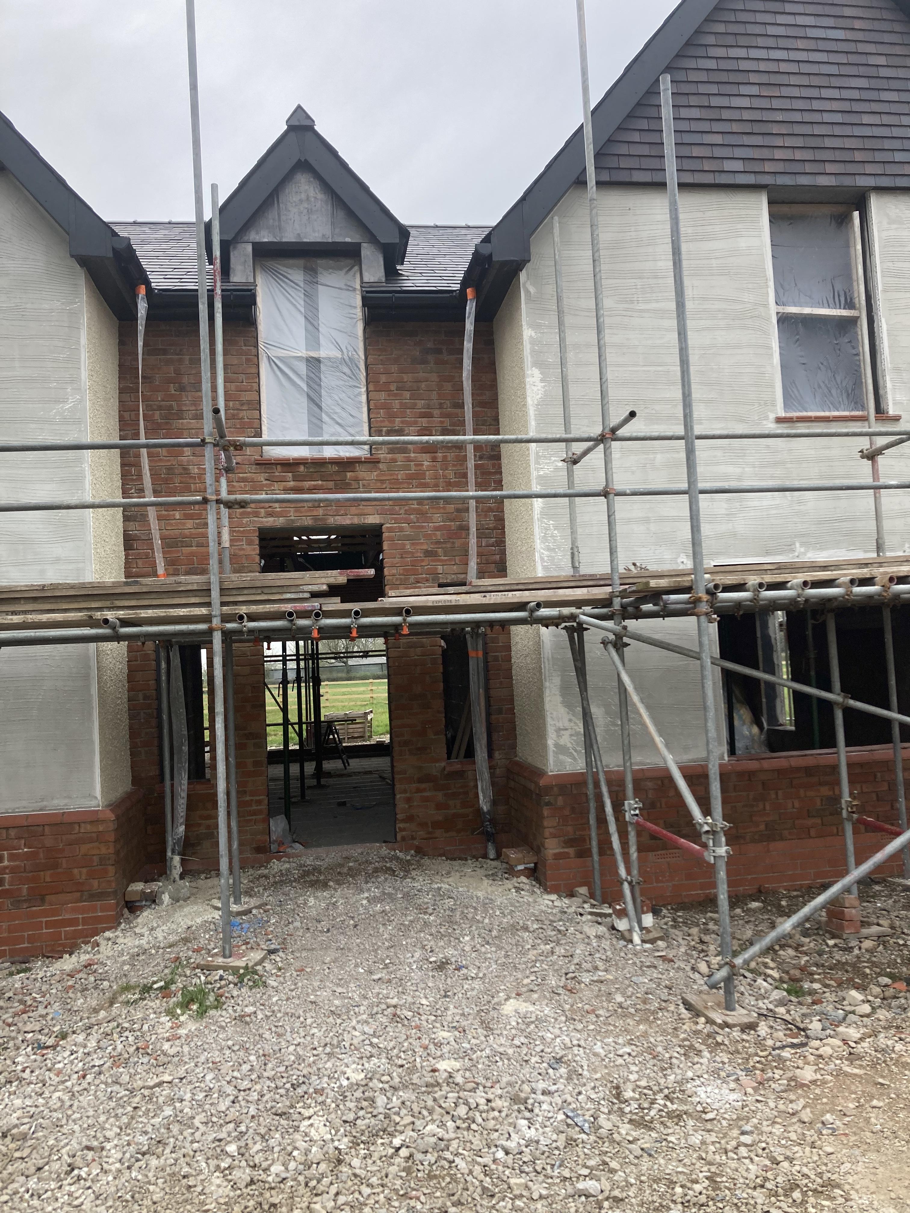

JackofAll Posted May 8, 2024 Author Posted May 8, 2024 Chatting to plasterer re wet dash, he asked how many coats the were specified. My understanding is scratch coat and butter coat, the dash is then applied as the butter coat as it is going off(though not exactly sure when that is) am I wrong? He said its alot of extra expense whereas if he applies a thick scratch coat then dash onto that. Any advice? Also what is the idea of the butter coat?
JackofAll Posted May 9, 2024 Author Posted May 9, 2024 18 hours ago, JackofAll said: Chatting to plasterer re wet dash, he asked how many coats were specified. My understanding is scratch coat and butter coat, the dash is then applied as the butter coat as it is going off(though not exactly sure when that is) am I wrong? He said its alot of extra expense whereas if he applies a thick scratch coat then dash onto that. Any advice? Also what is the idea of the butter coat? * should have read "to the butter coat". @nod can you shed some light on this, thanks.
nod Posted May 9, 2024 Posted May 9, 2024 19 hours ago, JackofAll said: Chatting to plasterer re wet dash, he asked how many coats the were specified. My understanding is scratch coat and butter coat, the dash is then applied as the butter coat as it is going off(though not exactly sure when that is) am I wrong? He said its alot of extra expense whereas if he applies a thick scratch coat then dash onto that. Any advice? Also what is the idea of the butter coat? Run a mile He’s clueless 1
JackofAll Posted May 9, 2024 Author Posted May 9, 2024 Got that impression, just needed confirmation, so is it correct to dash onto butter coat as it's going off?
nod Posted May 9, 2024 Posted May 9, 2024 Scratch coat If sand and cement leave for three days Then a tight coat and dash 1
nod Posted May 9, 2024 Posted May 9, 2024 6 hours ago, JackofAll said: * should have read "to the butter coat". @nod can you shed some light on this, thanks. Butter is Receiver coat 1
