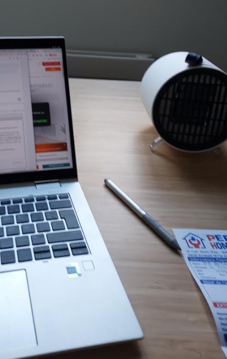

Garald Posted March 7, 2024 Author Share Posted March 7, 2024 Updates: 1. Got the 500W heater (13eur+3 eur for 12-hour shipping) from Amazon. Yes, it works very nicely in this space: from 17.5C to 20C in an hour - I doubt anybody would be unsatisfied. Bit noisy, since it has a fan. 2. An impolite electrician came (I was computing 750W/220V = about 3.5 amperes (OK, 3.4 amperes), thinking aloud, and he said "sir, I do not know who has told you that, the power in electrical lines is 16 amperes" and I had to tell him in the most polite of ways that, since 3.5<16, that confirmed what he said: the radiator would be fine - one can plug it into a socket; I did not even venture the idea of converting the lighting socket that has been given here) and gave me a quote of 300eur for a radiateur rayonnant. He was extremely irritated by the suggestion that the difference in efficiency between that and a more expensive radiateur à inertie would be minor (indeed non-existent, if we are pedantic about what mean by "efficiency": it's always 0%, in that what we are doing is precisely converting energy into heat and nothing else - of course I didn't say that). A hopefully more polite and less stuck-up electrician should visit later today. I'm frankly tempted to keep the 500W heater. I'm just a little bit concerned that some problematic guest might fall asleep over it while exhaling alcoholic fumes, all while wearing a paper hat made out of Kleenex or something. 1 Link to comment Share on other sites More sharing options...

SteamyTea Posted March 7, 2024 Share Posted March 7, 2024 Most portable fan heater have a microswitch on the base, so cut out if knocked over. They also have a thermal fuse or thermal cut out if the airflow is reduced too much and the element goes over temperature. I broke my favourite fan heater by inadvertently knocking it so that it was pointing to the wall a few inches away. This was enough air flow reduction to blow the thermal fuse. I bought a new fuse (well 10) but not got around to replacing it, now I can't find the heater. Link to comment Share on other sites More sharing options...
