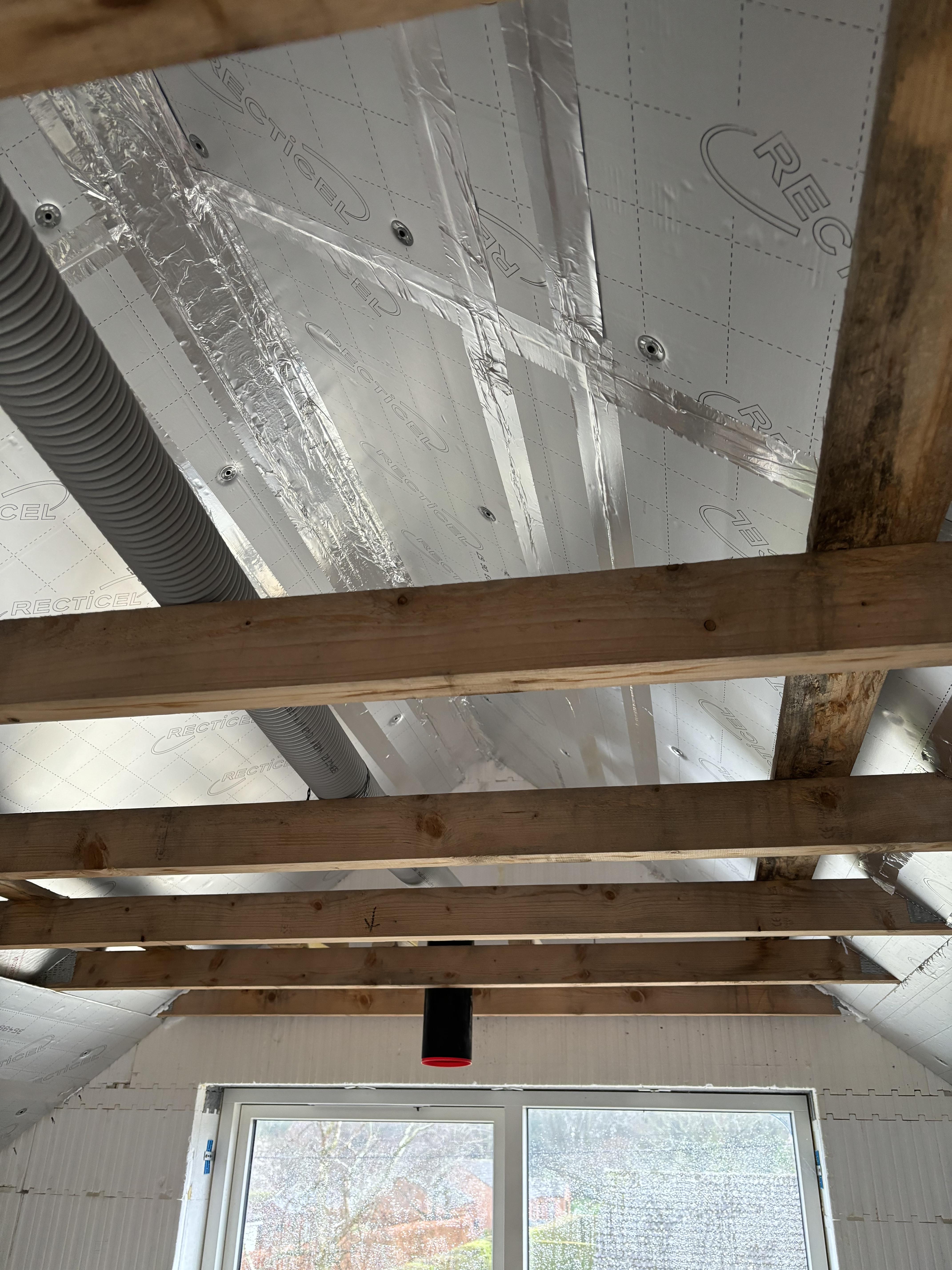

Chanmenie Posted February 29, 2024 Posted February 29, 2024 (edited) Hi all I have nearly finished the insulation in my attic trusses, I have put insulation from the ridge to the eaves as I wanted the lofts warm. Is it recommended to plasterboard over the insulation in the loft spaces ? Edited February 29, 2024 by Chanmenie
JohnMo Posted February 29, 2024 Posted February 29, 2024 I didn't and building control weren't fussed. 1
sharpener Posted February 29, 2024 Posted February 29, 2024 Our Building Inspector was more concerned that there was the correct ventilation space between the insulation and the slates/flat roof to prevent condensation in the voids.
Chanmenie Posted February 29, 2024 Author Posted February 29, 2024 1 hour ago, sharpener said: Our Building Inspector was more concerned that there was the correct ventilation space between the insulation and the slates/flat roof to prevent condensation in the voids. Yeah I have a 50mm gap between insulation and felt / tiles, building inspector didn’t ask to see it
joe90 Posted February 29, 2024 Posted February 29, 2024 I think it depends on what you use the loft space for, storage? Leave it, office etc, plasterboard and scim.
Chanmenie Posted February 29, 2024 Author Posted February 29, 2024 20 minutes ago, joe90 said: I think it depends on what you use the loft space for, storage? Leave it, office etc, plasterboard and scim. It will only be storage, not big enough for anything else, other than the MVHR pipes and manifolds 1
