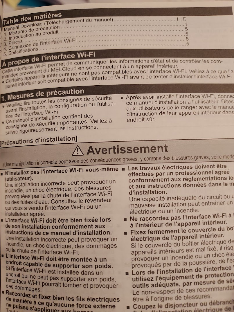

Garald Posted February 19, 2024 Posted February 19, 2024 I got a Wifi adapter for my Mitsubishi Ecodan heat pump in the mail the other day. But what do I see at the beginning of the installation notice? Apparently I can't install myself, or I will be executed by my own heat-pump. (Note: contrary to what the note might be taken to imply, the Wi-Fi adapter is a small, light thing.) I contacted the business that sold me the heat-pump and installed it - they'd like to charge me 200 eur for installing the adapter. That's almost twice the price of the adapter. Is this normal? Do I really need an installer? Can every electrician do this?
sharpener Posted February 19, 2024 Posted February 19, 2024 I would give it a go, you are unlikely to damage anything. If the rest of the installation instructions are clear and you feel capable of carrying them out I don't imagine there would be any problem. If you are going to employ an electrician to do it then at best he will have installed one before and it will be a doddle, at worst he will have no more clue that you and you will be paying for his time while he looks it up on youtube just like you could have done. The biggest issue is likely to be not the physical installation but getting it registered on your wifi network, that will depend on what security measures your router has got. How comfortable are you with working on the wifi setup? For comparison I installed a zappi wifi car charger a year ago and it was quite complicated because of the MAC access control and network extender I have got installed but I got there. If I had used an electrician I would have had to explain all this to them anyway because the standard install instructions would not have been much help.

Garald Posted February 19, 2024 Author Posted February 19, 2024 15 minutes ago, sharpener said: The biggest issue is likely to be not the physical installation but getting it registered on your wifi network, that will depend on what security measures your router has got. How comfortable are you with working on the wifi setup Bah, that's unlikely to kill me, and I wouldn't be any worse at it than an electrician. Would I be voiding any sort of warranty, though? I don't know whether to take these instructions seriously, or more like "wood has been found to cause cancer by the state of California".
Garald Posted February 19, 2024 Author Posted February 19, 2024 (edited) 1 minute ago, Kelvin said: I have the same wifi dongle. Happy to share pictures of how mine is installed if you get stuck. Great. Please do. Did you install it yourself? I take you are still alive? Edited February 19, 2024 by Garald
sharpener Posted February 19, 2024 Posted February 19, 2024 15 minutes ago, Garald said: Would I be voiding any sort of warranty, though? Doubt it. You would have to read the terms of the warranty provided by the original installers. They might not be enforceable anyway. Unfortunately, by asking how much they would charge, you have alerted them to your plans, did they say anything at the time? Otherwise I will leave it to @Kelvin as he has first-hand experience of the process and may be can shed light on the warranty issue as well.
Garald Posted February 19, 2024 Author Posted February 19, 2024 3 minutes ago, sharpener said: Doubt it. You would have to read the terms of the warranty provided by the original installers. They might not be enforceable anyway. Unfortunately, by asking how much they would charge, you have alerted them to your plans, did they say anything at the time? No, only that installing it would not be that hard (since they ( = sales representative of the company that installed my heat-pump) wanted to sell me a WiFi unit, installation not included; I ended up buying it for less online). I could explicitly ask him.
Gary68 Posted February 20, 2024 Posted February 20, 2024 There is an installation video online there is only 1 place it can go, turn off power to FTC, remove cover (4 screws), plug in, put cover back on.
