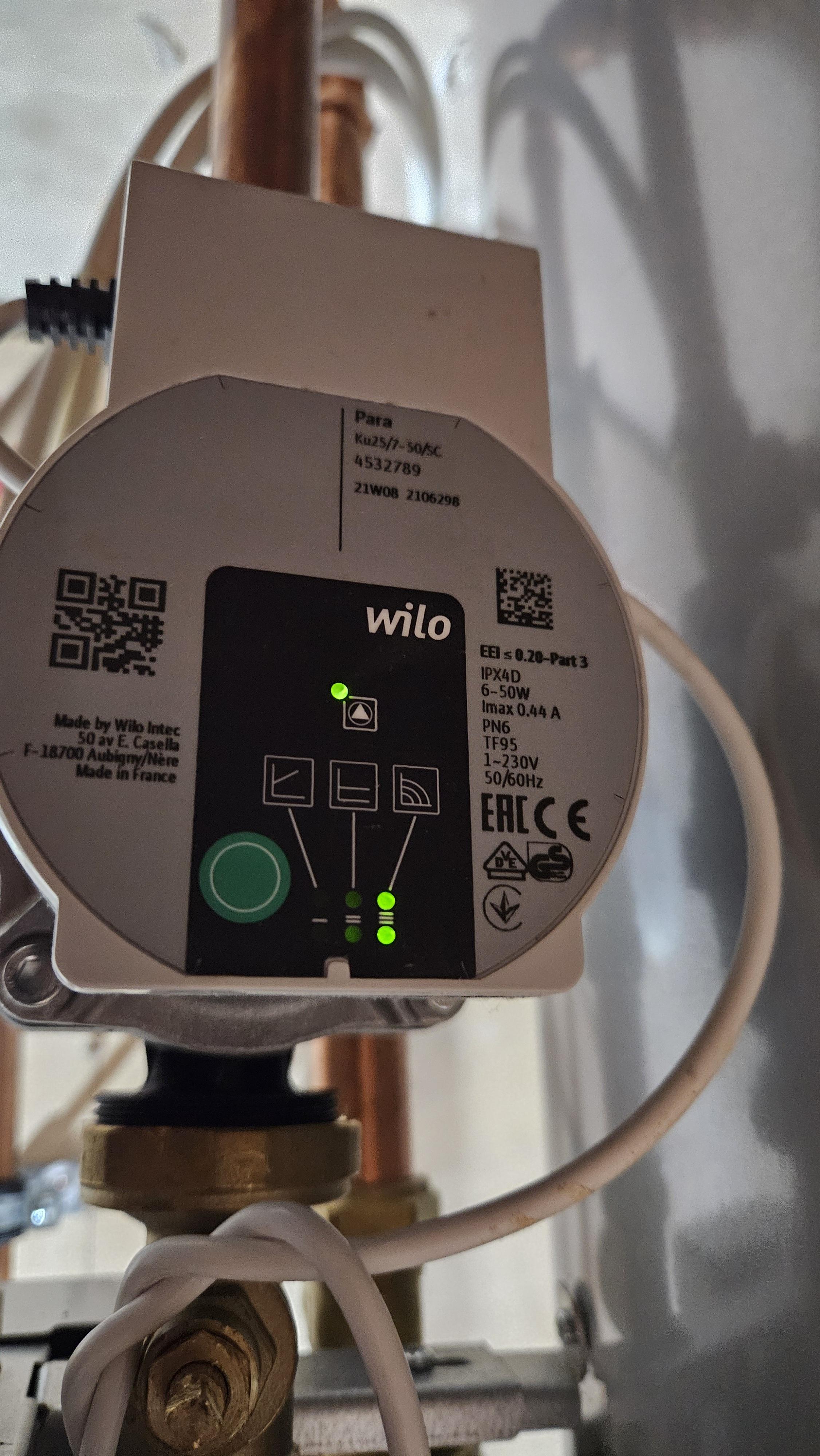

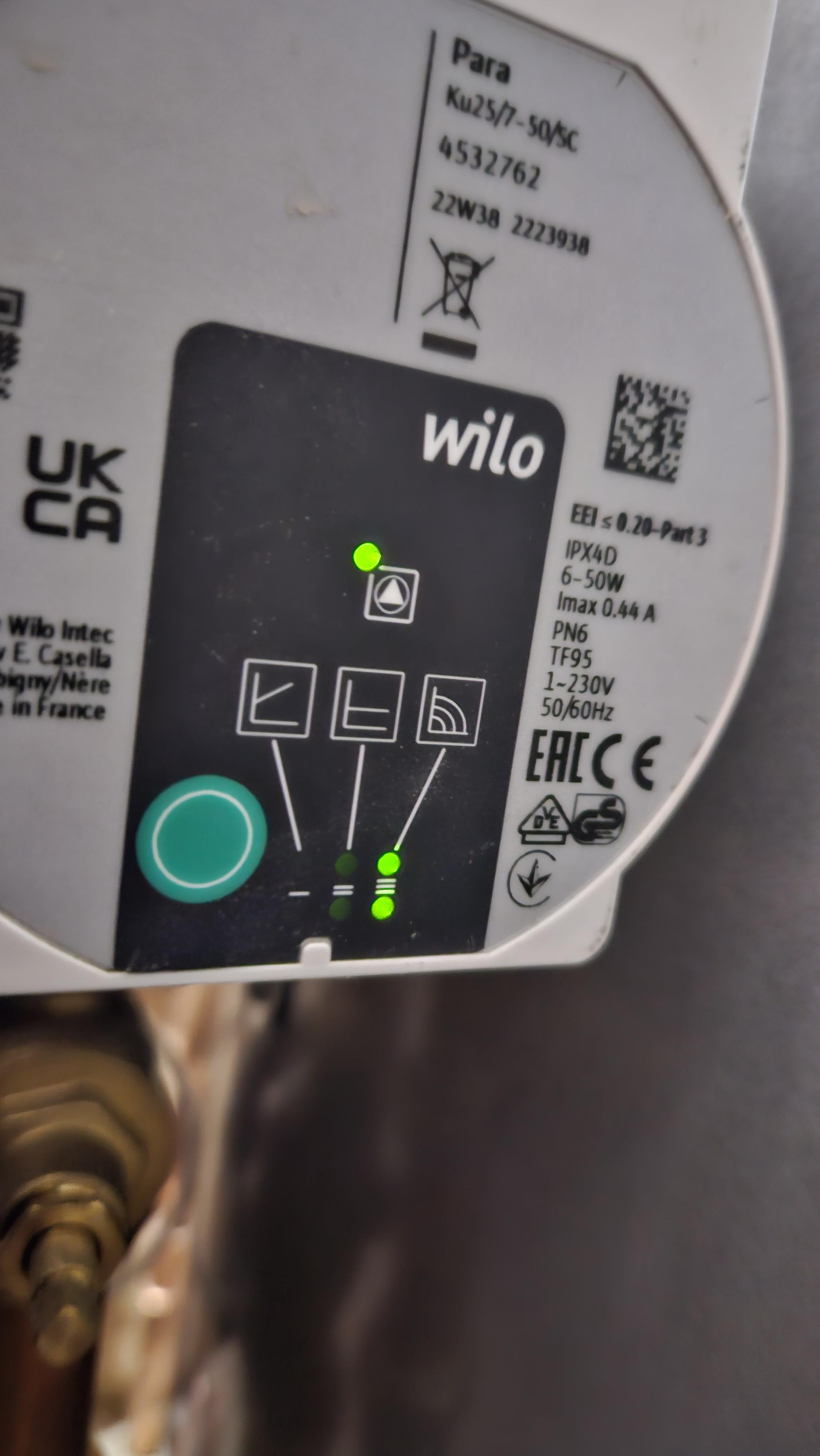

JohnMo Posted February 17 Share Posted February 17 Can you take a photo of the flow and return pump settings and the set up of the valves and label what they do. It makes a noise but not easy to diagnose without having a basis to diagnose against. Information is is good. Link to comment Share on other sites More sharing options...
Fraser Lamont Posted February 17 Author Share Posted February 17 7 hours ago, JohnMo said: Can you take a photo of the flow and return pump settings and the set up of the valves and label what they do. It makes a noise but not easy to diagnose without having a basis to diagnose against. Information is is good. Thank you for your reply. I have got photographs of the 2 pumps, the flow and the return. I thought the settings were on CONSTANT SPEED and the correct CURVE (III). The noise is definitely from the Pumps speed increasing - this happens when the thermostat temperature has been reached and the heating is turning off. The noise of the pumps doubles as the speed increases. Can this be from an external (SAMSUNG GEN6 Controller) sending another signal to the pumps? I went through some of the settings, the installer obviously didn't. I only have heating, no AIRCON with the system - should my Controller be set to HEAT ONLY? The setting on the machine just now is HEAT & COOLING. I changed it to HEAT ONLY and activated the heating, then turned it off and the pumps still increased the speed/noise. Should I restart the Controller if I change that setting, if so, how? Another thing. Twice during the winter I ran out of Hot Water. I checked the machine and the setting for BACKUP HEAT was turned off. I have another property with a GSHP and the default setting for that is on (6kw), so I'm confused why I'd run out of Hot Water with the ASHP. Is that the correct setting for the electric water heater to help boost the hot water when it's very cold? Many Thanks Link to comment Share on other sites More sharing options...

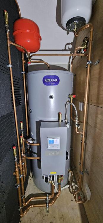

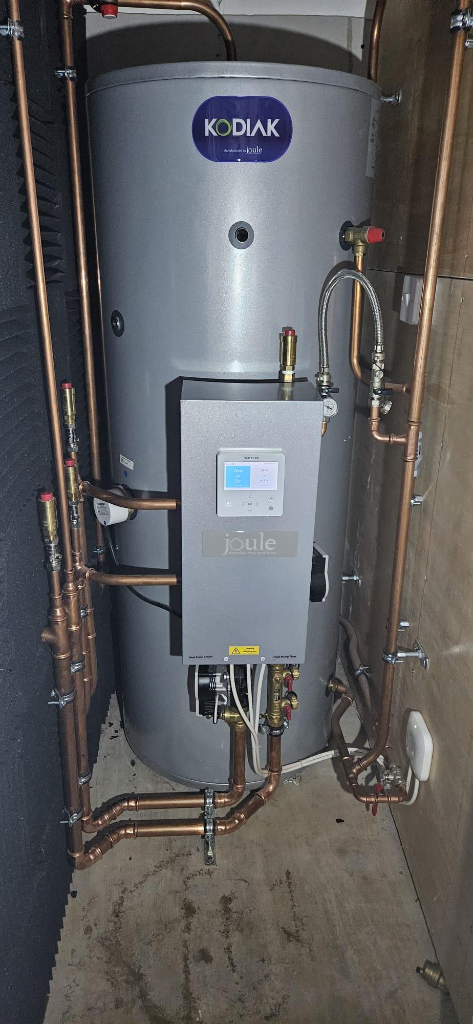

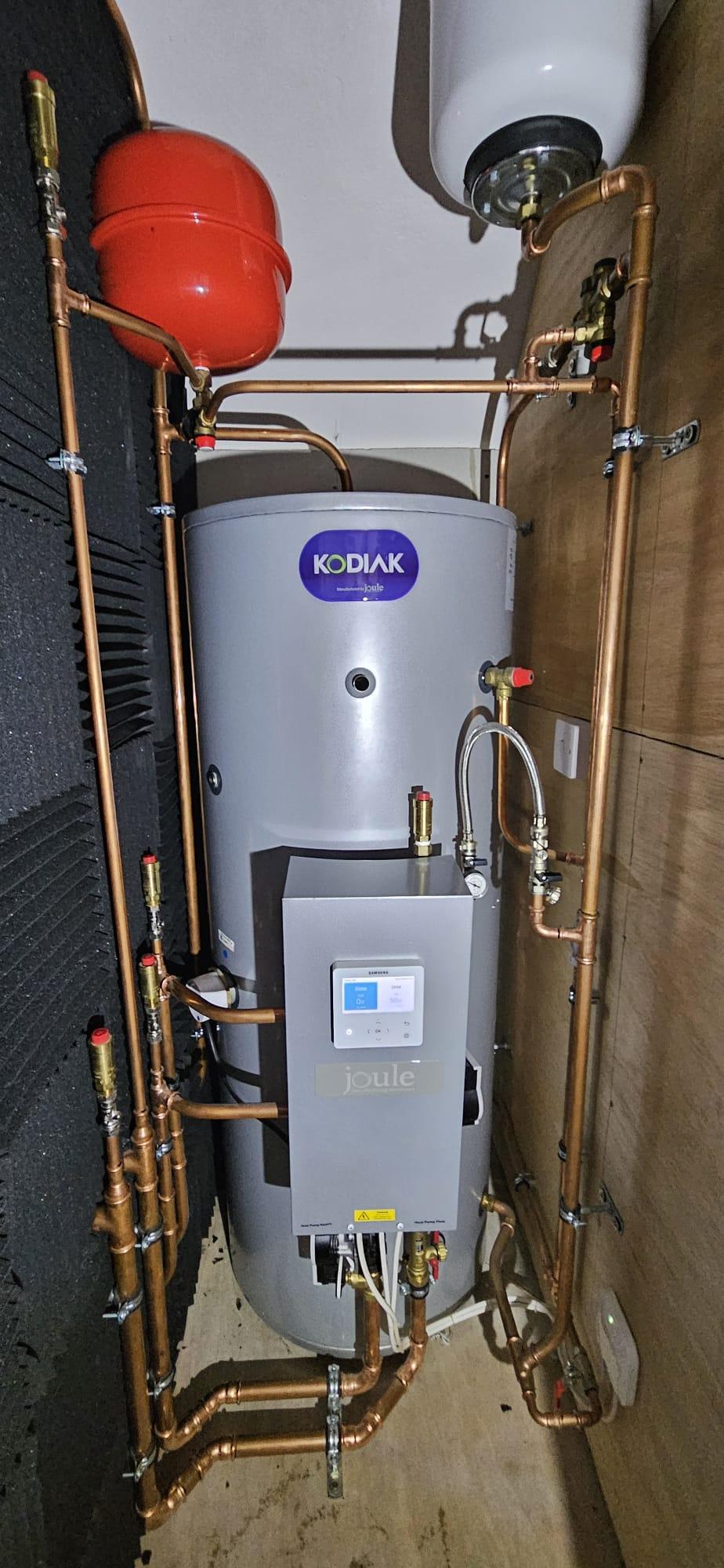

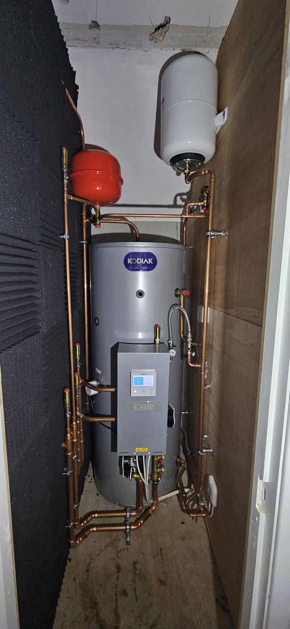

dpmiller Posted February 18 Share Posted February 18 take a photo of the tank for us plz Link to comment Share on other sites More sharing options...
Fraser Lamont Posted February 18 Author Share Posted February 18 3 hours ago, dpmiller said: take a photo of the tank for us plz Hi, thanks for your reply, here's the indoor system photo's Link to comment Share on other sites More sharing options...
dpmiller Posted February 18 Share Posted February 18 oddly enough if you look at the Joule website, Kodiak has an internal 2-port valve? More investigation might be required... https://www.jouleuk.co.uk/products/kodiak-pre-plumb-ie/ Link to comment Share on other sites More sharing options...
Fraser Lamont Posted February 18 Author Share Posted February 18 3 hours ago, dpmiller said: take a photo of the tank for us plz and here's a video of the system running. Say the temp in the house is 23, I increase the temp on the NEST up to 24 to bring the system on, then lower it to say, 21, to turn it off, the bigger the difference between the required temp (in this case 21 on the NEST Controller), the actual temp in the house (in this case 23) - the longer the increase in speed/noise occurs in the pumps. That's why I'm wondering if the SAMSUNG GEN 6 setting for 'INDOOR ZONE' should be 'HEAT ONLY' instead of 'HEAT & COOL'. I tried using the 'HEAT ONLY' but I didn't restart the Controller, it behaved in the same way. There is only 1 zone in the house, all radiator valves are manual and open. JOULE (UK) told me there are actuators instead of of a 3-way valve and the actuators stay in the final position of what was last running (DHW/RAD). The Tech at JOULE wasn't sure if the pumps were cycling for something to do with the Heat Exchanger in the External Unit. Link to video where the pump speed and noise increases for a longer time where there was a bigger difference between required Heat (21) and actual temp (23) https://www.glenhaultin.co.uk/off-and-on.mp4 Link to comment Share on other sites More sharing options...
