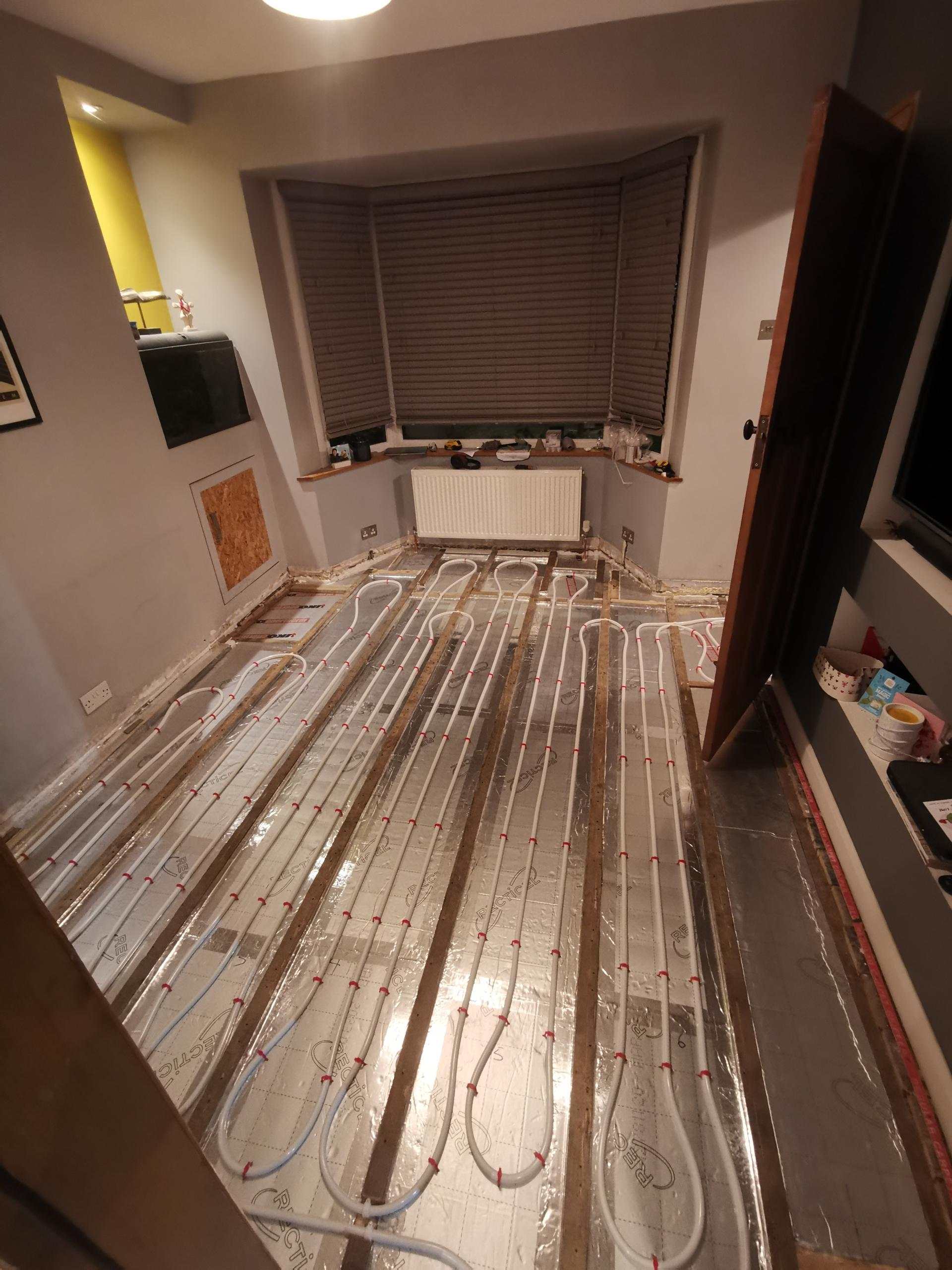

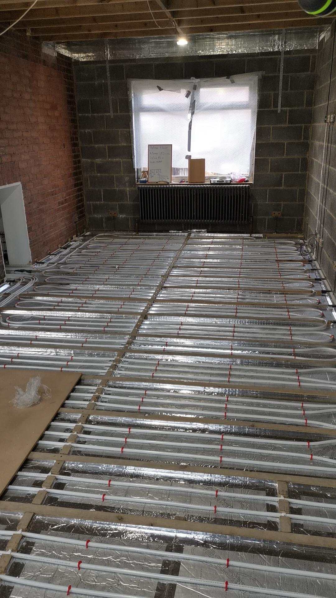

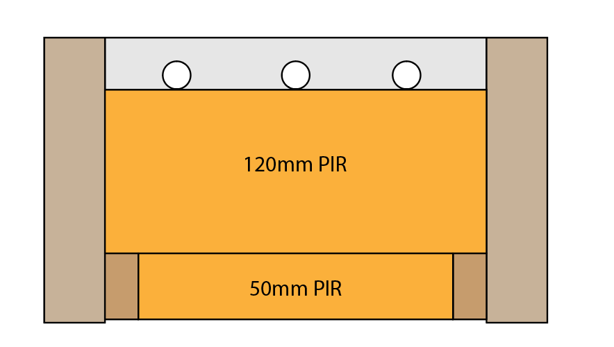

Super_Paulie Posted February 14, 2024 Share Posted February 14, 2024 as long as the EPS70 doesnt enclose in the bottom of the joists it'll be ok. The bottoms need to be left exposed to the air under there. See attached for what i have done in my own in terms of insulation, the lower 50mm is held on nails and the whole lot foamed and taped in. So long as your UFH system and design is sound, i dont see any real issues. JohnMo and Nick on here will be along soon im imagine, i got most of my top quality info from them in terms of buffer tanks etc. Link to comment Share on other sites More sharing options...
SoliD Posted February 14, 2024 Author Share Posted February 14, 2024 (edited) yep, will be attached to the pir with joists free to breathe, did think about cross laying it and leaving occasional air gaps, but then crossed that off the list as a stupid idea, although not quite thought of how to attach it to the PIR yet, could I use some sort of grab adhesive like sticks like s***. Up until yesterday it was just going to be 100mm PIR, until I read more and more about the importance of the insulation under UFH. Would it be worth adding EPS to the non UFH sections too as the cost uplift isn't huge and if i'm under there may as well get it done. Edited February 14, 2024 by SoliD Link to comment Share on other sites More sharing options...
Super_Paulie Posted February 14, 2024 Share Posted February 14, 2024 i have my lower PIR attached by using clout nails into the battens and then pushing the 50mm into those nails so its held in that way, then foamed and taped. Then the 120mm over the top, staggering the joins and again foamed and taped. Yeah, the more insulation the better as far as im concerned, i have mine over the entire ground floor no matter if it has UFH over it or not, such as under the kitchen and island units. Link to comment Share on other sites More sharing options...

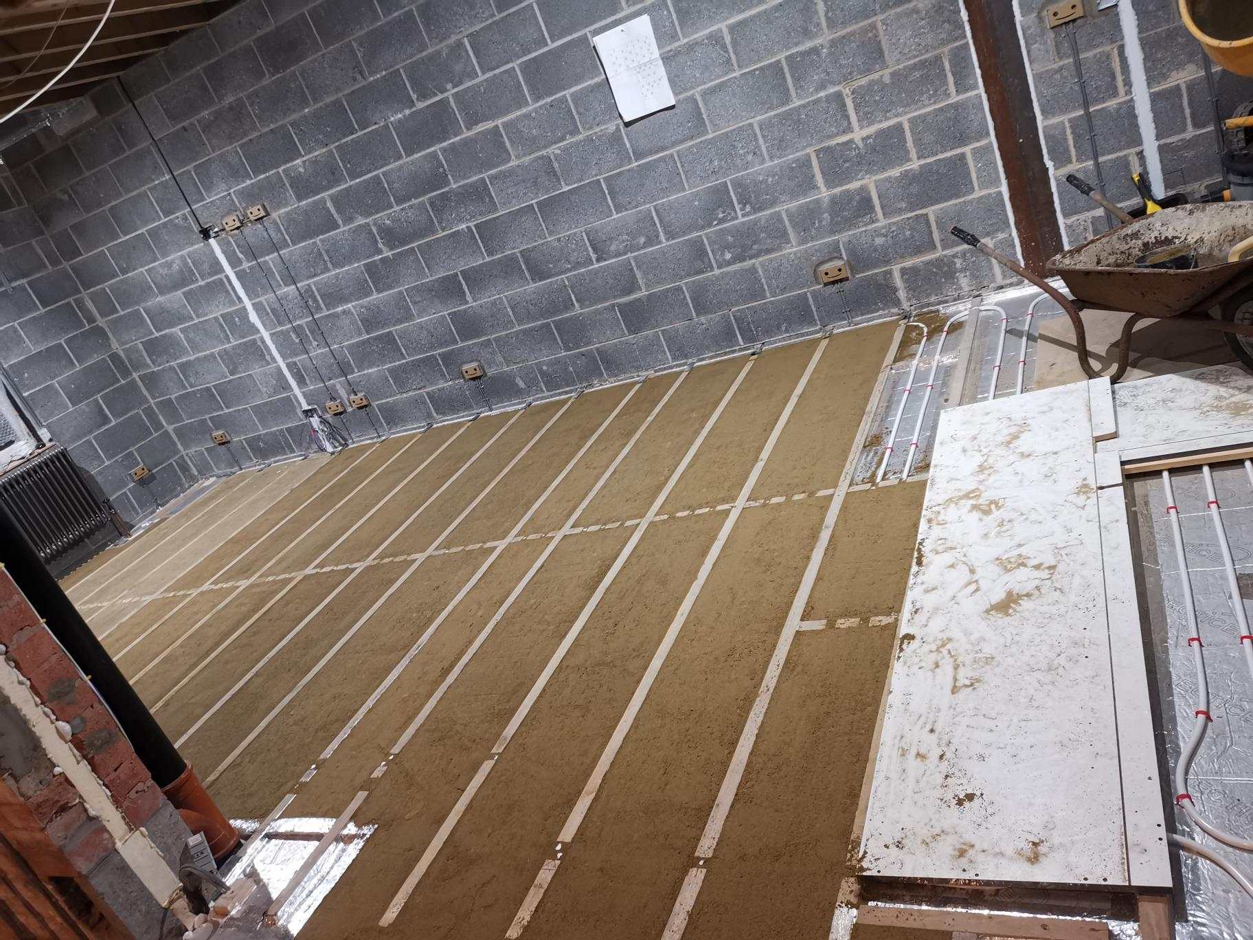

JohnMo Posted February 15, 2024 Share Posted February 15, 2024 Main things I would think about Good insulation as the air below the floor is much colder than soil so losses downwards can be quite big. Especially if you heed the next thing The other is keeping the upward thermal resistance low. Otherwise the flow temperature though the loops can be very high to get through. Another way to do the insulation is use a breather membrane and allow to droop between joists then add mineral wool. Can see two clear advantages, airtightness and getting a good smug fit of the insulation first time. 19 hours ago, SoliD said: wet UFH heating system to replace the lonely radiator. Then just replace the floor boards and utilise your existing radiator or replace with a designer one. Way cheaper to run, system inertia matches the rest of the system. No additional pump to run, home to find for a manifold. Link to comment Share on other sites More sharing options...

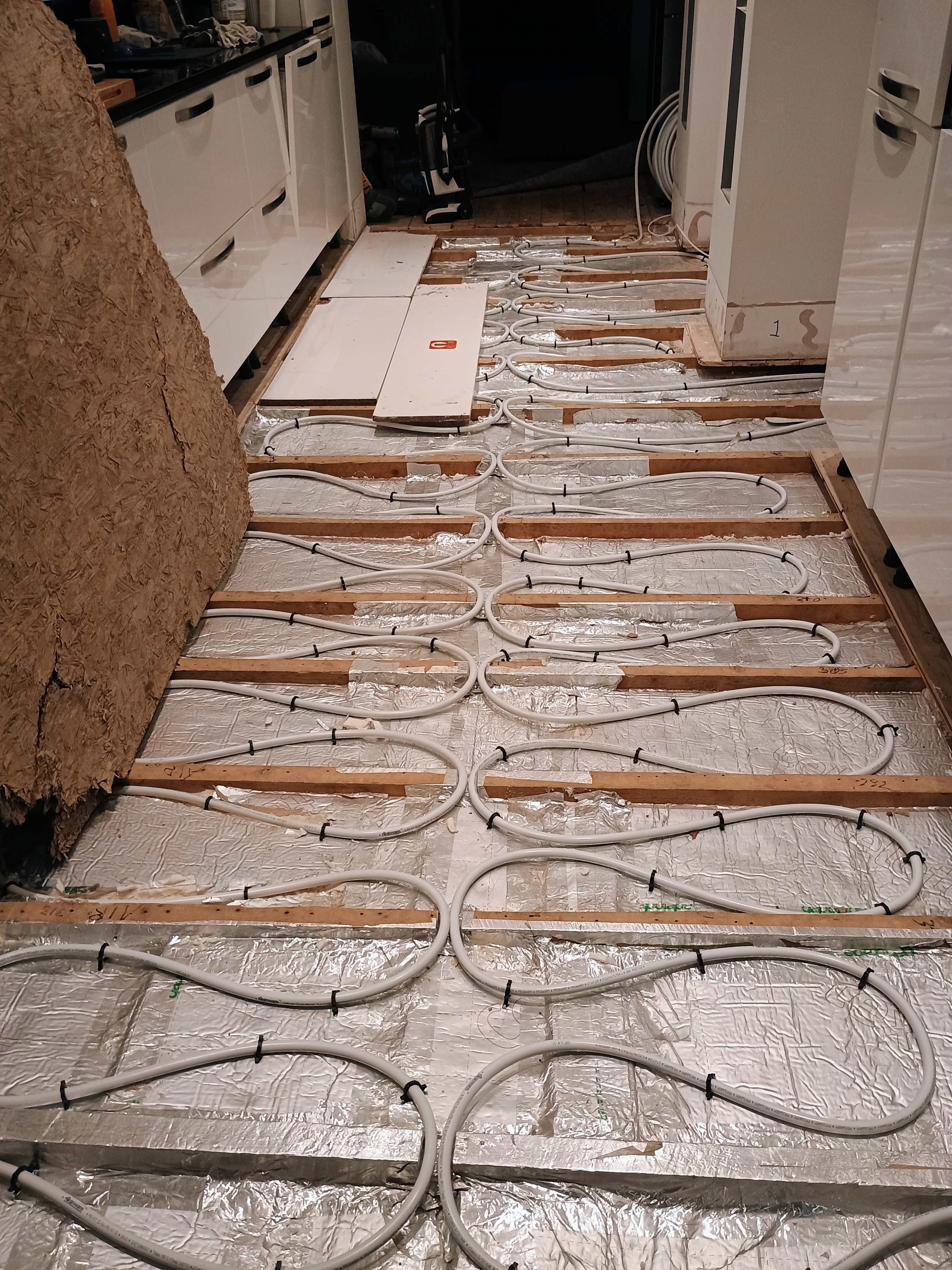

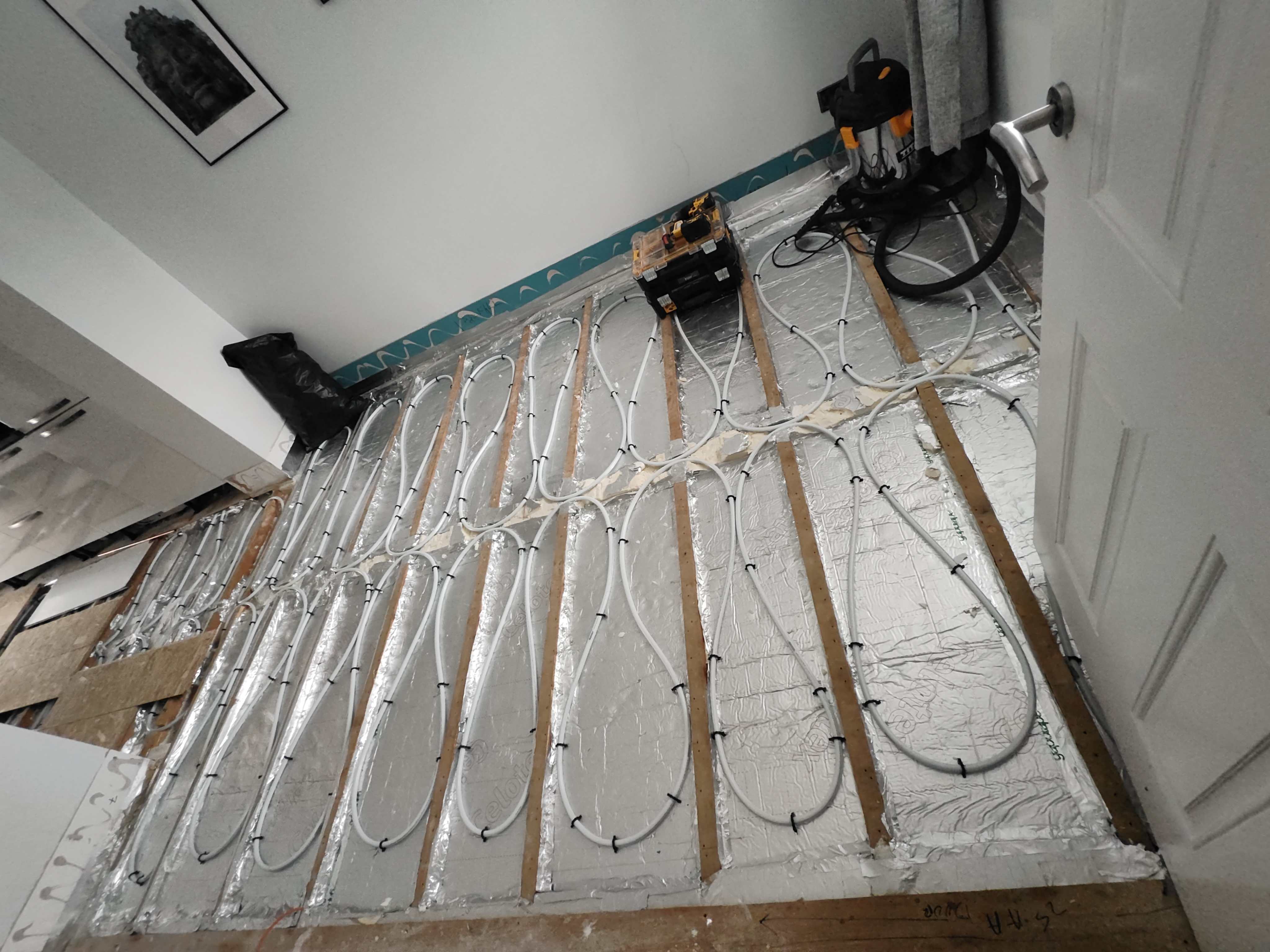

SoliD Posted February 15, 2024 Author Share Posted February 15, 2024 Thanks. sorry the lonely radiator is not capable of putting out enough heat for the kitchen and dining room no matter how much it's insulated, it's a 9m long space... well planned by the previous owners. Despite putting a larger double rad which is 1.5m long from memory. There is no space in the kitchen area which is 6m of this length to put a rad as it's all cupboards, hence the move to UFH. Will ensure to minimise the resistance upwards, would be looking 18mm osb/chipboard with lvt on top, so minimal TOG rating. Link to comment Share on other sites More sharing options...

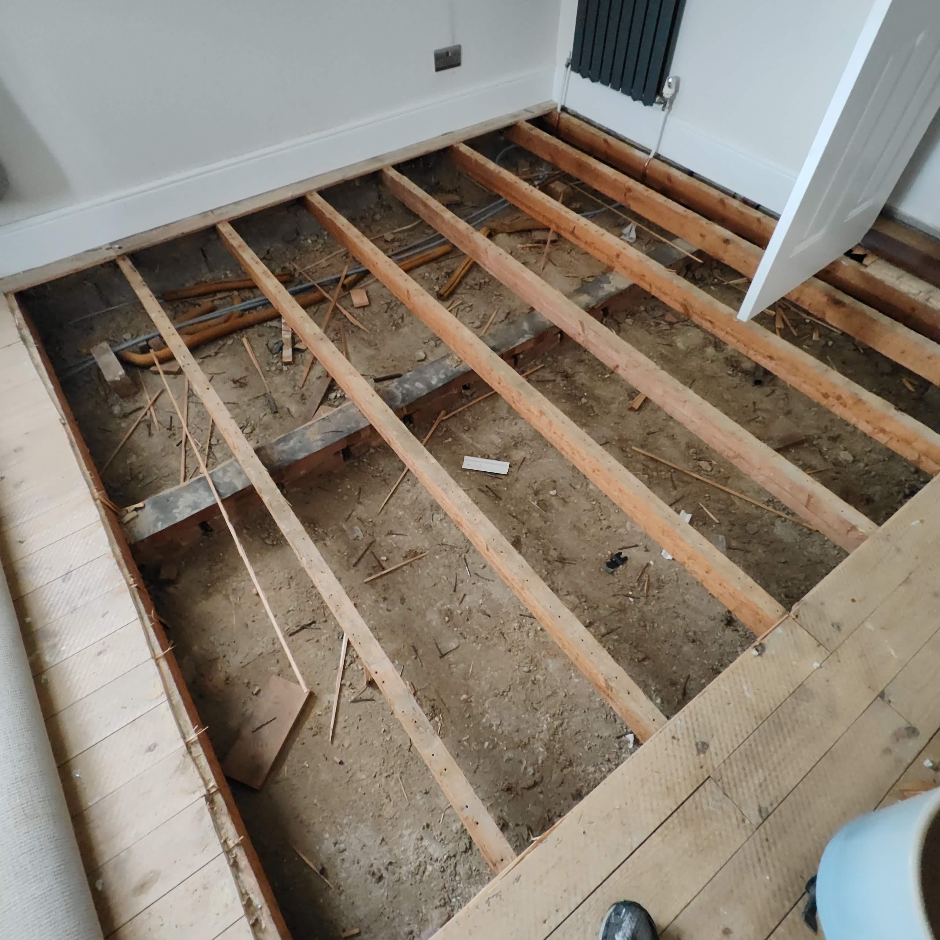

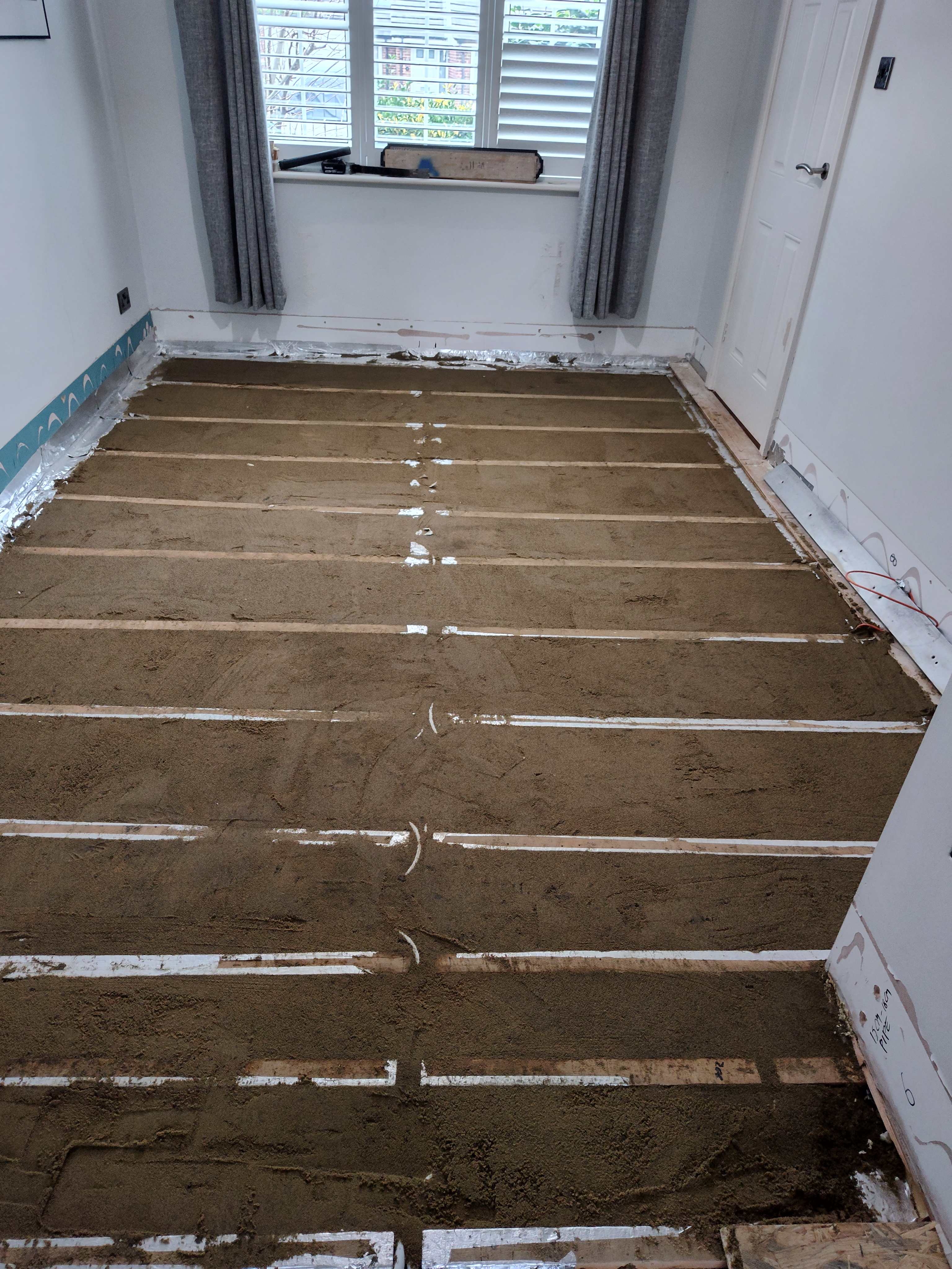

SoliD Posted February 27, 2024 Author Share Posted February 27, 2024 (edited) Started getting the floor up in the lounge. The concrete base here is no way near as deep as where I measured in the understairs cupboard, so i've got about 170mm under the joists to play with. Will get this tidied up and make a start on this half of the room tonight with some luck (depending upon how helpful the wife is with the clearing up ) Edited February 27, 2024 by SoliD Link to comment Share on other sites More sharing options...
joe90 Posted February 27, 2024 Share Posted February 27, 2024 Will you need UFH with all that insulation? Whilst the floor is up you could double the size of that radiator easily (cheaply) and/or run pipes to fit a plinth heater in your kitchen. As @JohnMo says UFH requires way more kit to be installed. Link to comment Share on other sites More sharing options...
SoliD Posted February 27, 2024 Author Share Posted February 27, 2024 (edited) This is the lounge, not putting in UFH here. UFH is only going in the kitchen room, am considering plinth heaters, but had them before and as nice as the blowing warm air is, there is the additional comfort element that UFH provides. Edited February 27, 2024 by SoliD 1 Link to comment Share on other sites More sharing options...
SoliD Posted March 4, 2024 Author Share Posted March 4, 2024 got half the lounge done and back together now, measuring 1c warmer on the insulated sides carpet currently, now to crack on and do the other half. Bit faffy, but unfortunately limited on space to move furniture due to a 3 month old puppy, although her barking at me sat on the joists was pretty funny , looked at the taped up celotex with quite a lot of scepticism Link to comment Share on other sites More sharing options...

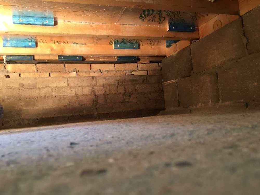

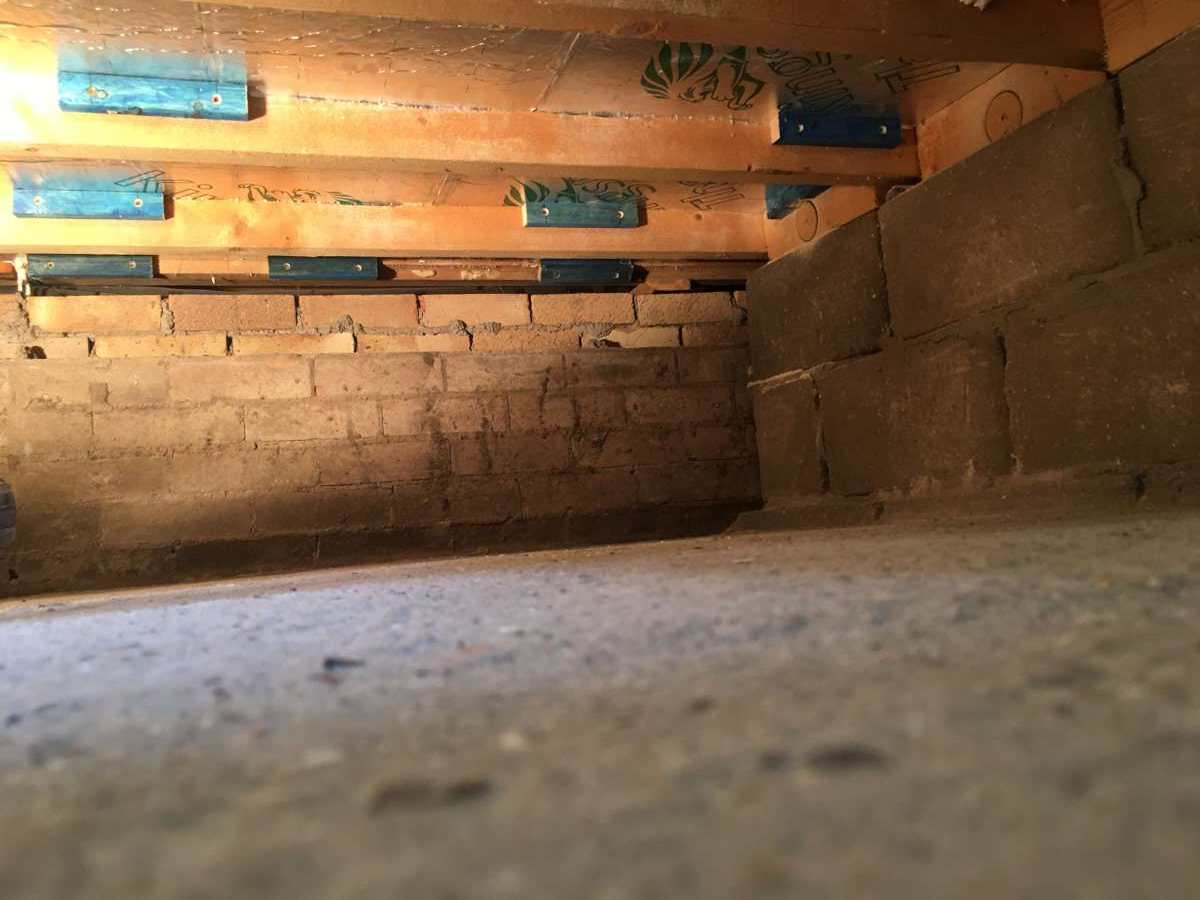

SoliD Posted June 10, 2024 Author Share Posted June 10, 2024 I hadn't CAJ, Celotex is so easy to cut to size and much easier to store for me outside as I do the rooms. Especially with the 100mm version as even with the joists being far from straight I can get them in and fill as necessary with foam if required and then tape straight up. Hallway is complete now and even managed to get into the troublesome crawlspace below the stairs (2ft high....) Which took far longer than expected, taking the floorboards out of here was fun :D, but i've also been tarting it up into a hideaway for our Puppy. Few weeks break now until back from Holiday and then will get cracking with the kitchen/dining room, which should be more straight forward being square open spaces. VID_20240608_111023645.mp4 Link to comment Share on other sites More sharing options...
JohnnyC Posted August 6, 2024 Share Posted August 6, 2024 Hello, Thanks for sharing this. I am considering doing something similar in my ground floor. Quick question about the battens. Did you use treated or untreated ones? Thanks in advance! Link to comment Share on other sites More sharing options...
marshian Posted August 16, 2024 Share Posted August 16, 2024 On 06/08/2024 at 15:22, JohnnyC said: Hello, Thanks for sharing this. I am considering doing something similar in my ground floor. Quick question about the battens. Did you use treated or untreated ones? Thanks in advance! I did very similar and I used treated tile batten to hold the PIR up (I did all my insulation from below the suspended floors as I have a 2-3 ft crawl space. Link to comment Share on other sites More sharing options...
SoliD Posted August 30, 2024 Author Share Posted August 30, 2024 in the end i didn't use many battens as I got the PIR super tight, and I had the brick suspending ghost walls for the joists that a lot of it sat on at one end. in the hallway I just filled it full with a layer of polystyrene and then PIR on top. (bar gaps for joist ventilation) Way OTT, but wanted to make sure it'd work and also meant I could walk on it without having to worry about slipping off a joist and pushing a piece of PIR Down Link to comment Share on other sites More sharing options...
