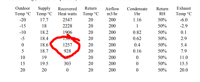

As we all know the efficiency of ASHPs is measured in COP or coefficient of performance. A good ASHP might have a COP of 4.
Heat Pumps? - Imgflip

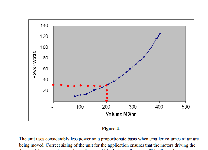

For a little light pre bedtime reading last week I was perusing the manual of my MVHR. unit . I happened upon a table.
Further reading led me to this.
Note that at zero degrees, nostril freezing cold, the MVHR unit recovers 1257W of heat whilst only expending 30W of electrical energy.
This corresponds to a COP of about 42.
Yup FORTY TWO.

Hmmmmmm .. Interesting spot and one wonders if these two factoids are conflatable in the way you have. One, the latter, refers, if I have it right, to the power consumption of the fan while the other has no input power of the rest of the unit while recovering the 1257 W and I guess it will be approximately 300-420W. If my estimations are correct then the fan around 10% of the power usage of the unit at this recovery and you are right 420W / 10 = 42 so that bit is right B|.
