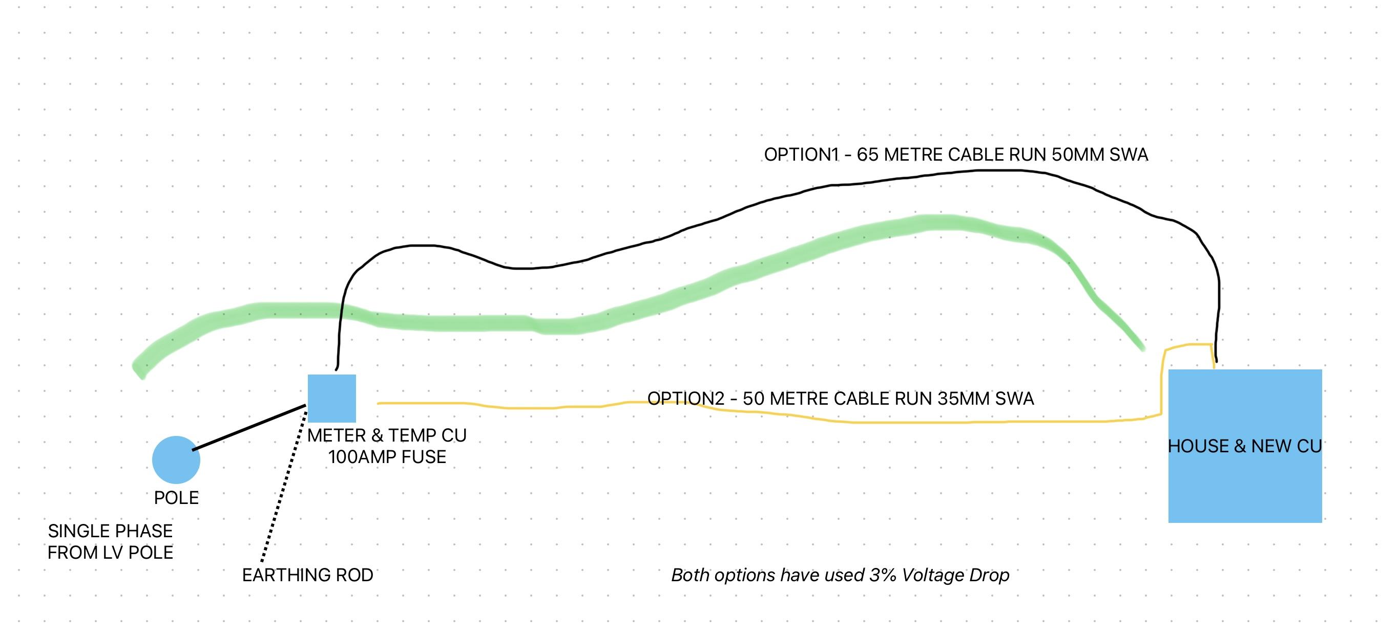

TonyE Posted February 6, 2024 Posted February 6, 2024 Hi everyone, I’m doing a self build and I’m planning/prepping to install the main feed for the house. When we got to site I had a new connection from SSE and this was taken from the pole into a temporary box which houses a mini CU, meter and 100 Amp fuse etc. I then use this supply to power my site/caravan. when SSE installed the connection the chap advised that when we build the house that we could then just run an SWA from this temporary box straight into our new house and its proper CU. This was explained as being much cheaper than getting them to come back out to move the meter and install a new electric cable/feed directly from pole to the house. So I have 2 options, as per my picture below…. It’s a long run from the temp box and both options require a fair trench digging (trench: 450mm deep, 110mm twin wall conduit, bedded on sand and with marker tape). Taking into account the voltage drop and wanting to get the max out of the Single Phase supply (I have GSHP etc) I see a 100 amp fuse in the temp box; the SWA calcs say either a 35MM SWA for one option (shorter run) or a 50MM SWA for the other option…. Can anyone offer advice on this intended setup, the size of SWA and also the amount of cores required? I think I need 5 core so I can re-use the earthing rod that’s already installed… but am I right? Or is it better with 4 cores and then I need a new earthing around the house? Advice appreciated!
ProDave Posted February 6, 2024 Posted February 6, 2024 I would not put a 100A fuse in your switch fuse as you have no discrimination from the DNO's 100A fuse. I have mine fused at 80A and have never had any problem with lack of power. If you re run the calcs at 80A you might get better cable size options. You mention 5 core so you are talking 3 phase neutral and earth, so no way will you ever require anything like 100A per phase if you have a 3 phase supply.
TonyE Posted February 6, 2024 Author Posted February 6, 2024 Thanks for the advice. 80 AMP switch fuse, I assume that will be installed inside the temp box? I’ll re-run the SWA calcs based on this load. Regards the cores of the SWA, I have a single phase supply…. From your reply, as it’s not 3 phase, you say I don’t need 5 core. But what amount of cores is required. Thanks
TonyE Posted February 6, 2024 Author Posted February 6, 2024 I’ve also recalculated the SWA using 80AMP and it still requires either 50MM for the longer run and 35MM for the shorter run…… ho-hum. On similar posts on this forum, I see that using 50MM inside the CU can be very tight…. IMHO I’d like to route the cable on the 65m run (alongside a road) instead of having to go off-road (steep-incline) with the shorter run. So in summary I think the advice is: 80Amp Fuse Switch, 50MM SWA, 3 core?

ProDave Posted February 6, 2024 Posted February 6, 2024 46 minutes ago, TonyE said: Regards the cores of the SWA, I have a single phase supply…. From your reply, as it’s not 3 phase, you say I don’t need 5 core. But what amount of cores is required. 3 core, Live Neutral and Earth. You also clamp the armour of the SWA in the correct type of gland as an additional earth.
