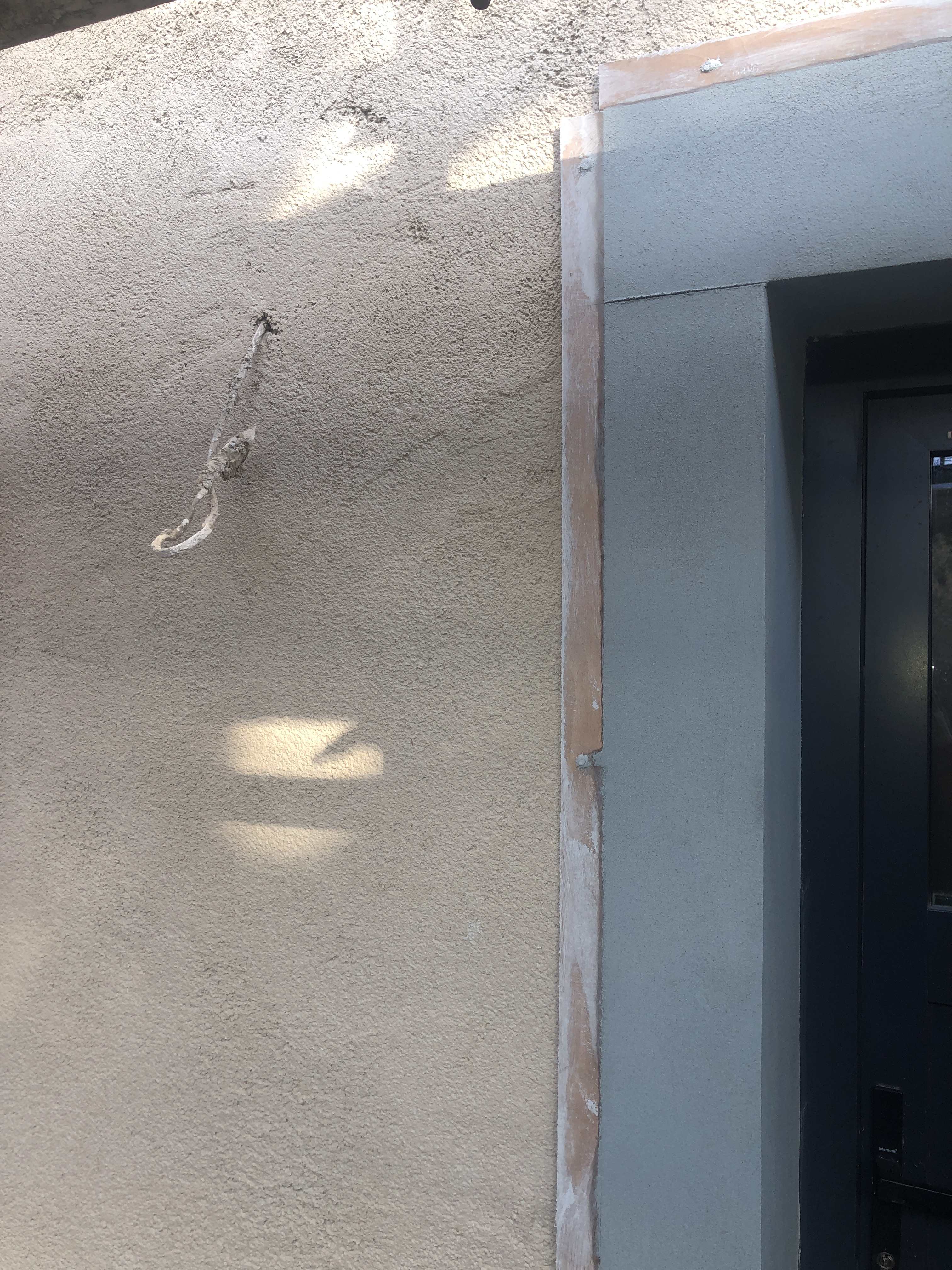

renovator123 Posted October 23, 2024 Author Share Posted October 23, 2024 Update: we weren't impressed at all with the Cork Sol info and found it easier to get Diathonite installers. The other options seem rarely used externally and won't help so much with air tightness or mould. Diathonite is excellent, not fully cured for a few months (but dry to touch and re-coatable). We had advice that we should have XPS plinth across the bottom where we get a lot of water spray - on to get a bead on it so that the XPS can be recoated in future years/decades if there is water damage. The same top coat is on both and it looks awesome. We had a few external concrete window sills so got those knocked out and replaced with XPS, which is ridiculously loud when it rains (or was until the top coat was on). Diathonite has greatly improved the air tightness (less drafty), and the mould situation too (because it's alkaline and because damp can move to the outside). It's a colored top coat so no painting needed. To keep moisture moving from inside to outside needs lime plaster or similar, although there's still a lot of benefits with gypsum... a lot of internal plaster is persistently mouldy or blown so needs sorting anyway. One part is so mouldy that the metal edging under the plaster has rusted through. It's very noticeable how warm it is overnight and the phase shift of the thermal mass. No good pics yet since top coat is still in progress and has to dry gradually before you get to the final color. It's already much better than the concrete render (which had a lot of damage). Diathonite evolution is a sandy color going on, drying to light grey. Top coat is by Lime Green in woad blue. The window bands need reforming unless you want to just paint them on after. Link to comment Share on other sites More sharing options...
