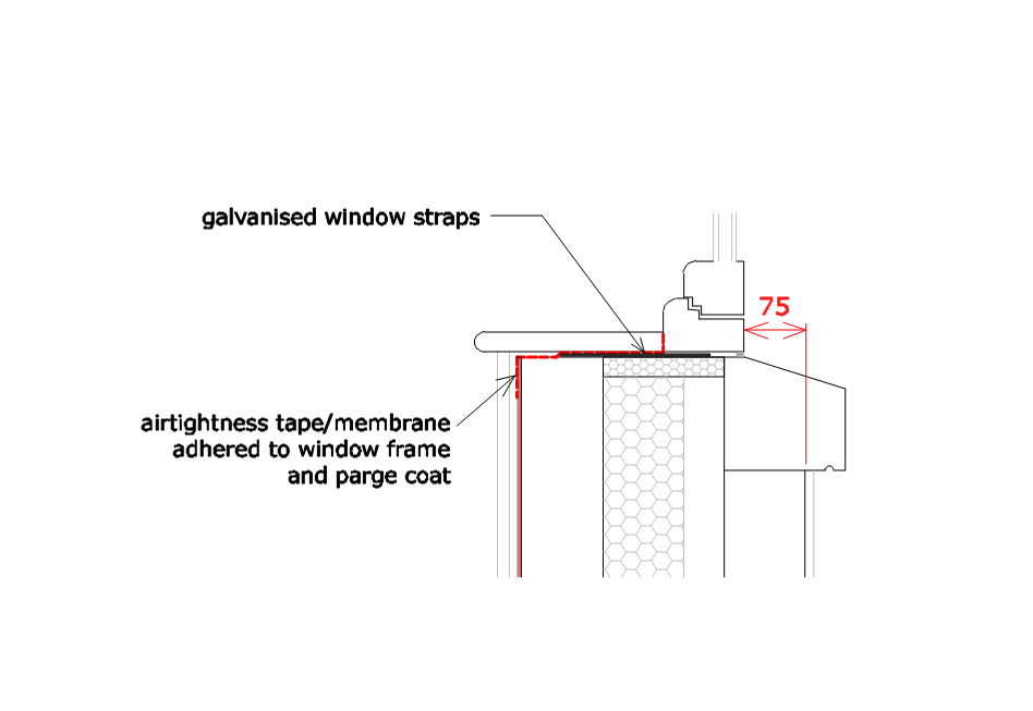

Dave Anderson Posted January 27, 2024 Share Posted January 27, 2024 We're about to appoint a builder to demolish an existing bungalow and build the shell for our replacement bungalow (in Lancashire). The design and drawings, building regs etc are all our own work, ie no Architect involved. I've seen a few threads on here discussing window position ie how much to overlap the cavity, and thinking this through leads to a few related queries. Diagram below: The walls are rendered blockwork (or stone to the front elevation), 150mm cavity with 100mm PIR, 100mm aerated blockwork with parge coat, and plasterboard on dabs. The windows are 100mm thick frames (Residence Collection R9).The diagram shows my proposed position. 1. This position gives 75mm overlap into the cavity, which does not seem to comply with the building regs requirement for 30-50mm overlap. Am I right to assume the 30-50mm can be regarded as a minimum? I think it is recognised best practice to push the window fully in line with the cavity, but I don't want to go that far. Does this position as drawn look OK to people? 2. I've read about window frame drainage, which can be face drained (ie with ugly holes showing) or through a stub sill, which I think gives a messy detail when overlapping a stone sill (or concrete). Is there a way of doing it as drawn? I'm struggling to get full engagement on this detail with the window supplier at this stage - the sales/managerial staff just seem to want to leave it to their surveyor to sort out once the walls are built. But potentially it could influence the shape of the stone sill, so needs to be decided now. 3. The cavity closers I have seen are quite flimsy. Are there some that are able to support the weight of the window? Otherwise it will have to be shimmed off just the 25mm inner edge of the stone sill. How are windows supported when they are placed fully within the cavity? Hope this all makes sense. I'd be really grateful for any advice or comments. Link to comment Share on other sites More sharing options...
nod Posted January 27, 2024 Share Posted January 27, 2024 Leaving 50 mil on the outside reveal for the render or face brick is the ideal and works well on the inside fixing straps Link to comment Share on other sites More sharing options...
Dave Anderson Posted January 27, 2024 Author Share Posted January 27, 2024 Thanks nod, so that would put my windows 50mm into the cavity which is ok with regs. And the windows would be better supported. And give us wider window boards! But I guess there would be slightly more of a cold bridge as the frame would not overlap the main body of insulation? Link to comment Share on other sites More sharing options...
nod Posted January 27, 2024 Share Posted January 27, 2024 Yes that’s fine 50 mil works great with a render bead Giving a 65 mil outer reveal Link to comment Share on other sites More sharing options...
