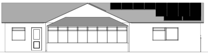

Below is a view of the side of my house, showing the existing conservatory, with lean to, hipped roof.
I am removing the polycarbonate roof and glass, retaining the dwarf walls and foundations.

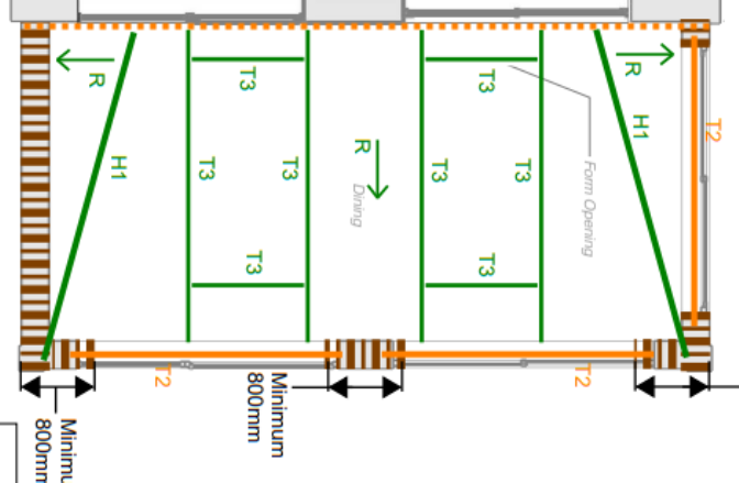

New timber frame walls and roof will then be going on. Below is the SE's roof design thus far. T3s surround the rooflites. H1 are hips. T2 are headers over the doors / windows.
SE has specified roof timbers in 200 x 50, as span across the room is 3.4m. Jack rafters are max 1 meter span

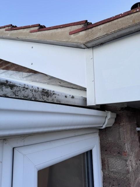

Now the issue at hand is the space between the new timberframe head plate, and the existing gable wall undercloak board is limited. The current conservatory window / door frames are 2100mm high, top frame is about 80 mm, then roof is about 60mm, so total height is 2240mm. There is then a 35mm gap and then 165mm barge board.
Ive done a rough sketch below showing the new timber frame against the gable wall, with the top of the top plate siting at 2400mm. This leaves about 120mm to play with for rafters and roof covering, which doesnt currently work, given the SE wants 200mm rafters.

My only solution at present is to reduce the top plate height to 2350mm and change the rafters to 150mm. Im pretty sure the jack rafters could be 150mm, given minimal span, but haven't asked the SE yet.

Instead on sitting rafters on top of wall plate you could notch them over the wall plate and support the lower edge with hangers onto wall plate. This would reduce your height while keeping the full depth rafter

One thing I have now come across is a "Dutch Gable" where one essentially extends the existing roof at the base, then form a hip part way up. This I think will solve my problem

Well, I spoke too soon.
Transpires that the original house, 1970s build, has an extra brick course on the left side vs the right. Im not even sure how that happens, given bricks are done in lines.
So I have 2560mm from DPC to undercloak board on the left, and 2440mm on the right, which makes the above plan impossible now, as the fascia boards will never align.
So I think my only option now is to lower the wall plate to 2350mm, then mount rafters on hangers on inside to allow enough space to fit a new tiled roof under the current one.
