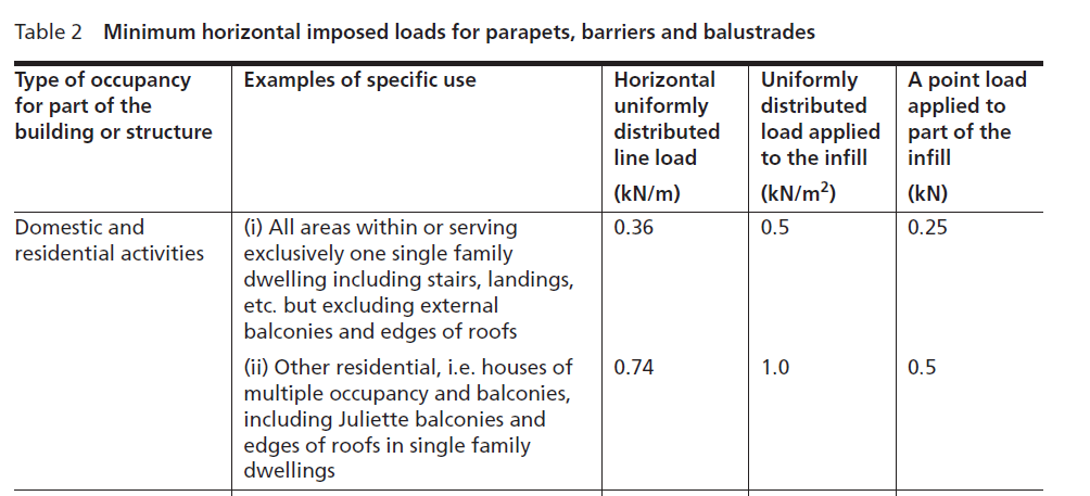

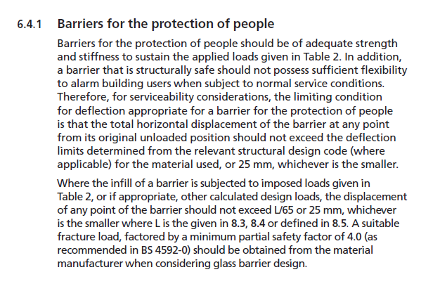

Gus Potter Posted January 29, 2024 Posted January 29, 2024 On 27/01/2024 at 21:15, MortarThePoint said: but it feels solid. Well that's a good start! To keep you on the right side of things below are the design loadings from BS 6180 for domestic internal stairs, landings etc. Your on the top line. Often the governing load for the hand rail is the horizontally uniformly distributed load of 0.36 kN/m (~36 kg per metre run of hand rail) and this load usually get transferred to the top of the hand rail. An important point here is that these are unfactored loadings.. thus no factor of safety built in. The other important bit is the deflection of the overall asssembly, from the same code The 25mm deflection is a key requirement. If you want have a test of what you have. Take your hand rail length just say 3.0m and calculate the horizontal force at the top from the hand rail 3.0m x 0.36 kN/m / 2 = 0.54 kN (~54 kg) Get a spring scale ( for weighing fish or something) and apply that load to the top of the uni strut. See how much it deflects by < 25mm Next test for strength using the Eurocode factors of safety. Take the 0.54 kN load and and multipy by load factor of 1.5 = 0.54 x 1.5 = 0.81 kN ~ 80kg Also make an allowance for material defects that may manifest later. Apply a material factor of 1.3 thus 80kg x 1.3 = 104kg ~= 1.02 kN test load. Two things to remember. You are testing the newal post in isolation here and I'm not taking into account the potential bracing effect of the handrail running perpendicular to the newal post down the sloping part of the stair. Some may and rightly say.. it's always stiffer than that once you put things together. I say.. your often right but can you imagine how hard that is to prove? and also you can often shift the problem somewhere else if you shed load from the newal post. On the other hand 104 kg is about 16 stones.. there are plenty folk that are heavier than that.. and if you have a Rugby team partying, a couple of big lads could push the thing close to its design limits. Report back.. check the deflections first in case the strut fails early. 1

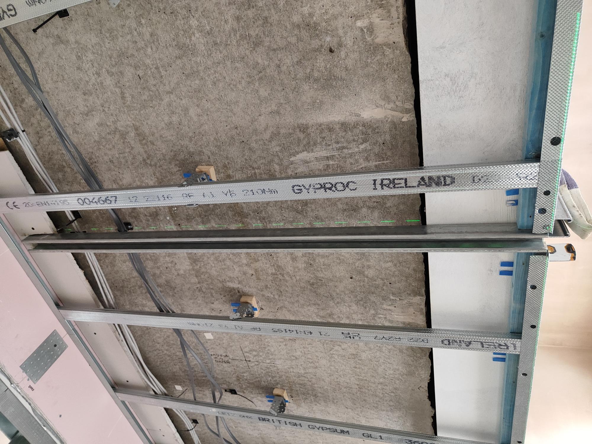

MortarThePoint Posted February 7, 2024 Author Posted February 7, 2024 (edited) Here's the Unistrut under the HCF to counter the beam roll/twist. I wanted to anchor it close to the secured side of the HCF to avoid HCF deflection rolling the beam As both bits of Unistrut are about the same length it should serve to halve the beam roll Edited February 7, 2024 by MortarThePoint
