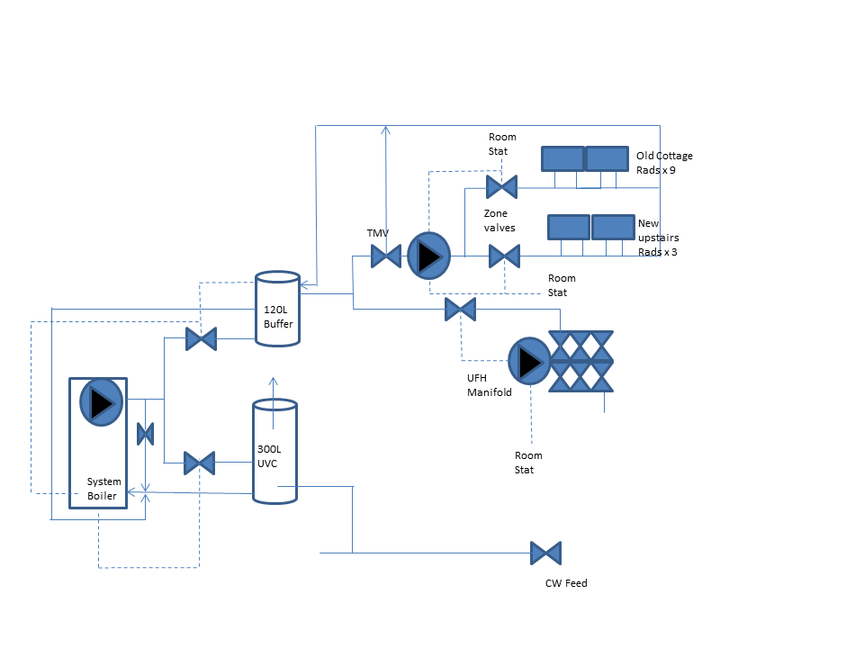

Telford seem a good bet for supplying my UVC. As per other post on UFH with rads but I will now site the tank in the cellar and have an external boiler (fluing from the cellar is a pig and looks expensive). So presume new system boiler and UVC or TS. Can't invest in solar now, or air-source hp as no funds left. See system below I got quoted from Greensquare.  Should I not have a buffer if going uvc?

Greensquare are wrong as they've shown in the schematic you posted ( was it their drawing to you? ) that their separating the rads and UFH circuits with zone valves. It would only be ok if the rads were on with the UFH in parallel at all times and even then it would be less than ideal.
Oil boilers like to run hard and long and are most efficient when doing so, and they don't modulate like gas and electric units can. An oil boiler firing just to put heat into your small UFH circuit would be unable to match the low demand as the UFH manifold wouldn't allow it to put more than ~35oC in at any time, and even less when the slab has warmed up.
Id say a buffer of 120L with oil would be a good match.

Yes, that's their schematic. So 120l buffer, 250l uvc (maybe 300l as 2 soon to be teenage girls in house?) and rads driven of the boiler direct? Does anyone have a schematic of that with controls? New outdoor boiler probable need to look at make and size (happy with my Grant vortex pro but indoor).

Return for the buffer seems to tee back into the boiler flow?
TMV for the rads has to have the flow and the return tappings from the buffer connected to it. Return tees off to pick up the 'cold' port of the TMV and then carries on to be the group return of all the rads, with rads flow coming from the 'mix' port of the TMV via the pump.
Components are in order just the plumbing of flow / return aren't schematically correct.
Getting close though :D
If your struggling I'll sketch something later. ;)

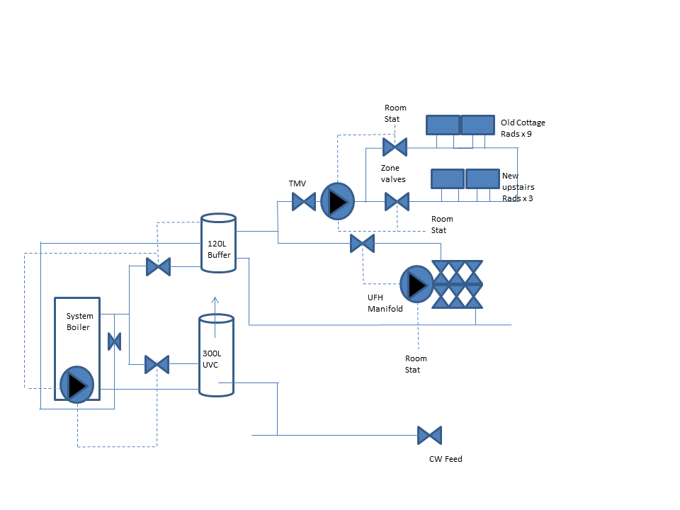

@Nickfromwales thanks. I've only got PowerPoint so difficult to sketch in it. Yes I see what you're seeing but I think it's just my drawing. The return from the buffer should go to the other side of the boiler pump as should the return from the uvc. A sketch would be great if you have time, advice on controls even better. The existing is drafty in comparison, will work on it in the future but esimated that it takes 12kw vs 2.5 kw for the new!

It may be a good idea to have two TMV's and two pumps, one setup for each radiator circuit so you can choose a higher temp for the cooler original part of the house and a lower temp for the new area. Either that, or run one TMV for the rads, set a lot higher to satisfy the cooler area, and then downsize the new rads to give off less heat for the same temp. Balancing the heat delivery off one rad TMV may be a bit crude.
Sketch to follow tomorrow eve, what do you need to know about the controls ? What make / model is the boiler ( so I can see if it needs to do pump overrun ) ?

1 hour ago, Silage said:
High praise indeed @Nickfromwales. now would you use the same tappings for rads and ufh as below or seperate? What other components
If your going to buy a buffer, then get two pairs of tappings, one for rads and one for Ufh. You don't really need them to be separate tbh, but if you do tee them off one pair of tappings then each flow pipe will need a single-check non return valve so when one pump is running and the other isn't, the one running can't pull cool or cold water back out of the other circuit ;).
Other than fine tuning what actually connects and exactly where, your looking good.
