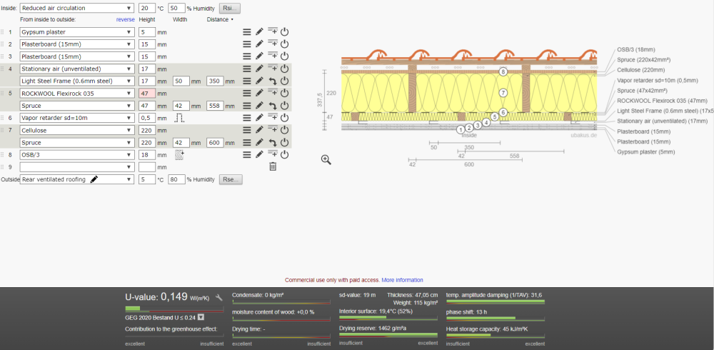

I would prefer to put a layer of 18mm OSB on top of the rafters. It's about the same mass/m2 but costs about £6/m2. It'd allow you to do a really top job here sealing any airpaths to prevent airborne noise entering in the first place. You'd need battens and counter battens to prevent pooling of any water that blows between the tiles.

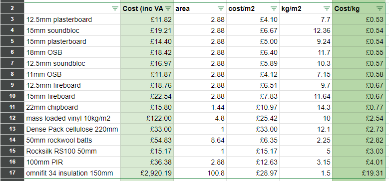

If you can get cellulose then it's got an installed density of 55kg/m3. Much better than mineral wool with a density of 10kg/m3 but more importantly it fills every single corner and really helps with airtightness too.
Here's an idea at today's prices. As you can see insulation is also a very dear way to add mass. Plasterboard, Soundbloc and OSB are all about the same.

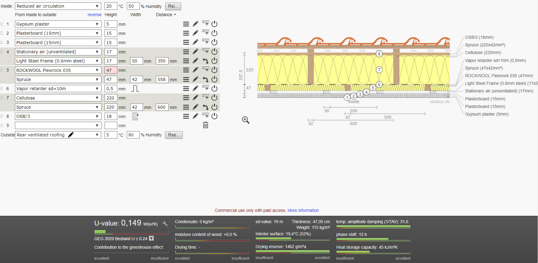

How about the following buildup.
Roof Tiles,
Tile battens
Counter battens
Breather membrane.
18mm OSB sealed with flexible sealant at all joints. care taken at edges to do the same with appropriate noggins to block every airpath.
220mm Rafters with dense packed cellulose.
A/T membrane.
50mm battens at 600cc  with rockwool rwa45 infill at 90 deg to rafters.
17mm Resilient bars at 90deg to battens.
15mm plasterboard sealed with acoustic sealant
15mm plasterboard sealed with acoustic sealant. No penetrations other than a wire for pendant lights sealed with acoustic sealant.
Skim

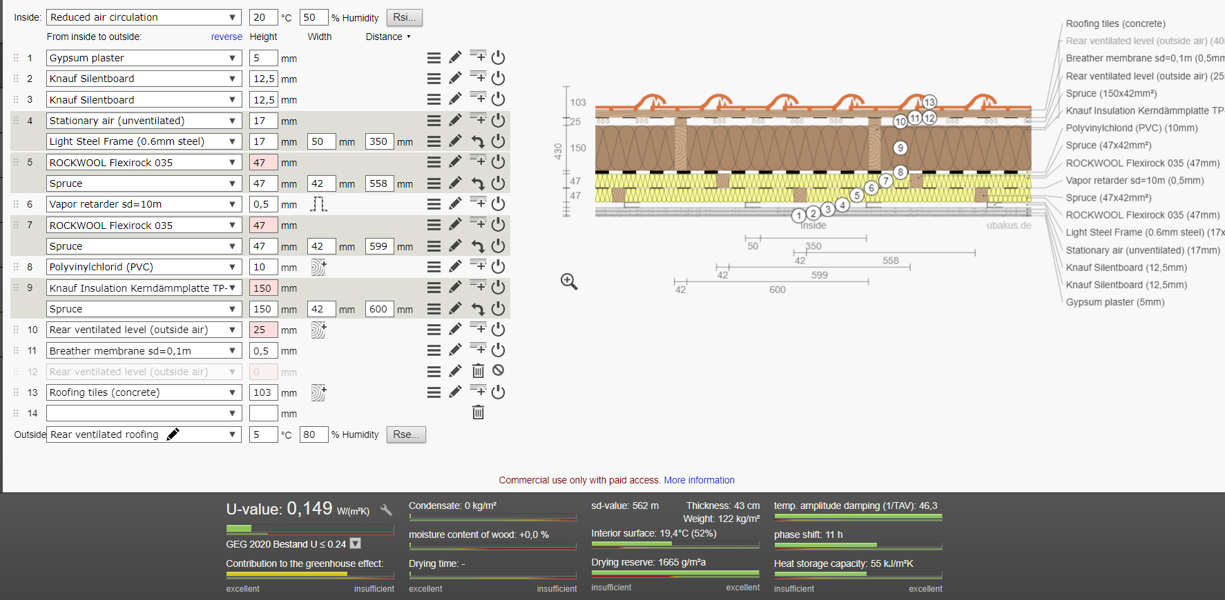

It's 44.5kg/m2 excluding timber and skim and membranes and costs about £55.75/m2.
With the same caveats your previous suggestion comes out at 36.6kg/m2 for a cost of £78.87/m2 for a U value of 0.15 W/mK.
