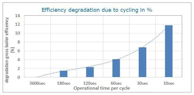

Originaltwist Posted January 19 Share Posted January 19 I suggest you sit by the boiler with a stop watch to see if it's short cycling. My neighbour's oil boiler goes 'whoooof' about every 3 minutes - crazy. 1 Link to comment Share on other sites More sharing options...

John Carroll Posted January 26 Share Posted January 26 Cycling doesn't have a huge effect on efficiency, also you don't see too many complaining about the constant cycling with systems like Evohome which will still cycle a boiler even when the system demand is greater than the minimum (gas) boiler output. 1 Link to comment Share on other sites More sharing options...
ProDave Posted January 26 Share Posted January 26 While the burner of an oil boiler is only on or off, it is controlled by a thermostat that is setting the temperature of the water leaving the boiler. So if all UFH zones are open, the flow temperature will cool down quickly once the burner stops so it won't be long before the burner starts again. But if just one zone is open, the flow temperature declines slowly so it will be much longer before the burner comes on for it's next burts. Hence power delivered and oil usage is directly proportional to the heat delivered. In our old house we used to turn the heating on 2 hours before we normally got up so it was warm by the time we were up, and in the evening it turned off at least an hour before we went to bed. That worked well for us. Link to comment Share on other sites More sharing options...
