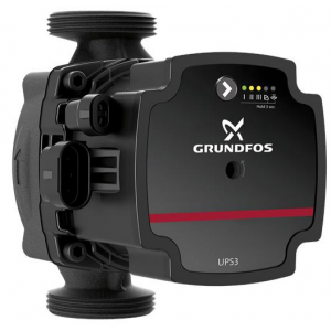

SimonD Posted January 19, 2024 Share Posted January 19, 2024 Assuming that your heatpump is outputting 14kW, if it's at a Delta T of 5C - eg flow 40/35 or flow 45/40 - this should equate to a flow rate of around 40l/min. 30-33l/min equates to an output of 11-12kW at 5C Delta T With regard to your radiators, you need to be more methodical: - let the system go completely cold and then turn the heating on - as it warms up check and make note of the order in which the radiators get warm and then take note of the temperature of each radiator when the system has been running for a good period of time. - To easily see if you can get hot water to the coldest rad, simply turn off the hottest radiators using the TRV only and then see if heat gets pushed to that cold radiator. Link to comment Share on other sites More sharing options...
Helene Posted January 19, 2024 Author Share Posted January 19, 2024 1 hour ago, SimonD said: Assuming that your heatpump is outputting 14kW, if it's at a Delta T of 5C - eg flow 40/35 or flow 45/40 - this should equate to a flow rate of around 40l/min. 30-33l/min equates to an output of 11-12kW at 5C Delta T Thanks so what would be the reason to have a lower flow? wrong balancing? 1 hour ago, SimonD said: With regard to your radiators, you need to be more methodical: - let the system go completely cold and then turn the heating on - as it warms up check and make note of the order in which the radiators get warm and then take note of the temperature of each radiator when the system has been running for a good period of time. The former is hard as it's a big house and I think the circuits splits in various places, and I don't know where... and there are various radiator types... but worth trying again. 1 hour ago, SimonD said: - To easily see if you can get hot water to the coldest rad, simply turn off the hottest radiators using the TRV only and then see if heat gets pushed to that cold radiator. I've done that at the beginning and coldest radiators worked perfectly well - just not when all the rads went back on. Link to comment Share on other sites More sharing options...
Helene Posted January 19, 2024 Author Share Posted January 19, 2024 2 hours ago, PhilT said: yes - my rad and room temps were all over the place to start with, I think partly due to the glycol antifreeze gradually working its way through the system, and partly due to my microbore system, so I deliberately ran it hotter than needed continuously for as long as possible to resolve those issues. If you can't get it to work by running hot continously 24/7 with all rad valves open then (statement of the bleedin' obvious) you have other issues that need an expert inspection. I could give it a shot when temps get higher again... as it would cost a lot at the moment 😬 Link to comment Share on other sites More sharing options...
PhilT Posted January 19, 2024 Share Posted January 19, 2024 47 minutes ago, Helene said: I could give it a shot when temps get higher again... as it would cost a lot at the moment 😬 SimonD suggested a 40l/min flow rate, so 33l/min, although very high compared to mine, may not be enough to shove water all the way around your big house and up into your loft K3! Do you have one or two flow pumps? if you have only one either it's not man enough or it is not set to a high enough speed. If you have two, check the other (secondary flow to rads) pump and increase its speed or, if not already, try setting to maximum speed. This should be quite easy as long as you can get access to both. Usually they have 3 speeds which can be adjusted via a dial or a button which selects 1, 2 or 3 lit LED's. You should be able to hear the speed increase. Link to comment Share on other sites More sharing options...
