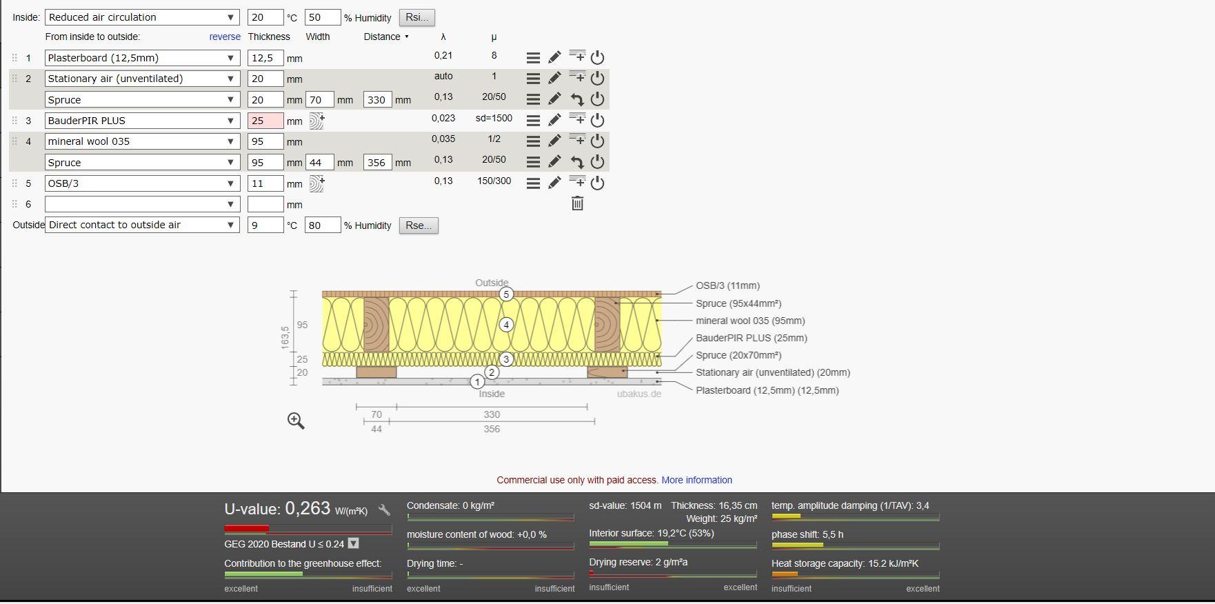

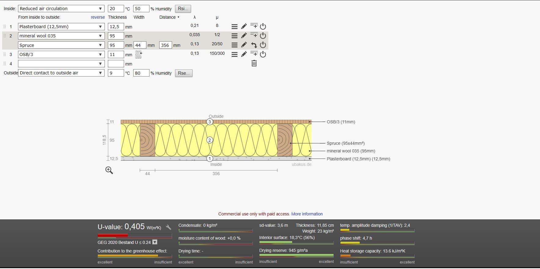

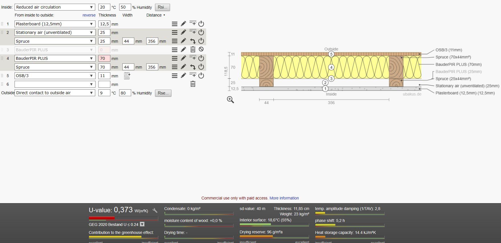

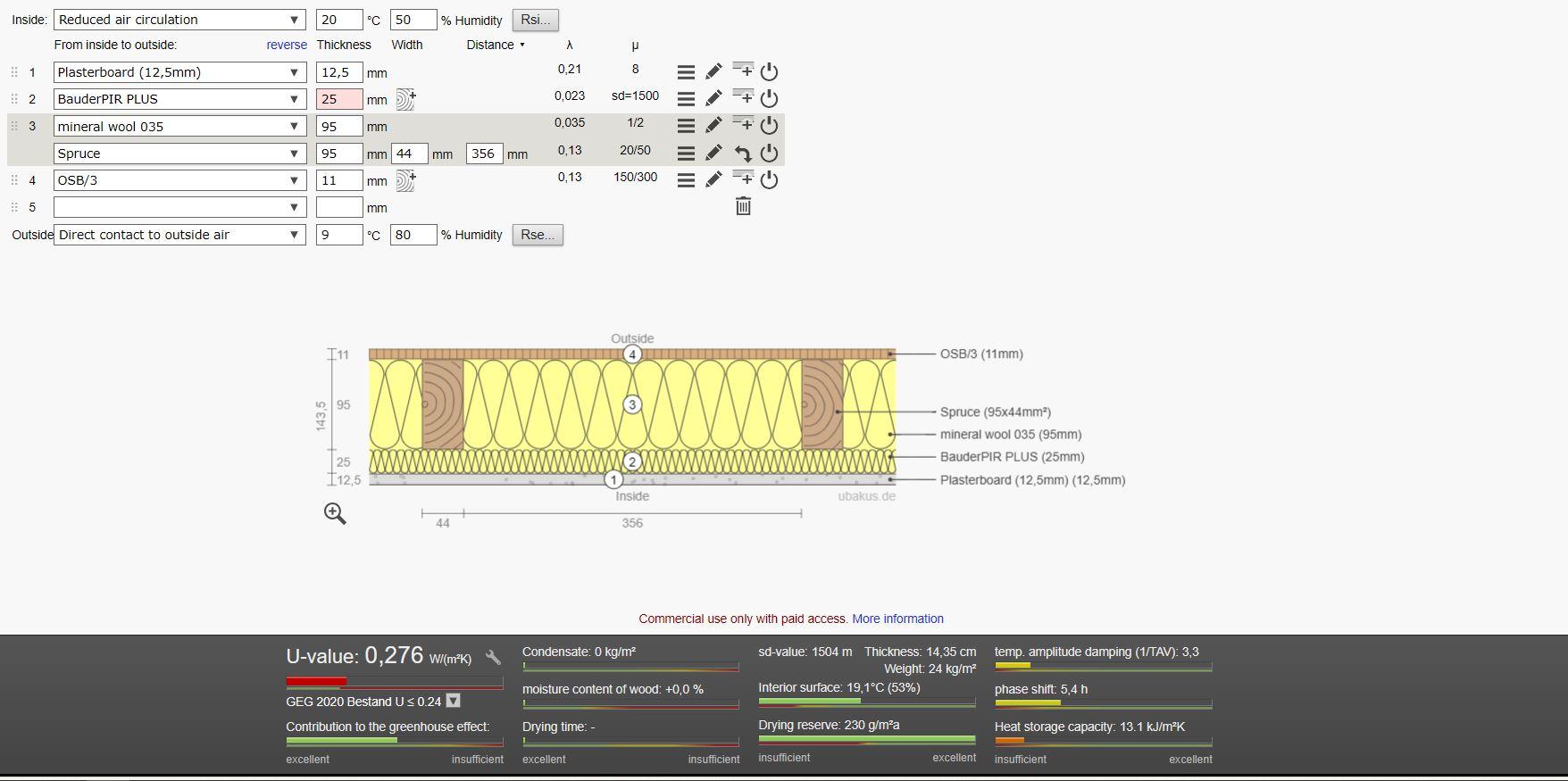

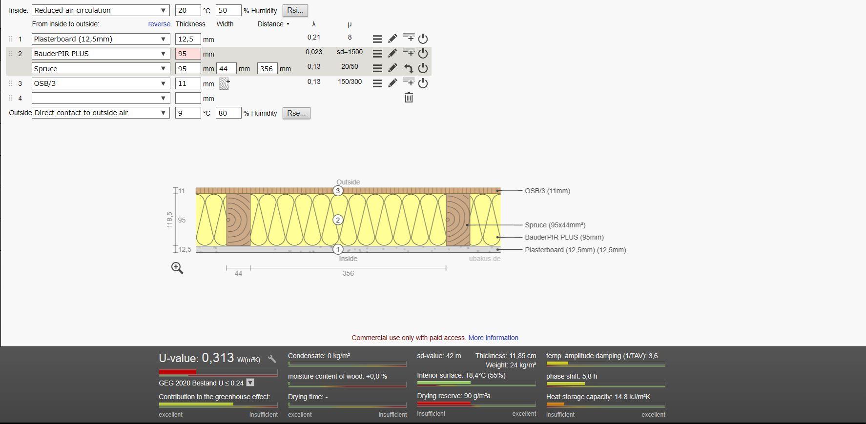

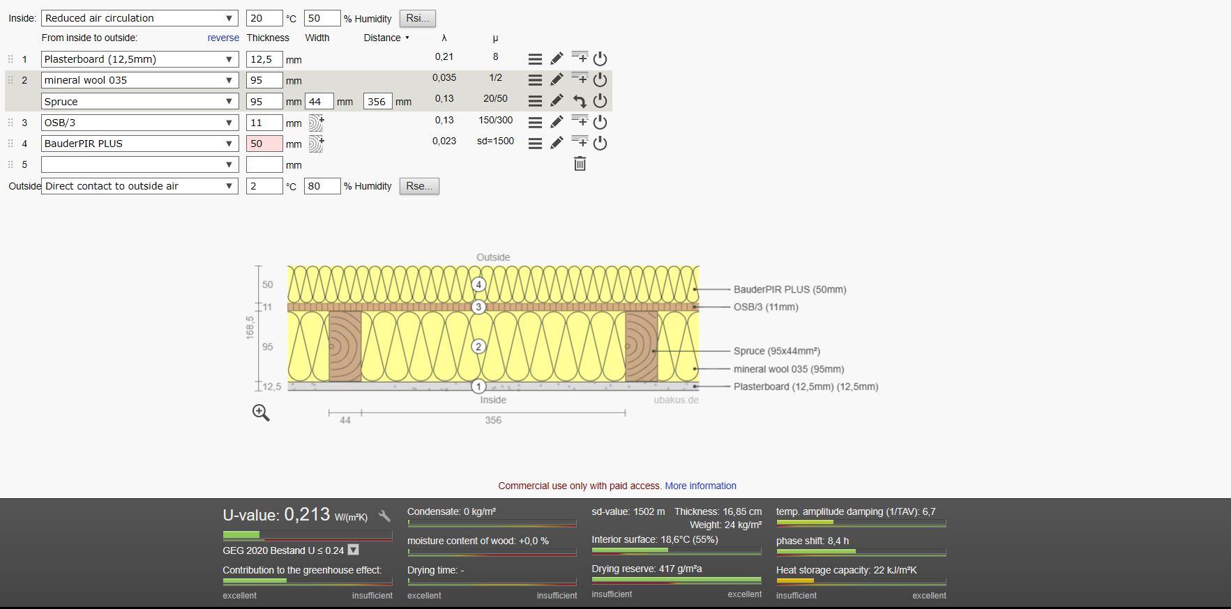

Iceverge Posted January 17, 2024 Posted January 17, 2024 I'll do a mock up shortly. But I would counter the idea that PIR between the studs is the way forward. Too dear, too much waste, to awkward to fit. Timber and PIR will expand and shrink differently and the boards will come loose.
Iceverge Posted January 17, 2024 Posted January 17, 2024 One of the last two options would be my choice. 1
Amelia Winters Posted January 17, 2024 Author Posted January 17, 2024 5 hours ago, Iceverge said: One of the last two options would be my choice. Thanks for all that - makes for some interesting results, some not what I expected but it's all good to know. My choice is probably the latter of them as its the simplest for me to do given how far finished the outside surface is already.
Iceverge Posted January 17, 2024 Posted January 17, 2024 (edited) You could jump to 50mm PIR on the wall without services or whatever you can fit. The 400cc studs really have a hit on the performance of the wall at that thickness, the calculator underestimates the true % of timber too. I would foam the boards and tape them with foil tape. Tape them to the windows, doors, floor and ceiling and you'll have a good airtightness layer too. Edited January 17, 2024 by Iceverge

Iceverge Posted January 18, 2024 Posted January 18, 2024 For my 2p worth I was thinking about 50mm PIR Inboard of the studs with mineral wool in between.
Amelia Winters Posted January 18, 2024 Author Posted January 18, 2024 Do you mean 50mm pir against the osb outer, then mineral wool to fill the rest of the void between pir and plasterboard?
Iceverge Posted January 19, 2024 Posted January 19, 2024 From the inside out. Skim, 20*70mm battens for service cavity. 50mm PIR on top of the studs. Taped and foamed. 44x95mm studs infilled with mineral wool. OSB sheathing. Breather membrane.
