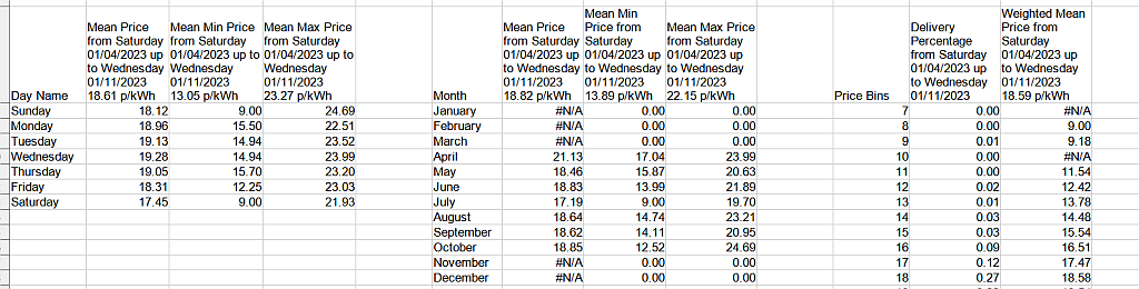

35 minutes ago, SteamyTea said:
2021
2022
2023
So if I'm reading it correctly, you're getting mean summer prices of:
2021- 22.4p
2022- 34.6p
2023- 18.6p
Your 2021/22 numbers match mine, I don't know what I did for the 2023 ones.
I'm going to have to figure out how much of my energy use is DHW, as the off peak E7 rate undercuts these figures.
2023 is much lower, which seems a bit odd, but seems to be right.
I noticed that I did not put the error correction in what I first posted up and have changed the average function to only show relevant months.
Now looks like this for 2023.
This may be easier to read
2021 2022 2023
Month 2021 Mean Price 22.43 p/kWh 2022 Mean Price 34.6 p/kWh 2023 Mean Price 18.82 p/kWh
January
February
March
April 16.61 30.52 21.13
May 17.62 23.97 18.46
June 18.11 28.35 18.83
July 20.03 38.82 17.19
August 21.71 54.89 18.64
September 32.07 42.35 18.62
October 30.86 23.28 18.85
November
December
Edited by SteamyTea
2021 2022 2023
January
February
March
November
December
That's perfect, thanks Steamy.
I wonder what I'm doing wrong.
I can't remember exactly what we were paying in previous years, but looking at the current rate the tracker has to be a good idea. We're currently on about 16/34p E7.
Of course I can't switch tariffs until I get a smart meter. And I'm going to want to install a wifi-enabled timer for the DHW, so that I can boost the tank when the rate is good.
