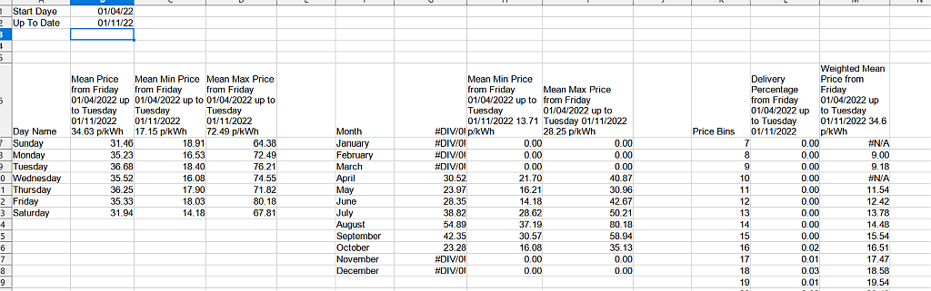

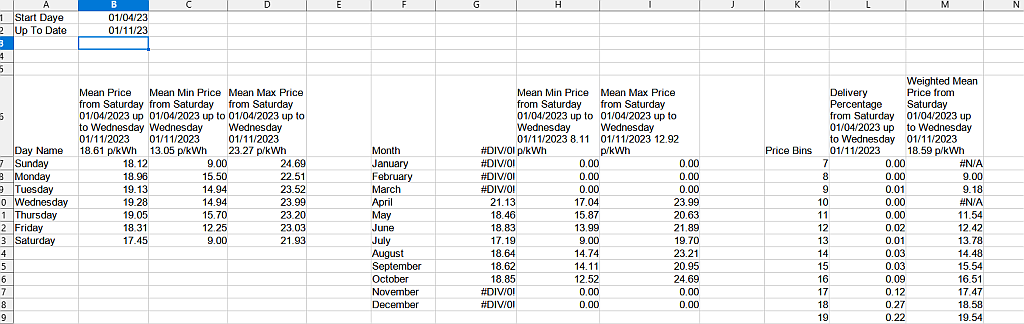

Crofter Posted January 8, 2024 Author Posted January 8, 2024 So I've had a look at the numbers and it doesn't actually look all that great. Our property tends to be occupied from about 1st April to the end of October, and if I average out the tracker rates over those months I get the following: 2021- 22.5p 2022- 34.8p 2023- 27.3p Some more research required but it's maybe not the easy win I was hoping for.

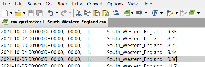

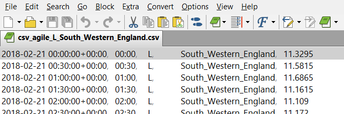

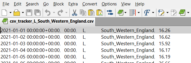

SteamyTea Posted January 9, 2024 Posted January 9, 2024 I had a quick look at that Octopus file list. There are 3 relevant files for my area, one is gas daily price Electric Daily Price And hourly Daily Price They look about right but I may be missing something.
Dillsue Posted January 9, 2024 Posted January 9, 2024 The prices you've highlighted are 2018 and 2021 prices. May not be quite the same as we've got now??
SteamyTea Posted January 9, 2024 Posted January 9, 2024 30 minutes ago, Dillsue said: The prices you've highlighted are 2018 and 2021 prices. May not be quite the same as we've got now?? I just screenshotted the start of the files. I now notice that there is Tracker and Agile in the file names. So is Tracker based on a fixed daily price and Agile the more volatile hourly price? I find Octopus has too many tariffs.
S2D2 Posted January 9, 2024 Posted January 9, 2024 45 minutes ago, SteamyTea said: I just screenshotted the start of the files. I now notice that there is Tracker and Agile in the file names. So is Tracker based on a fixed daily price and Agile the more volatile hourly price? I find Octopus has too many tariffs. Tracker is a daily price. Agile has half-hourly pricing that varies over the day. Both have their rates set the day before or so.
SteamyTea Posted January 9, 2024 Posted January 9, 2024 1 minute ago, S2D2 said: Tracker is a daily price. Agile has half-hourly pricing that varies over the day. Both have their rates set the day before or so. Right. May be worth a little time to look at what is happening and how it could fit in with everyday life. Biggest problem is that if the money that supplier makes goes below their usual tariffs, the tariff gets pulled.

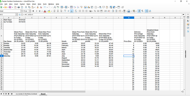

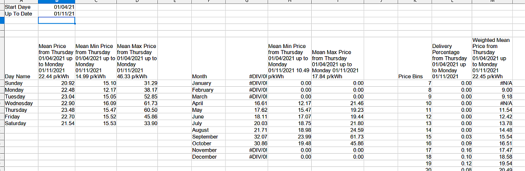

Crofter Posted January 9, 2024 Author Posted January 9, 2024 Does somebody fancy checking my homework? I'm trying to use Excel on a phone and something isn't adding up.
SteamyTea Posted January 9, 2024 Posted January 9, 2024 (edited) 47 minutes ago, Crofter said: Does somebody fancy checking my homework What information are you actually trying to get out? Are you Northern or Southern Scotland? Edited January 9, 2024 by SteamyTea

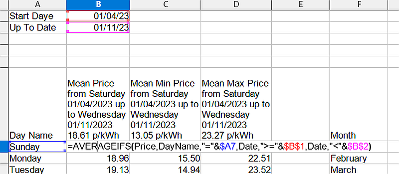

Crofter Posted January 9, 2024 Author Posted January 9, 2024 1 hour ago, SteamyTea said: What information are you actually trying to get out? Are you Northern or Southern Scotland? I'm in the northern Scotland region. What I was trying to do was find the daily average price for the period 1st April to 1st November each year. So I tried SUM(Ex:Ey)/z Where X is r start date, y is the end, and z is the number of days in-between. But there's something weird going because the cell numbers and the number of days aren't matching up.
SteamyTea Posted January 9, 2024 Posted January 9, 2024 (edited) 2021 2022 2023 Edited January 9, 2024 by SteamyTea 1
SteamyTea Posted January 9, 2024 Posted January 9, 2024 (edited) 21 minutes ago, Crofter said: What I was trying to do was find the daily average price for the period 1st April to 1st November each year. So I tried SUM(Ex:Ey)/z I use =AVERAGEIFS(WhatToAverage,SortBy,TheCondition) So in my spreadsheet I use something like =AVERAGEIFS(Price,DayName,"="&$A7,Date,">="&$B$1,Date,"<"&$B$2) Edited January 9, 2024 by SteamyTea
