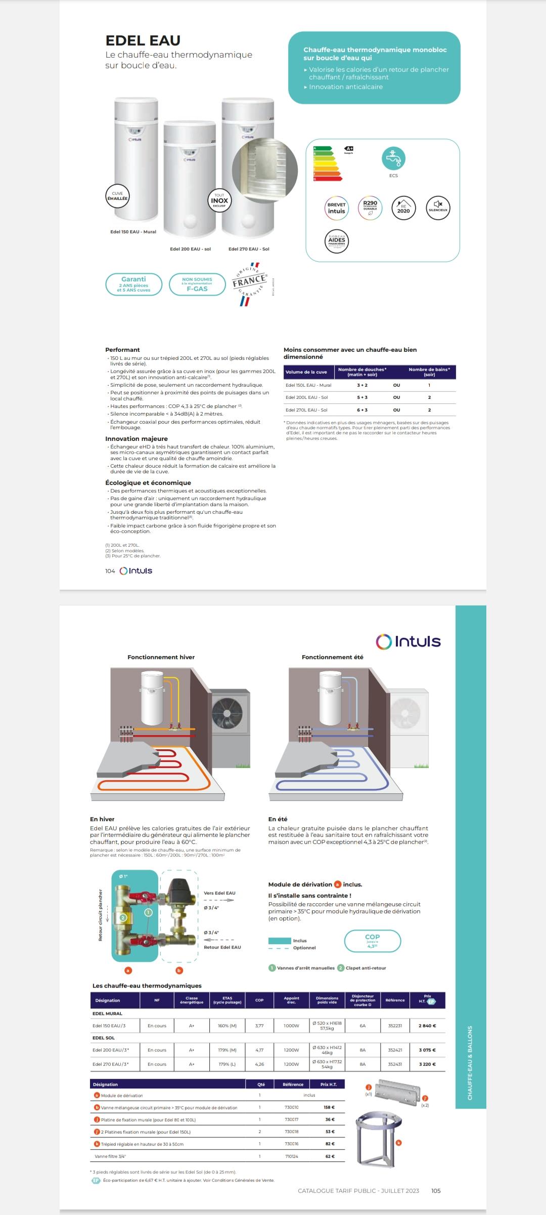

Guest 34 Posted January 4, 2024 Author Posted January 4, 2024 On 04/01/2024 at 20:48, JohnMo said: They exist in the domestic sense also. I did see a link on here for one. Took UFH return water, stripped away some heat, and added the water back into the system via close coupled tees. Think it was a french company making them. It had a CoP of around 4. But all the energy you strip from the water has to be added from elsewhere later. So didn't really see any advantage. Physics doesn't work like this, you don't get anything for nothing. What are you trying to achieve? Expand Yes that's what I'm looking for. The energy will be added by the boiler. Do you happen to remember any keywords (topic, company, product name, etc...?).
JohnMo Posted January 4, 2024 Posted January 4, 2024 Is this what you are looking for? An expensive solution to make hot water. https://warmtepompboilershop.nl/product/auer-edel-eau-200l-warmtepompboiler-2/ Made by AUER France
Guest 34 Posted January 4, 2024 Author Posted January 4, 2024 Hmm almost. It is indeed very expensive considering there won't be much in the way of support in the UK for this product. In the second page, you see two pipes nicking some heat from the return pipe which then gets stepped up and dumped in the water cylinder. This is half of what I hoped might exist. So forget about DHW for now and consider another application for a water-to-water HP. Just erase the cylinder in that picture and replace it with two more pipes. Those pipes would be hotter than the flow provided by the outside HP. In my case, I have two UFH manifolds but one needs a higher flow temperature than the other. I know I can get an electronic valve mixer for the UFH that needs a lower flow temp and set a higher heating curve on the boiler so that the other UFH zone gets hotter. No luck finding anyone that would do this in my area though which is why I'm just day-dreaming on an internet forum before bedtime 😅. If I could get a heat pump to boost the flow temperature, on just the one manifold that needs it, I could keep my boiler's heating curve low AND increase condensation efficiency (by making the return colder, without increasing the flow temp). So yes, I'd use more electricity and gas, but it still might be more efficient than just increasing the flow temp and having one zone constantly overshoot. Thanks for digging that up though. Seems like a great product, shame about the price.
