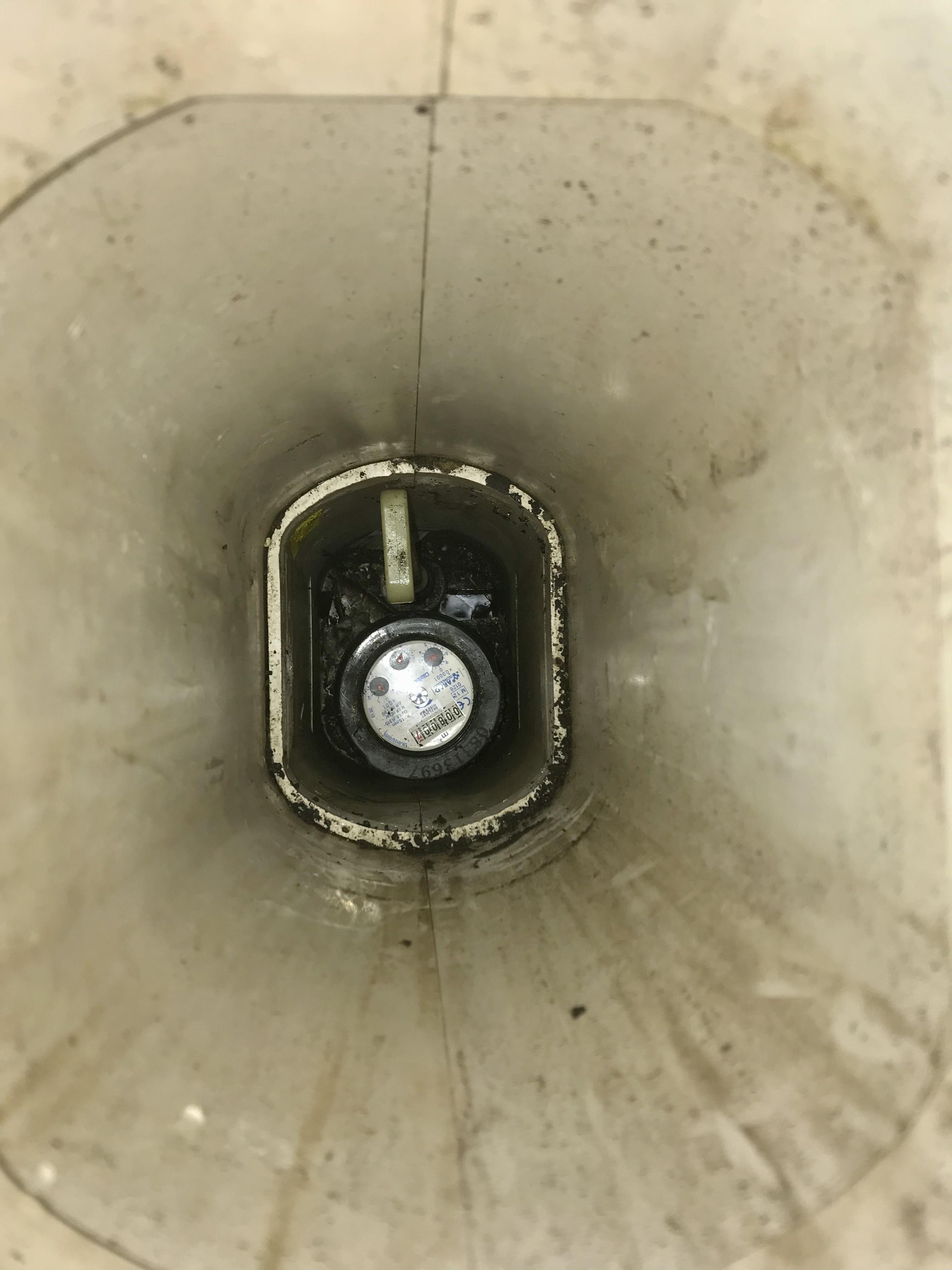

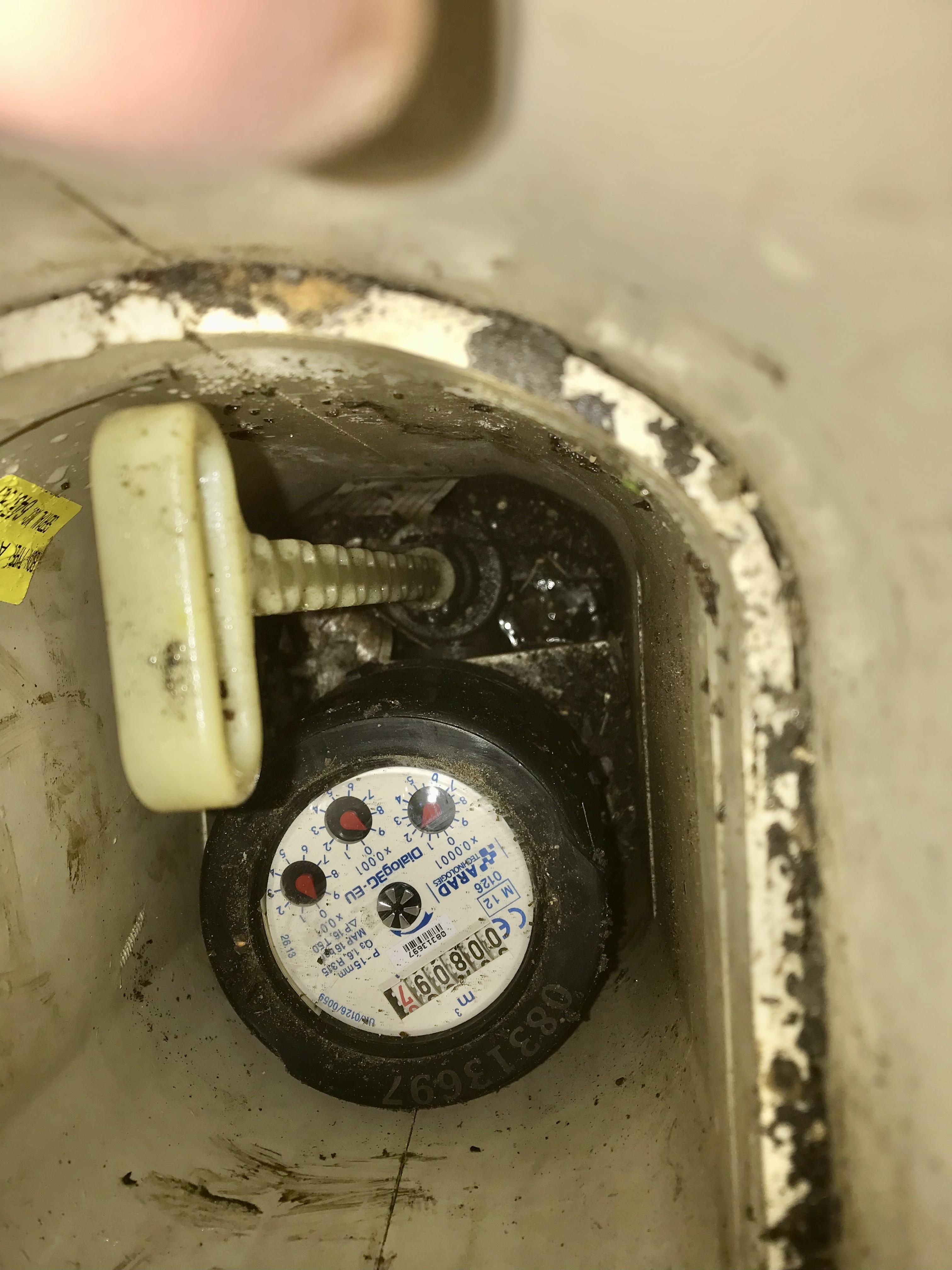

Del-inquent Posted January 3, 2024 Posted January 3, 2024 I’m trying to find my mains pipe at the point it exits the stopcock in the road. Closest I can dig a trench is 18 inches away, so I stupidly assumed it would be a 5 minute job… looking at these photos of the stopcock in the pavement, what direction would you expect the mains pipe to run? I’ve dug a 5ft long trench to the depth as the stopcock plus a bit… no joy. Would it be likely to do a 90 deg turn or anything immediately outside the box?!

Mr Punter Posted January 5, 2024 Posted January 5, 2024 The water pipe should be 750mm deep. The route is normally a fairly straight line from the point of entry to your house via the meter to the connection in the road. 2
saveasteading Posted January 5, 2024 Posted January 5, 2024 @Mr Punteris correct. Unless there is any obvious reason for a detour, such as a tree, rockery etc it will be the easiest route. Either 90° to the road or the shortest route to your internal stopcock. What depth is the inside of the meter box? Dig that deep and a bit. Carefully. 1
Conor Posted January 5, 2024 Posted January 5, 2024 (edited) I've seen 1000s of meter box installs. 90% of the time it'll run straight. The other 10% could be anywhere. First, is the outlet side of the box pointing towards your property? I.e. in your photo the customer side will be at the bottom of your photo, the meter side. The valve side is the incoming mains. Sometimes they are installed at 180⁰ if the supplying main is close to the property and they need to loop the pipe back to avoid the main or other services. Post a photo of the surrounding area, camera facing your property. Also, are you sure that's your meter? Edited January 5, 2024 by Conor 1

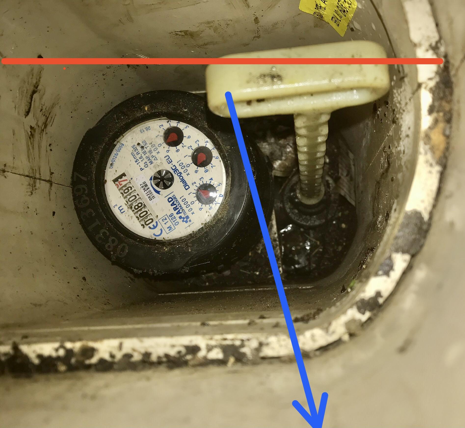

Del-inquent Posted January 5, 2024 Author Posted January 5, 2024 35 minutes ago, Conor said: I've seen 1000s of meter box installs. 90% of the time it'll run straight. The other 10% could be anywhere. First, is the outlet side of the box pointing towards your property? I.e. in your photo the customer side will be at the bottom of your photo, the meter side. The valve side is the incoming mains. Sometimes they are installed at 180⁰ if the supplying main is close to the property and they need to loop the pipe back to avoid the main or other services. Post a photo of the surrounding area, camera facing your property. Also, are you sure that's your meter? Definitely my meter, the stopcock turns off our property anyway 😂 I’ll try and get a photo when it’s not torrential rain, in the meantime, the red line is the road direction, the blue arrow points to the house.
Conor Posted January 5, 2024 Posted January 5, 2024 Ok, the. The pipe will be coming out to the RHS, bending round before going in to you pretty. At a guess, 1-2m to RHS of the box. Bend radius on a 25mm MDPE is pretty big. 1
