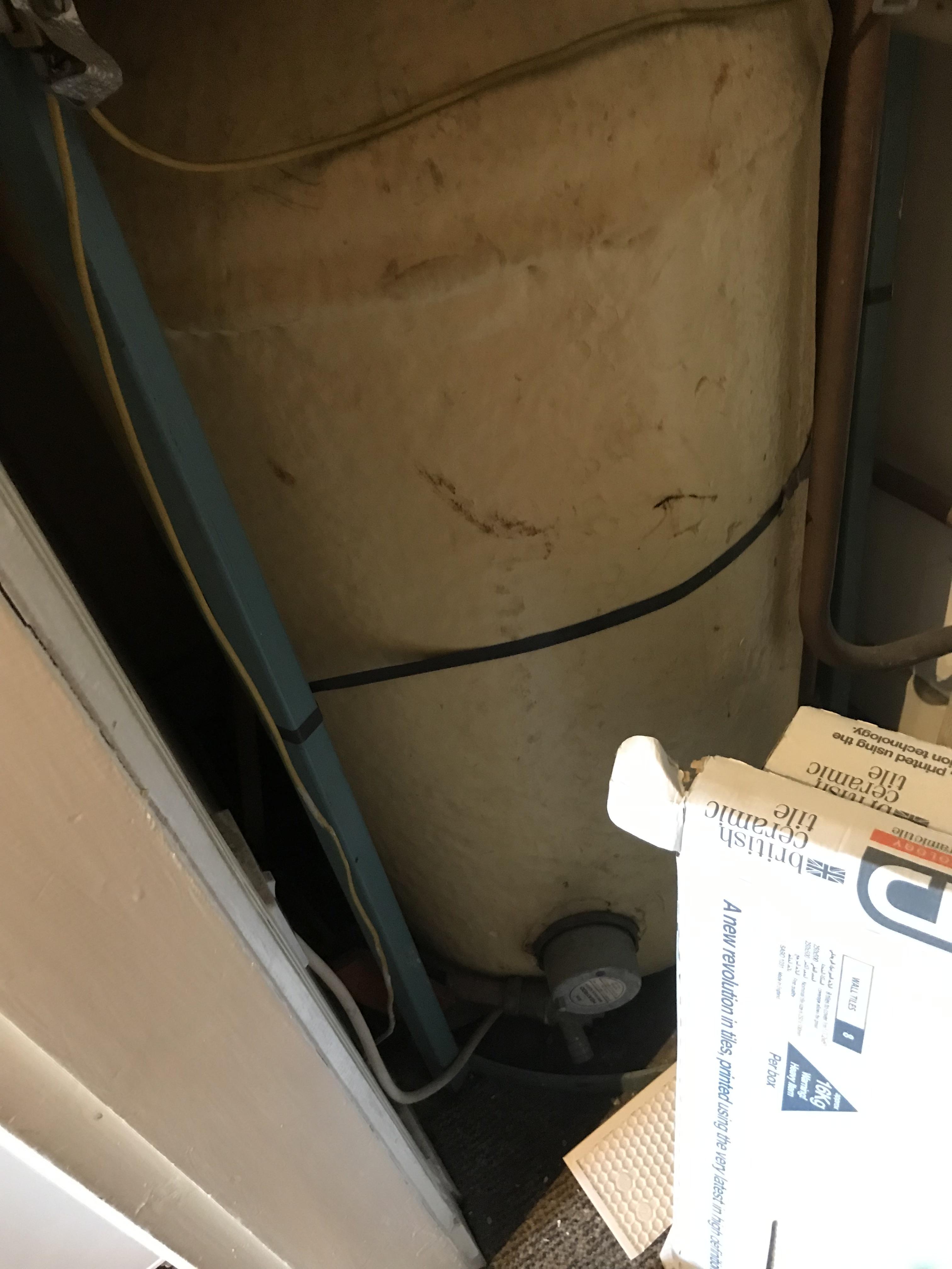

mossy Posted December 31, 2023 Share Posted December 31, 2023 Hi we have a second floor small flat which we rent. It has one shower (electric), no bath and a basin in the bathroom and kitchen. So the demand for HW is minimal. At the moment the HW is a direct (no gas) vented tank (photo attached) above which sits a large header tank on a metal frame. The water flow is pitiful and the system takes up a lot of cupboard space. I am familiar with non vented tanks and have one in our own house. However Im not sure about one in the flat because of managing the Tundish and the only option would be to plumb it into the communal soil stack. However some say NO NO and other say perhaps depending on the plastic of the soil stack. I can't find an EN number on it so polyethylene or polypropylene ?? Would another option be an instant hot water system fed by mains pressure cold water ?? Mossy Link to comment Share on other sites More sharing options...

mossy Posted January 6, 2024 Author Share Posted January 6, 2024 Thanks everyone. I am the landlord. There is nothing wrong with the shower it’s electric and works fine. Im trying to get rid of the large header tanks which feeds the HW cylinder and supplies two basins. One option I think is to fit a non vented tank ? This would get rid of the header tank and supply HW at mains pressure ? There is nothing wrong with the shower Link to comment Share on other sites More sharing options...
JohnMo Posted January 6, 2024 Share Posted January 6, 2024 Have a look at Harlequin cylinders. They have a mains pressure coil, so supply water at main pressure. Do not need an overhead tank or any overflows. Or UVC, you need access to drain point for its safety devices. Or local hot water on demand cylinder in sink and at basin. Or something like https://www.cylinders2go.co.uk/shop/uncategorised/comet-by-telford-10-litre-stainless-steel-1-5kw-undersink-heater/ Link to comment Share on other sites More sharing options...
